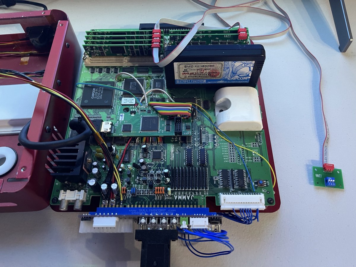

@Epyc you got pics of the motherboard? Was/Is there a battery under the white cover?
No battery. As of right now, these are the only ones I can find.

For those of you who want to try this at home, and for the EE's in the house who want to tell me I did something wrong, the 5v reset signal comes from this capcom custom and finds its way to pin 40 of the scsi chip. With a 20 ohm resistor I can sink that to .2v which is well within the LOW range of TTL, so that holds this chip in reset. After testing with Red Earth and some other games I think this is a viable solution and easier for most people to do than remove the chip entirely. I do think that would work too! I also tried several resistor values before I found 20 ohm (500, 100) because I wasn't sure how much current was coming in, but at this level I think it's also probably safe to just jump these pins directly together if you don't have a resistor. So if you want to do this, you need to tie pins 40 (reset) and 39 (gnd) together with a jumper or a 20 ohm or less resistor.
