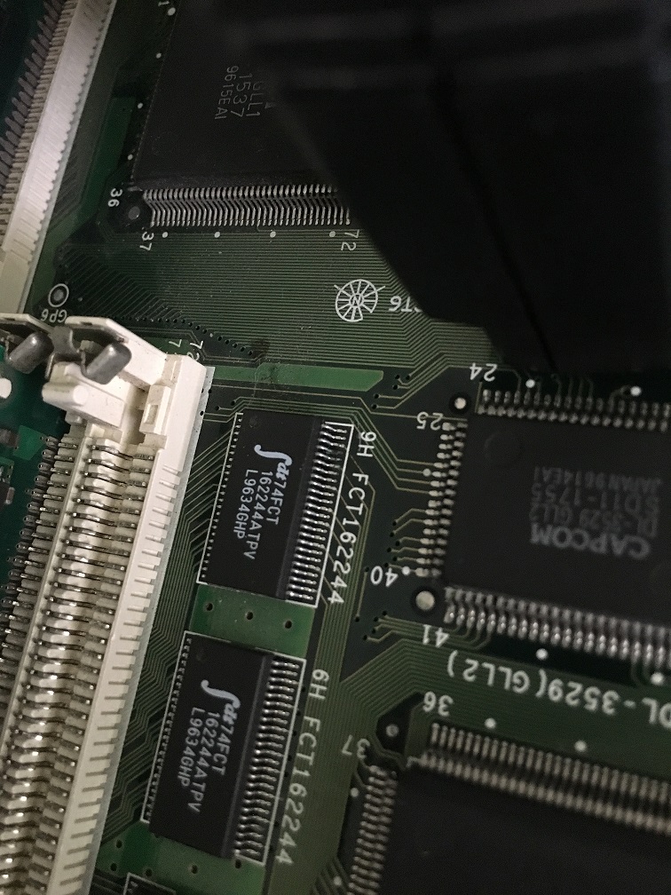

I also noticed this when I was having a look at the motherboard. When I queried MAME it turns out that these 3 162244 ICs work in tandem with a custom as controllers for the SIMMS (according to the MAME driver) and when I put a multimeter onto this IC these pins are in fact connected to the 2 main program SIMMS. I've cleaned them up as best I can and trying another reload - I don't think it's a coincidence I'm having issues with these SIMMS and that this controller IC has corroded pins.
I'm guessing this is like a souped up version of an LS244?
