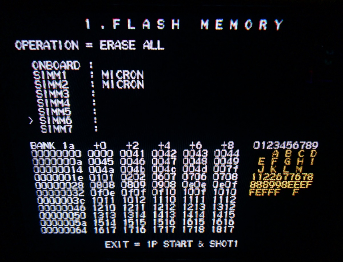

I packed away the OG Simms. What I did was put 1 Simm at a time on the board and it would show the name but when I fill the Simms properly altogether they don't show up it looks like photo on first page. Sorry for confusion.
OK, so if it fails with original SIMMS, then the problem is either with simm slot or buffers. Check those or have someone checking them.
Xodara flashed the cart to Ultra Bios now the Micron Simms (first two) show up others do not.
As you all said it's most likely the buffers, slot, or other.
When Xodara has more free time I'll drop off the CPS3 board to him.
Thank you everyone for amazing help wait and see what happens next.
