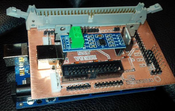

Introducing the MEGA JVS PCB, now with 2 sides!
This design is specific to the Arduino MEGA 2560 as the DUE's analog inputs are apparently not 5V tolerant. I'll have to redesign a little once I get the DUE figured out and working on a breadboard.

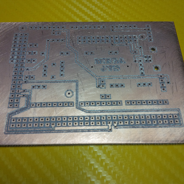

The other issue is that for years now I've been torturing myself on soldering projects by using an iron with the most gigantic tip ever. It never occurs to me to order an iron more appropriate for precision work. In fact, I know I've got a couple smaller tipped irons around somewhere, but can't ever find them.
So those smaller tipped irons I knew I had? They've been sitting on a shelf like 3 feet away from where I sit when I solder... X/
I do very much need to invest in a better setup, though.
For your prototype, just make a PCB relatively larger than what you are planning. Kinda like those fat button phones for older people. :)
In anticipation of potential issues with double sided soldering, I incorporated some poor man's vias so that all traces on the top of the PCB have continuity to pads on the bottom. This is to eliminate the concern that a pin connected to a top trace doesn't make good contact with the top pad. Now I can focus all my attention to soldering header pins into the bottom pads.
What I'm using as vias are clipped header pins. There's a hole from the top trace to the bottom trace, so the pin goes through, gets clipped flush on both sides and gets soldered on both sides.
In a commercially manufactured PCB, the through holes would have continuity from a top pad to the bottom, but not so in these home milled PCBs.
Ok, so a smaller tipped soldering iron is obviously the way to go for assembling these PCBs. However I was hoping to get away with just milling out the traces and not clearing out the excess copper, but an unexpected and frustrating thing is that I have to nearly constantly chase down short circuits to the the excess copper. Not from sloppy soldering, mind you, but because there are tiny copper burrs along a lot of the traces that I guess are getting moved around during assembly and bridging gaps... I've attempted to minimize the burrs by lightly sanding the boards after milling, but I guess some microscopic burrs still potentially remain recessed within the gaps.
I've been having worse results trying to clear out the excess during milling, mostly because of the way the CNC software I'm using using handles it, which is to treat it like an engraving task and mill all the way to where it's on the line rather than milling to the edge of the line, with no options that I can see to change that. This causes the pads and traces to all be much smaller and thinner. Whereas when I mill out just the outlines, I can do that as a profile milling operation and tell it to mill outside the line, leaving the traces to be mostly the width they're supposed to be. Not to mention clearing out all the excess takes forever (30-45 minutes) compared to just doing the outlines (10-15 minutes). I'm considering attempting a method where I do the initial outline and then have another outline that's slightly larger, giving me more clearance between traces and hopefully have the best of both worlds in terms of milling speed and short-circuit avoidance.
Some of this likely comes down to the tool-chain I'm married to at this point. I have my current method down pretty well, and don't want to experiment with other software at the moment. My end goal is just to mill out prototypes, which I'm doing successfully. I'm not planning to mass produce PCBs on my CNC machine, so I don't necessarily need to invest more time in figuring out other software.
