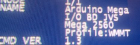

I am able to display the current profile name in the JVS menu.
At least on Chihiro the I/O is reinitialized when cycling between test menu and game, at which point this name in the JVS menu is updated. I'll experiment with pushing out a new name on the fly, but my guess is that the mainboard won't accept it if it didn't send a command for it.
:thumbsup: :thumbsup:
Everytime you enter the JVS Test Menu it should initialize it.

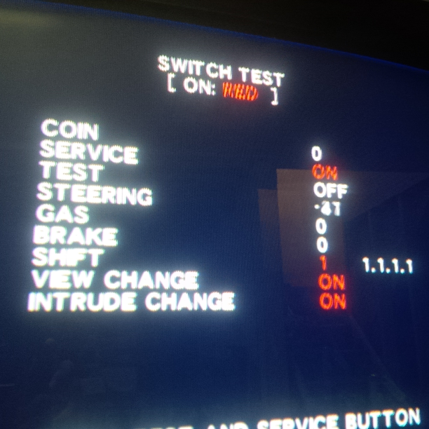

Interesting... I'm trying to map out controls for WMMT on Chihiro. I can find all the inputs for the 6-way shifter, but am not seeing anything happening for Intrude Change and View Change within P1 or P2 start, service, 4 joy-stick directions or buttons 1-7... Where could these inputs be? P1 and 2 button 8 is all I can figure and as I'm not reporting those.
I'll have to dig into it more when I get a chance.
Well I'm not sure anymore. I tried button 8 for P1 and 2, and no go. The only other test I can think of is if the Namco I/O is reporting 16 bits per player and there's a button 9 or 10. Or maybe there's some weird dip switch setting that puts it into 4 player mode and these buttons are on P3 or 4. ?(
OK, so the switches I'm looking for are effectively player 1 buttons 9 and 10! I'm sending 16 bits per player anyway, just generally reporting switches past 7 as off.
Thanks for being an oddball, Namco! Now I have to change up my code.
At least they didn't make it so their game refuses to boot with an I/O that claims a lower bits per player than is needed, unlike OR2 which won't boot if your I/O doesn't meet exact specs.
Anyway, playing WMMT on a Sega Type 1 I/O means you'll never be able to access these buttons. Custom I/O for the win!

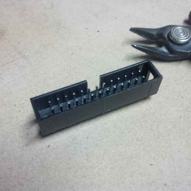

I've been struggling getting the connectors seated on my I/O board in the dark behind my cabinet.
No more! I'm kicking it up a notch with appropriate headers.
I received my order of 26 pin headers today. They're not the locking type, but hold in the connector well anyway. I actually found a small cheap lot of locking 60 pin headers on ebay and have those on the way to me. The locking ones are pretty expensive at places like Digikey, and probably not entirely nessary.
They're not normal ribbon headers they're JST RA headers. normal pin headers will "fit" but the RA pins are a little thinner on one side (they're rectangular)... the reason they're locking is that there is nearly no insertion force.
I see what you're saying. I compared to them to the Type 1 I/O I have out on a table. With these pins being fatter in combination with the shroud, it's holding the connector in well enough for my purposes. They'll be a big upgrade from what I had going on.
I'm pretty sure the 60 pin headers I have on order aren't JST either. Hopefully they work similarly.
