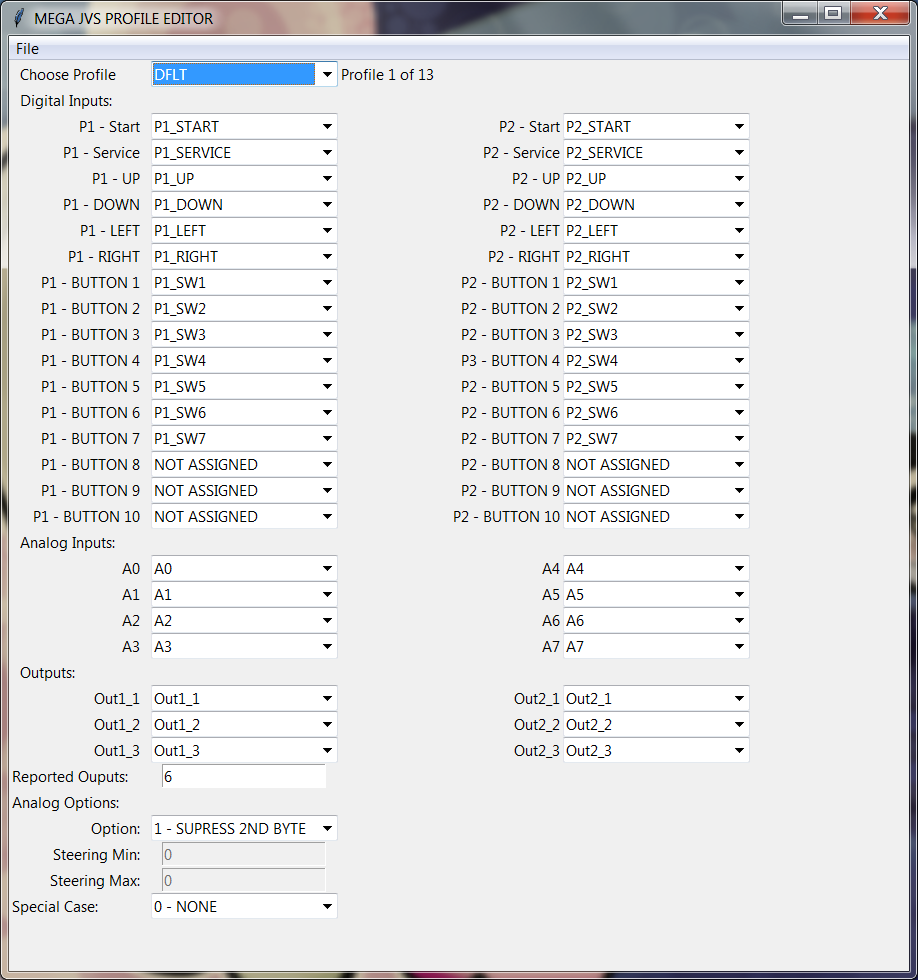

I don't have anything to record at the moment, but here's a work in progress screenshot of the profile GUI:
So far I've got it to where it can successfully read in profiles, populate drop-down boxes with valid values, and populate entries with the current values read from the profile.
What I still need to do is manage saving changes and overall profile management such as being able to manually sort them in a list and add new profiles.

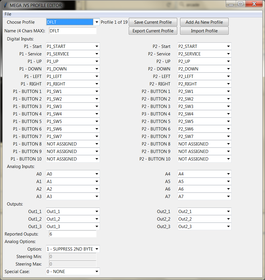

I'm also trying to think of a better way other than manual entry to manage steering wheel scaling values. At the moment it would require entering a min and max value without any reference to what the actual min and max are.
So far so good with the profile editor.
I now have a separate screen that's an overall profile manager where the list of profiles is displayed. From here a profile can be moved up or down in the list or deleted.
All of that seems to be working well.
None of it looks as nice as I would ultimately have preferred, but the "native" python GUI manager tkinter isn't that intuitive for me, so I'm glad to have gotten it to where it's at least functional. I went ahead and settled on tkinter as it's supposed to come pre-installed with python so hopefully that makes it easier for others to get up and going. Install python3 and this profile application *should* just work.
Simply due to the fact that the last used profile on the MEGA JVS is currently stored in a byte, the max supported number of profiles is 255. If you need anywhere near that many, I feel sorry for you, because you'll be hitting the profile button to change profiles one by one. I may eventually build in some better profile navigation utilizing cabinet controls, but for now that's what it's going to be. At any rate, I built out a file with 255 profiles and successfully navigated and loaded up the last one on the MEGA JVS, so that's working fine.
I'm still contemplating how I want to handle the wheel scaling in the profile editor... I'm thinking I'll have a separate config file for the editor where you'll enter your wheel's actual min and max so that the values can be used as starting point for changes.
