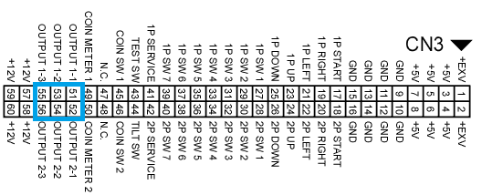

Here is a pinout with the outputs highlighted. The start lamp is wired to pin 51 - Output 1-1.
I can probably pretty safely assume that output 1-1 would be the first to be addressed in the data bits. Since we're dealing with only 6 output slots, all of them can be driven within a single byte.
The ON state for the start button is:
(0x80) or 10000000
The OFF state is:
(0x00) or 00000000
So it appears that the left-most bit is dedicated to output 1-1. I can only make assumptions for the rest of them at this point. I don't know if the next one is 2-1 per the pin number order or 1-2 per the player number and order.
In my OR2SP cab, the view change lamp is wired to pin 54 (2-2), so I'll boot that up when I get a chance and try to figure out the order.

So the left most bit is the start button at the first pin on the connector. The view change lamp is the 5th bit from the right. It appears to be following the player order per the pinout lables and not the pin order.
So I believe these are the bits, starting from the left, that correspond to each output on the Type 1:
Bit 1: Output 1-1 - Pin 51
Bit 2: Output 1-2 - Pin 53
Bit 3: Output 1-3 - Pin 55
Bit 4: Output 2-1 - Pin 52
Bit 5: Output 2-2 - Pin 54
Bit 6: Output 2-3 - Pin 56
In the event that both lamps are on, the command is:
0x32: 0x1: 0x88
So, using that information, I can now reference wiring diagrams and get an idea for the various lamps in a given game and reroute them to my cabinet's lamps as part of my per game configuration.
