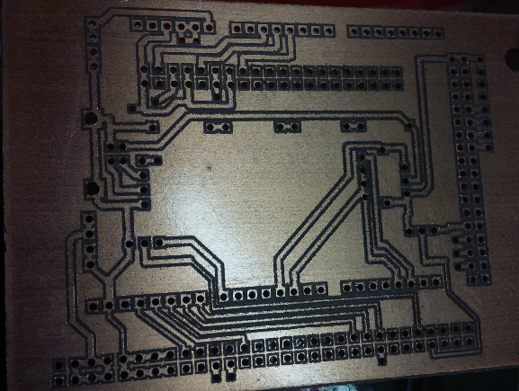

Here's my latest PCB design:
I'm still doing single sided to keep the CNC milling easier. Through better planning of which input on the Arduino goes to which input on the 60 pin header, I got it down to only 5 manually routed wires. I'm still just designing the board for OR2SP cabinet wiring because wiring every other potential input pin is going to over-complicate the PCB at this point and make a single sided PCB infeasible. Once the theory is proven on a custom PCB, it would just be a matter of enhancing the design to accommodate all potential inputs/outputs.
At the moment, I'm forgoing reverse voltage protection because I don't have any P-Channel MOSFETS on hand. I'll just be careful that the power connector is plugged in correctly. The other thing I realized was that the I/O board IS responsible for supplying 5v to some components from its 5v pins at the 60-pin connector. Rather than potentially overloading the Arduino's onboard regulator with whatever 5v peripherals are wired up, I've opted instead to take the 5v input connector from the original I/O and route it to the 5v pins at the 60 pin header. I haven't confirmed, but I suspect the 5v wires I'm seeing at the lamps are originating at the 5v pins on the I/O, so essentially that would mean the board is responsible for supplying 5v to the lamps, just not quite the way I was originally expecting.

I'm getting better at cutting PCBs. I seem to be cursed by never having the correct sized drill bit. I thought for sure I needed .8mm, but that's apparently a little too small for my header pins. I've got .85 bits on order. For now I'm going with holes that are a little too big, leaving with with a smaller surface area for solder than I'd like. This should do for now, though. I'll put it together and test when I get a chance.
Nice! What are you using to create your PCBs?
