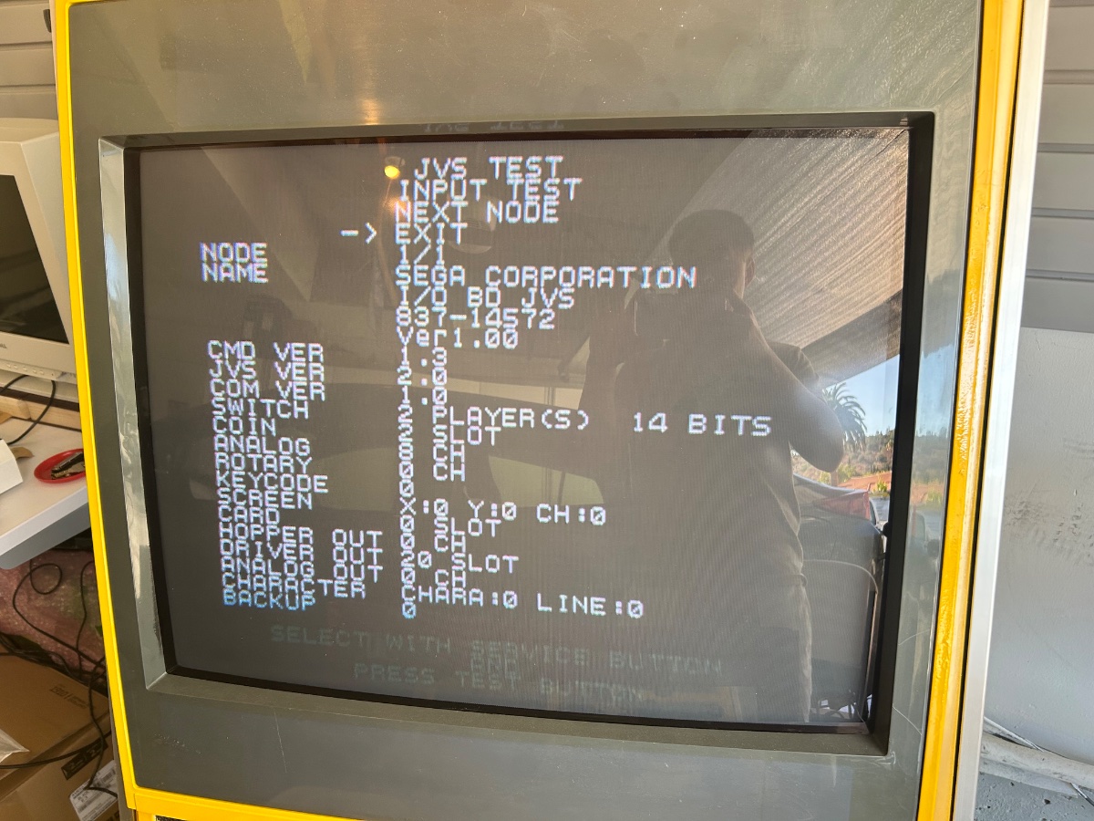

Please supply a picture of the JVS test setup screen on cabinets which do not work as @MetalliC suggested.
This is the current IO I am running. I lent my other one out to Keiichi
