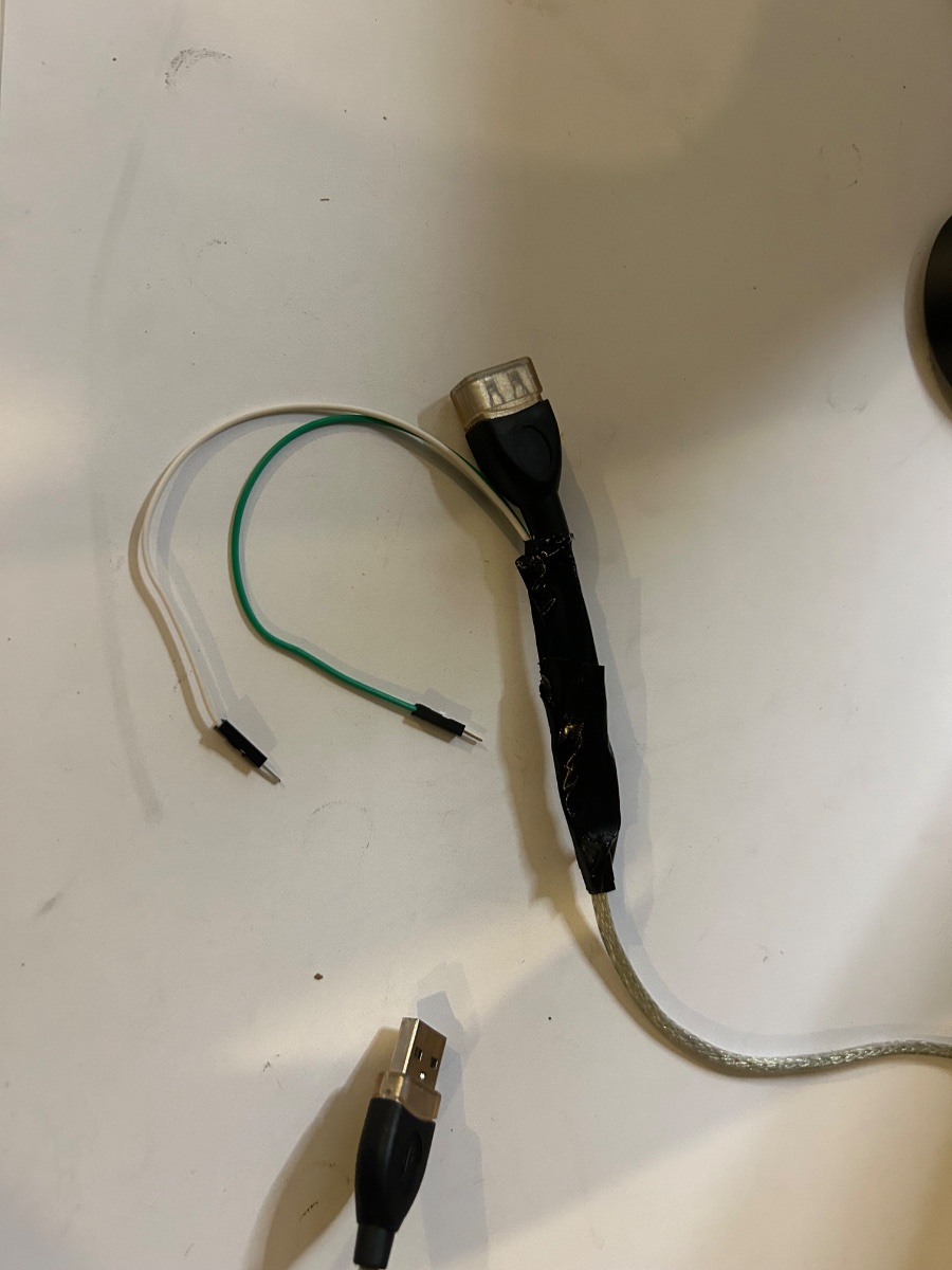

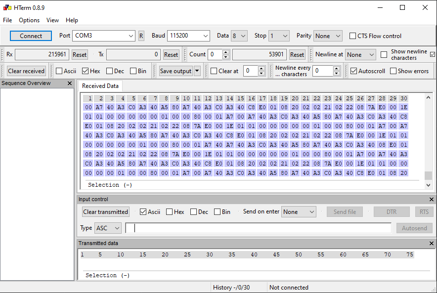

Okay time to try
Are you able to replicate the issue @nem on your setup ?
Yes, here:
  • Like
Reactions: rtw
I think it is reading correctly. Next time it freezes, I'll connect it again to see if I get any signals.
Nice now we are getting somewhere, just leave it connected and watch the data fly by. It has no impact since it's just a tap.

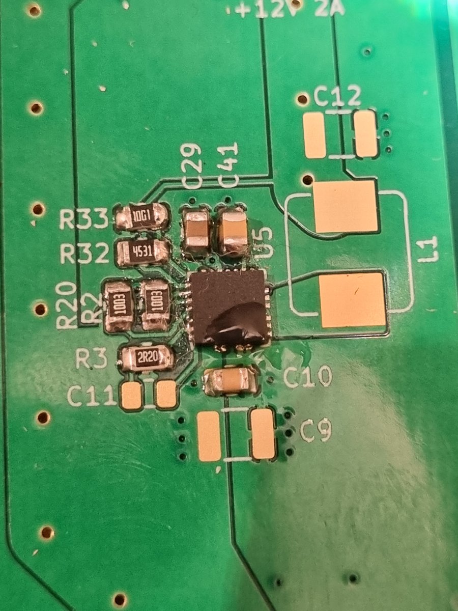

@Big_P Big_p which 3V3 regulator are you referring to ? Got a picture ?
The TD-IO has a built-in sic437a to provide 3.3v at 7A from the JAMMA edge. It's a bit like the Capcom I/O except it can run a netboot setup (if heatsinked)
Apologies for the bad picture with flux everywhere I am not at home and was taking that for another reason altogether, the SIC437A is the big black thing with flux all over it.
