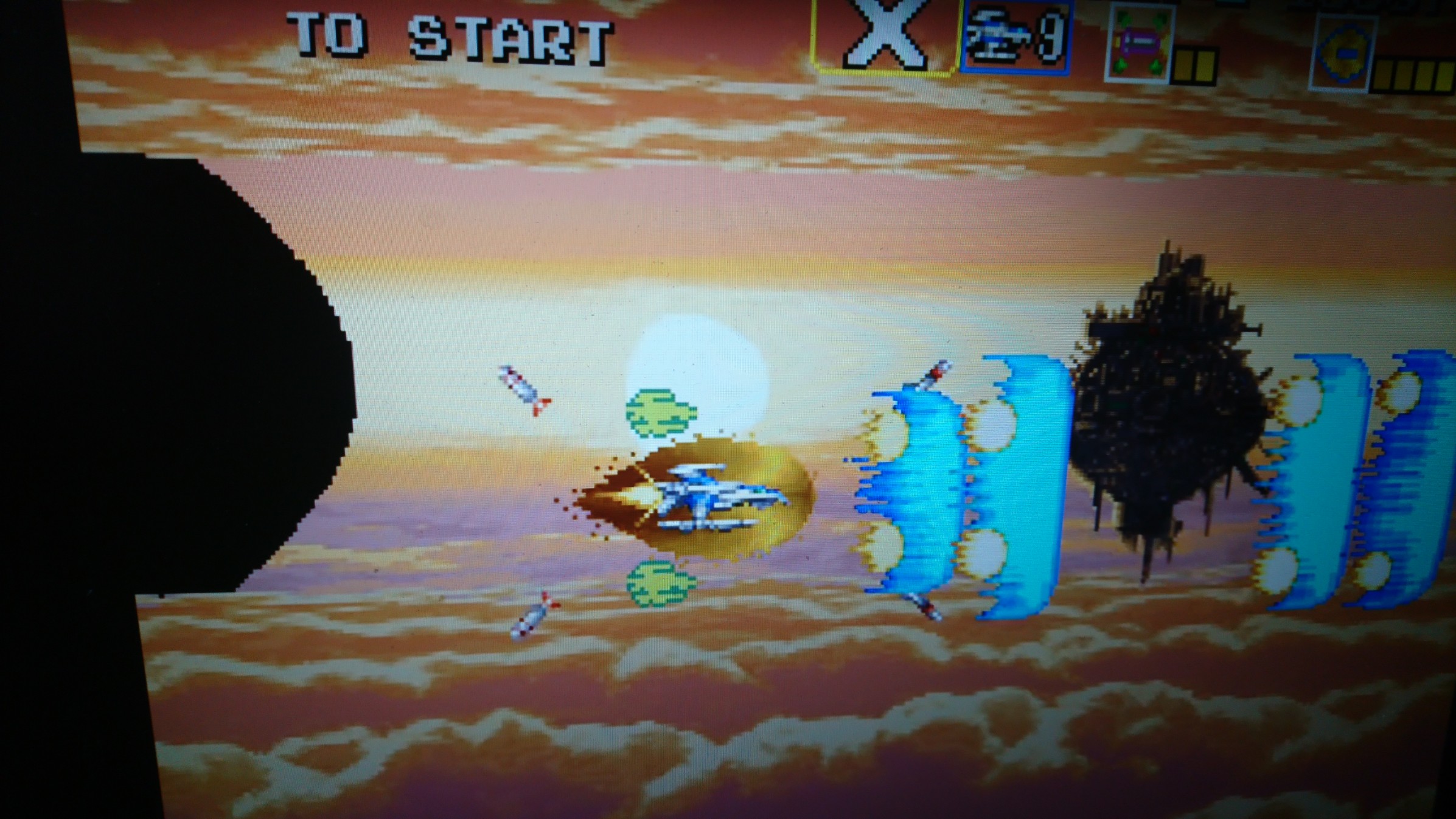

The screen looks strange in zone X.
The way the stages are connected is different, so it may be a mistake in initialization.
There was no problem with the normal mode.

strange this "dark moon" on the left at the start of zone X.
could it be the "line by line zoom effect" from the F3 hardware who lacks some background there ?

This must be something intrinsic to the Extra version, I didn't touch anything related to that, only to the background priority.
The same for that "dark moon" on the left at the start of zone X. It's there in the game.

i follow your idea, i think taito had not so much time to "rearange" the "fluidity" in the extra version between stages and "how they follow smoothly" so the "dark moon" on the left on the stage X in extra version doesn't shock me, i accept it as an "easter egg". <3 (we keep it !)

i encounter a graphic glitch like TMF68k.
see pic below. it occurs in level X but only in the "28 levels marathon mode" on player 2 side.
the background is distorded. it supposed to be displayed / rendered in a rectangle ,between top and bottom clouds foreground, but the F3 render's it as a parallelogram
-the sun in not spherical (see the red circle)
-the "black moon" spotted before is just the render with backround missing . here on my hardware, it's 2 triangles , one left ,one right.
