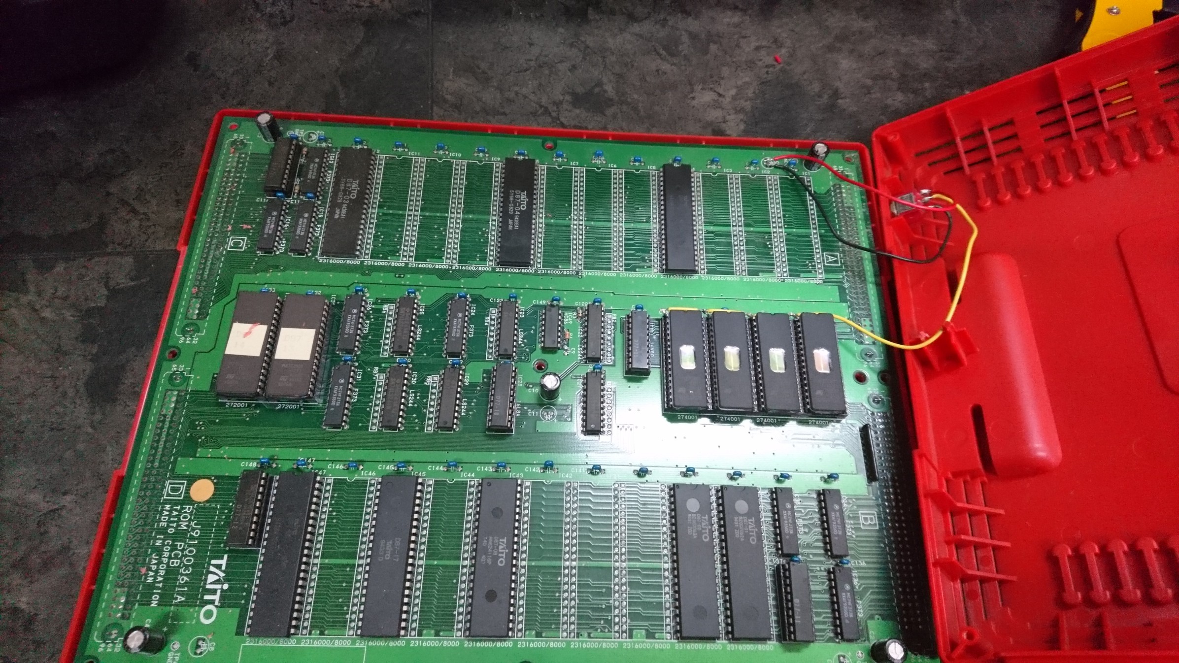

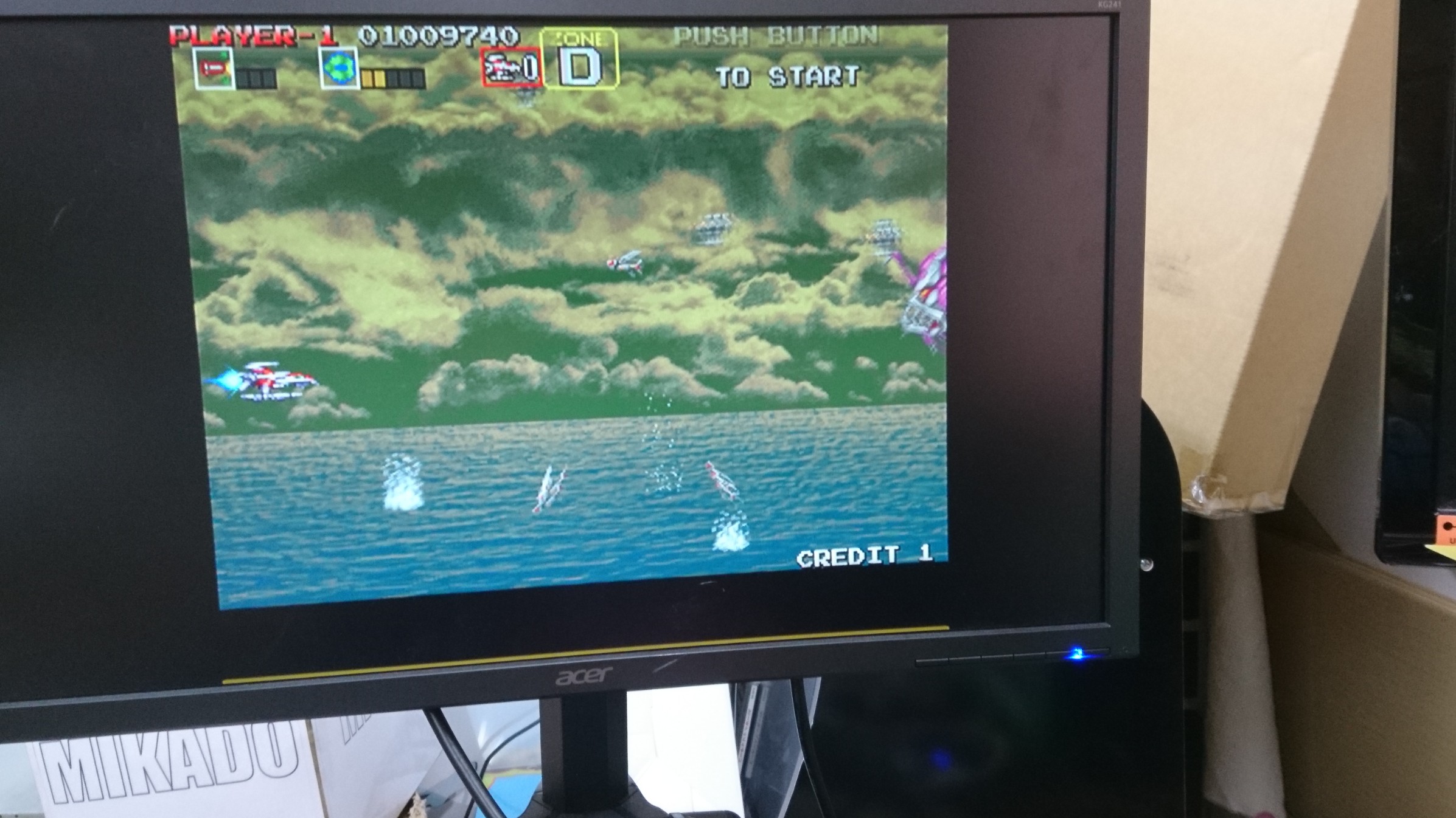

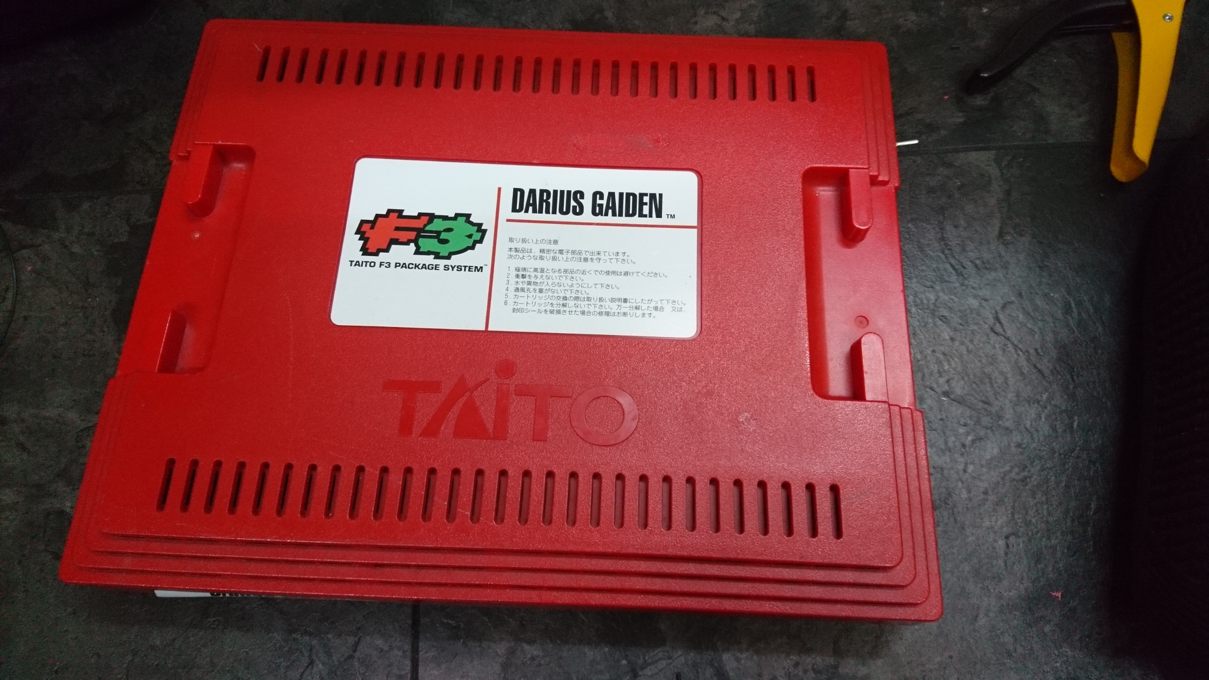

I tried it for real pcb.
No problem.

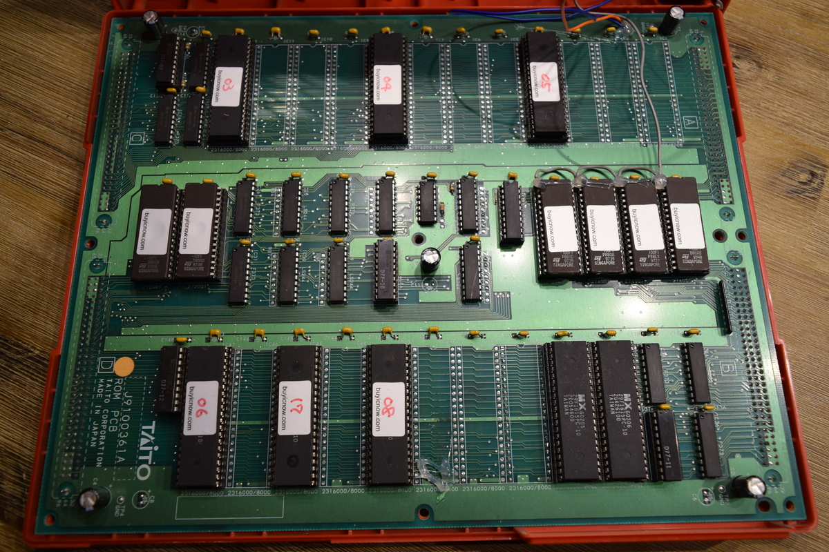

I'd like to apply it to my Gaiden & Gaiden Extra conversion, only I can't figure out which of the two files contained in the .zip go on which ROM (pic attached).
I'm guessing, two of the 4 grouped ones in the center, when comparing to TMF68k's pic?
Similarly, I can't manage to test the patch in MAME - which files overwrite which?
dariusgx.12 seems very similar content-wise to dge_mpr0.bin
and dariusgx.13 seems very similar content-wise to dge_mpr2.bin,
but at a quick glance the patch files appear to have some extra bytes in between the content compared to the MAME ones (some kind of padding or alignment)?
For that reason they're larger and MAME consequently doesn't start the game. When using the -debug switch, the CPU just hangs indefinitely.
On the one hand, this would lead me to believe that the files are already converted to work with the Multi (I have no previous experience with it), but on the other hand, TMF68k managed to install it on ROMs.
How do I go about this? :)
