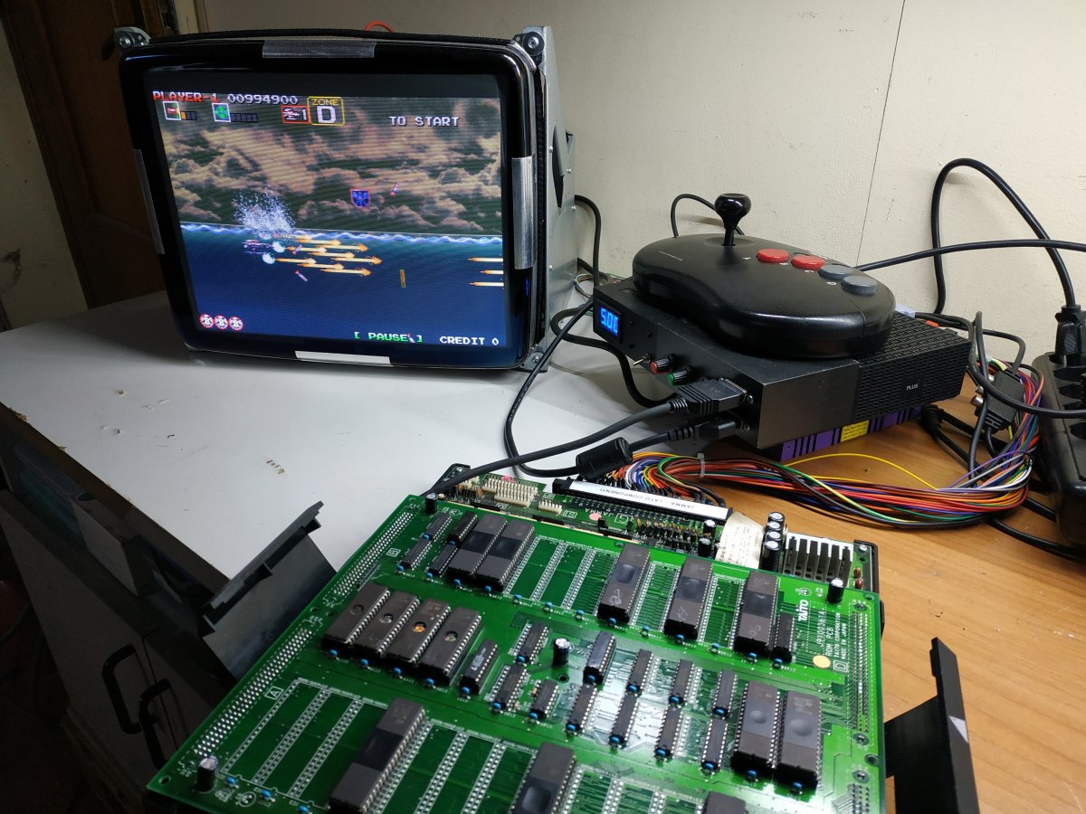

Here is a video from my F3 system showing the spot where it happens:
Darius Gaiden Extra ~ Stage D Bug ~ real hardware
(missing background and water surface)
Neither my Framemeister nor my OSSC were able to capture the F3 (an often discussed problem I'm sure you know of already, but not relevant here...). So a camera recording shall suffice for now.
Furthermore, while I'm still baffled why it is that way, I've figured out how to make use of the patch (throw away every even byte). The filenames to overwrite I posted earlier were correct.

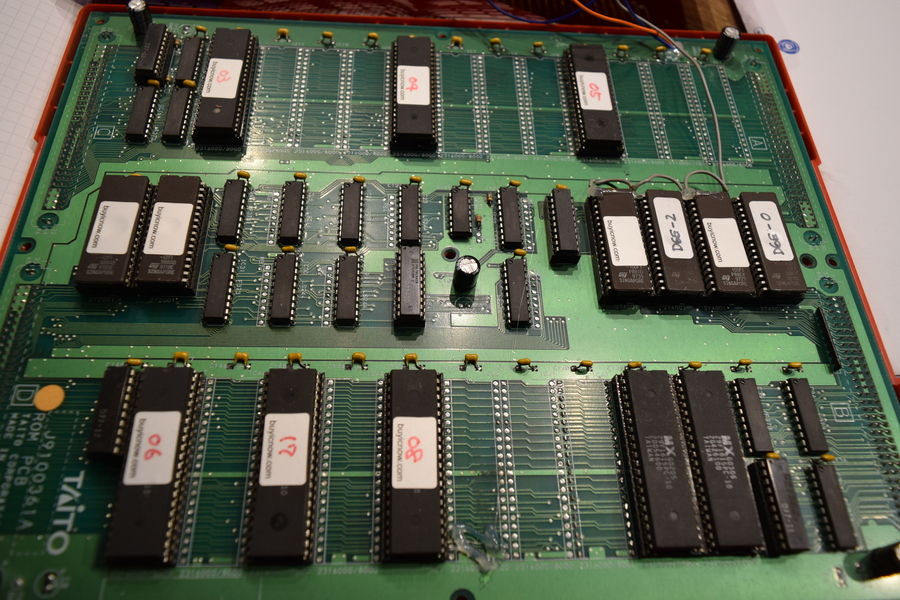

Today I finally got around trying the patch on my F3 system with EPROMs (pic attached).
Surprisingly, it does not work (video). I must be missing something, since apparently, it did work for @TMF68k?
Like real hardware with unpatched ROMs, the background and water surface are missing.
With the patch, the ocean ground is also missing and the extreme slowdown happens on the real hardware. Before, I attributed that to some MAME glitch.
So this is another unique variation of this bug.
Genuinely puzzled at the moment. Any ideas on what could be causing it?
Supposing the ROMs are bad, I'd assume seeing all sorts of glitches or even a failure at boot time.
Could my conversion cart / the other ROMs be different from TMF68k's?

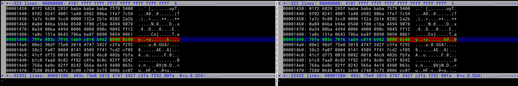

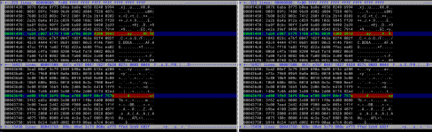

Right, 3 bytes are different overall.
Attached two xxd | vimdiff screenshots (dge_mpr0 and dge_mpr2).
On the left is the patch, on the right is the original ROM.
Can you change ONLY those 3 bytes on the eproms that you have replaced? The 3 bytes can be in 1, 2 or 3 different eproms. Sometimes the files can be splitted differently depending on the PCB that you have.
This finally convinced me to get an IC programmer, which I have here now.
So I read out the two M27C4001s that I previously removed to install the patch, and the contents are identical to the corresponding ones within the dariusgx romset as recorded by MAME. Meaning only those 3 bytes were changed (as per the diff I posted).
It seems as though my ROM PCB should be the same one that @TMF68k has (both have the ident J9100361A)?

Moreover, I should perhaps note specifically that the M27C4001 I used in December is of a too small capacity for a dual cart like @TMF68k 's and mine, which has a switch that lets you choose between Gaiden and Gaiden Extra.
The M27C4001 has 512Kbyte, which is only enough for one of either Gaiden or Gaiden Extra. The M27C801 is actually the correct one for a dual scenario; it has double the amount of memory and is pin-compatible with the M27C4001 except for pin 1, which effectively controls whether the rest of the pins address the first or the second half of the memory - which is why the toggle switch is soldered onto that pin. I only used a 2xM27C4001, 2xM27C801 program ROM setup because I wanted to keep the unpatched ones for the time being and had no other spare EPROMs lying around.
However, none of these specifities are a reason why the patch doesn't work. With that out of the way, I took a fresh approach today.
First I read out the two other program ROMs for good measure, which I hadn'd touched yet (and aren't changed by Darksoft's patch); no problem here:

I then erased the two M27C801s that have to be patched, plugged together the program data like this,
Bash:
cat d87-09.bin >> dariusg_dual_mpr0_patched.bin
cat dariusgx.12.oddbytes >> dariusg_dual_mpr0_patched.bin
cat d87-11.bin >> dariusg_dual_mpr2_patched.bin
cat dariusgx.13.oddbytes >> dariusg_dual_mpr2_patched.bin
For posterity:
sha1(dariusgx.12.oddbytes) = 9d02e56e2cd2df9e9a9dadaf08016620ee1efa5b
sha1(dariusgx.13.oddbytes) = 66da29d6c66c0f34362a2f1dcfc62ae68304ea55
burnt the files onto the M27C801s and installed them on the PCB. The EPROMs were thus positioned as shown in my December 10 post (from right to left: mpr0, mpr1, mpr2, mpr3).
It still doesn't work, the symptoms are the same as previously described. I also tried it with a different motherboard (but a "M20E001B NEW F3 MOTHER(EUROPE)" as well), same result.

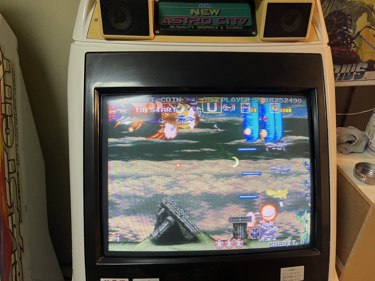

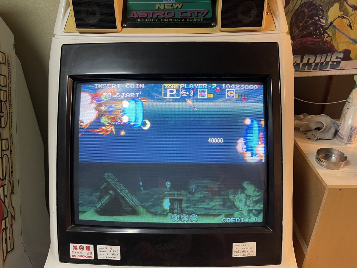

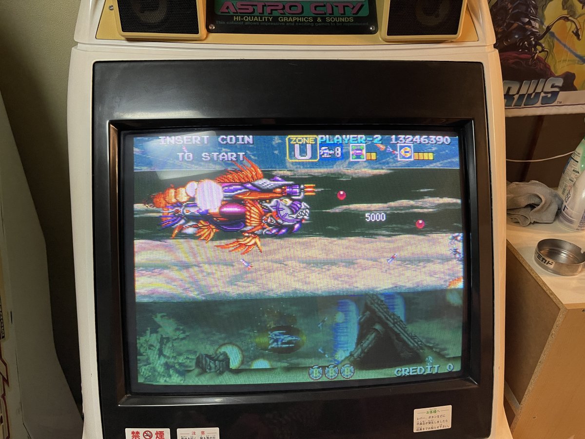

Regarding the background of DARIUS GAIDEN EXTRA.
When playing on the 2P side with the corrected ROM, ZONE P has been corrected, but ZONE U is strange.
The background is now displayed, but the background of the previous ZONE T is displayed.
ZONE U had the same mistake as ZONE P.
U is the same stage in the ocean as P.
