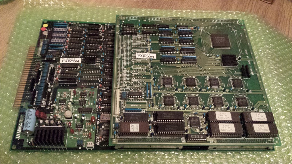

@ShootTheCore -- The issue is that Forgotten Worlds uses a custom B-Board with integrated C, and that is the only board that has the spinner connector on it.
Seems promising the information @Mitsurugi-w shared on this thread regarding a filter board with the connector on it though...
I honestly had no idea either until I looked into it. I would have assumed a C Board would have had the connector given all the conversions I’ve seen sold.
Forgotten Worlds B board also has a NEC uPD4701AC which handles the rotary inputs. I don’t know if it’s currently the case but when I tried to source those a while ago it was tough to find more than a handful.
These are the 3 major ICs in the spinners control circuit
The LWIO has been dumped/bruteforced and confirmed working
the M2334P is just a comparator
and the 4701 is the counter
