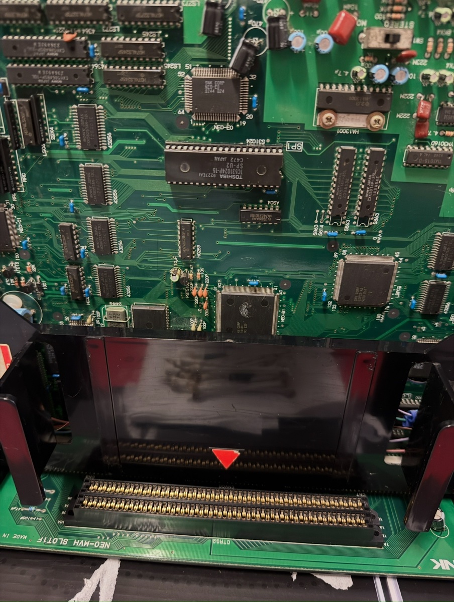

Thanks for detailed feedback. The cart draws more current than a regular cart, so many things can happen. The track that you severed helped with some models that had issues, but that MV1F sometimes worked, sometimes didn't. Could you share a picture of your PCB and your setup? Going so high to 5.25-5.7V is too much. I don't where you are measuring the Voltage, but it should be measured on the cart slot, right before it goes to the multicart.
I'll have a look at the firmware files again, but they should be OK.
About the romsets, I can't comment on those as you can imagine.

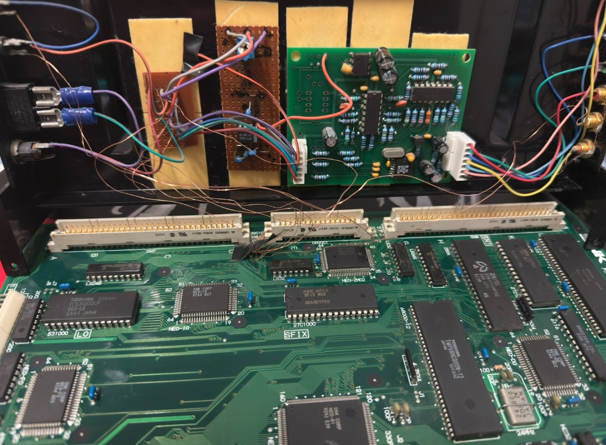

Ohhh, you want the measurement from the cart connector? Sorry I’d literally been measuring from the 5v dc output on the MeanWell, right next to the voltage adjustment. My bad.

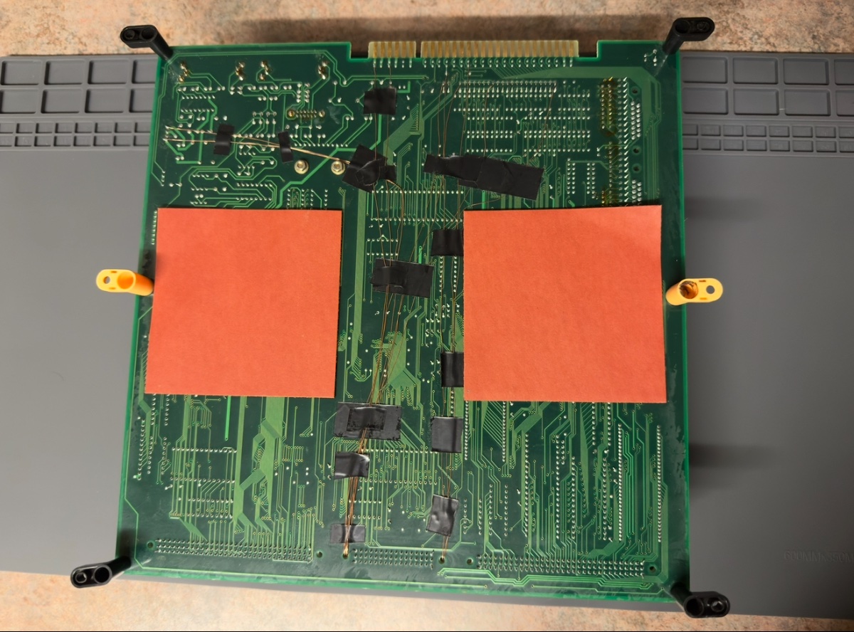

I just cleaned the whole motherboard the other day, so I can share some pics of the PCB…but it isn’t pretty 😅.
Immediately you’ll notice all the enamel wiring/magnet wire I used to connect to the mainboard, as it was much easier to route and work with.
While it’s worked perfectly well for actual MVS games, I’m guessing that may not be great for the multimvs? I don’t know if it would lead to more interference?
I did the job about 20yrs ago. I know I tapped all the points that Jeff Kurtz said to use on the instructions, but I’ve now lost them and they’re apparently gone from the internet.
I was going to recap the board and redo any connections that had gone flakey, but they’re all still solid to my amazement 😂.
(I was really using some junk soldering gear back then). Also all the caps I tested were still in the same range as the new caps I’d brought, so I didn’t see the point in recapping at the moment.
The spider nest of wires on the bread board, is where I built the sync circuit, as it gave me easy points to run the connecting wires to the pcb. It seemed easier to me back then than installing it in the location that Jeff had provided on his pcb.

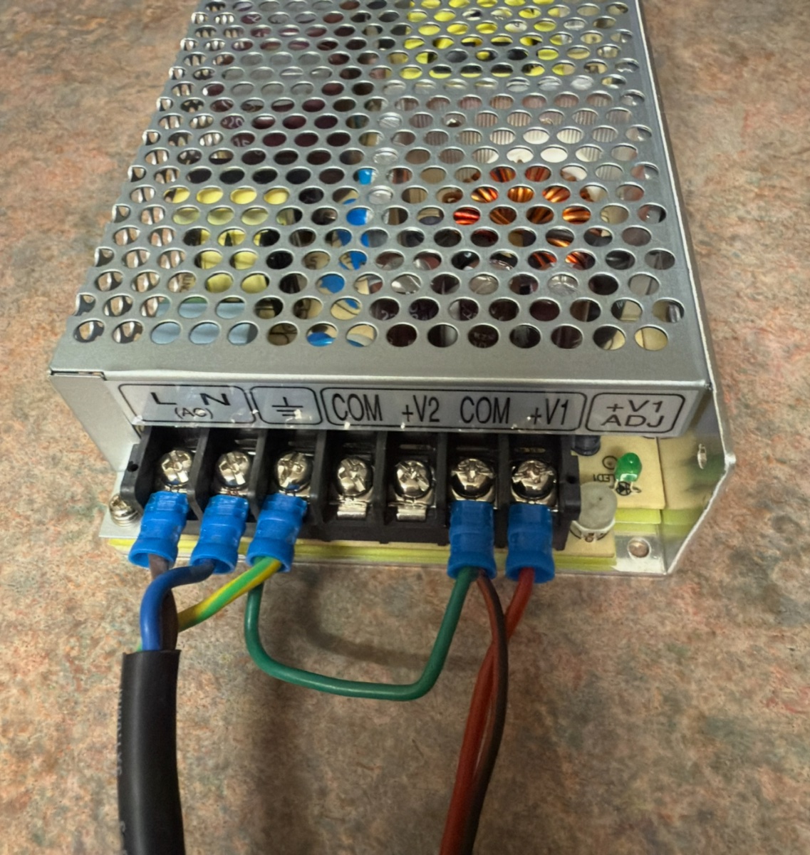

Also when I wired up the Mean Well I just replicated the wiring from my old Sony power supply. Is it ok having the common rail tied to ground? I was always told we should, but don’t see anyone doing that now days 😅.
Yeah, that doesn't look bad but also not good. It could be a source of problem if it's interfering with the board somehow.
Anyways, let me know those V that you get on the cart slot and let's take it from there.

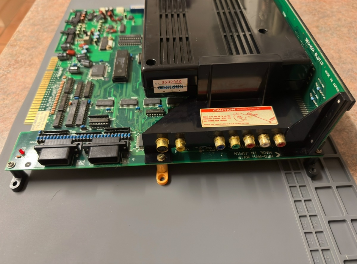

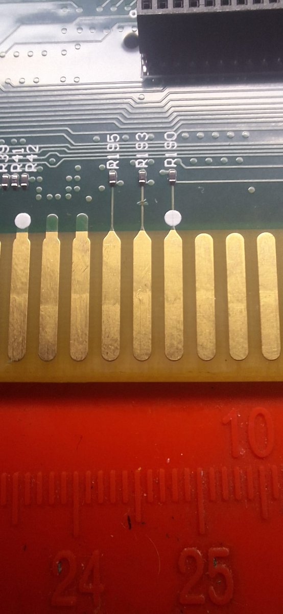

Tested all firmware with CPLD file that you added with two mv1fz board with stock bios.
R1173 and 1102 have the same audio problem while 1040 gets stuck on the installation screen.
(black screen)
I also tried cutting the trace at r193 resistor.Unfortunately the audio suddenly disappears after a few minutes of playing.

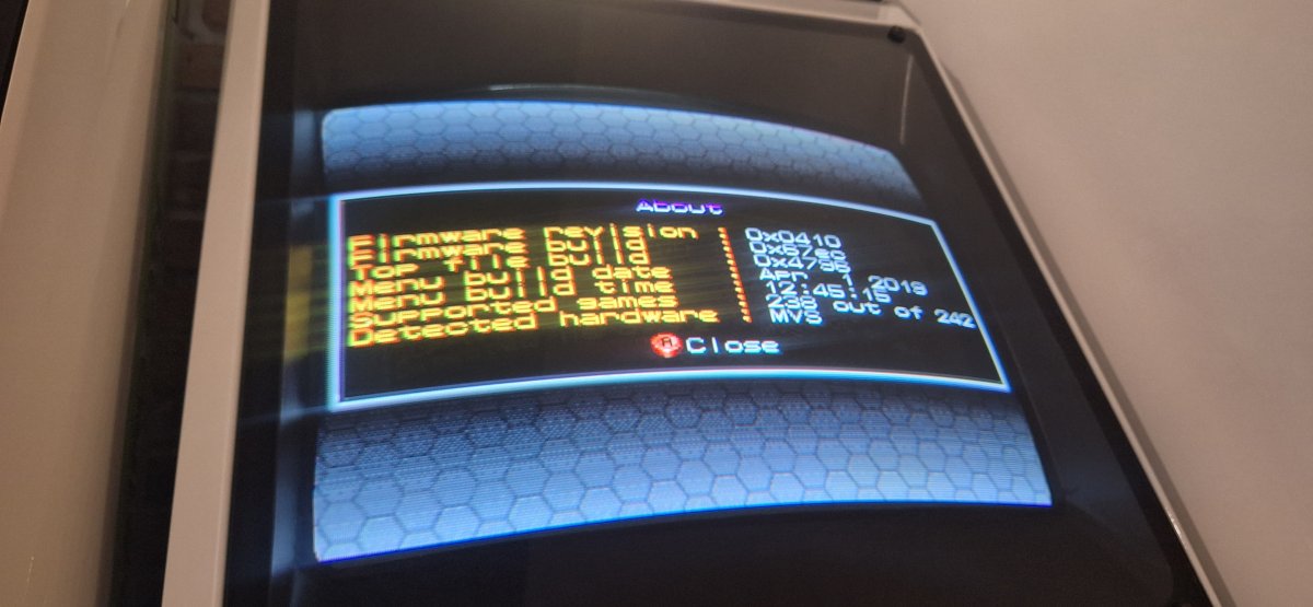

@Rizzardi84 @Skulmonky in order to run r1040, you also need to update the firmware:
PREVIOUS MENU April 1st (Needs FW 1040 or lower, available in the attachmen of this post): https://mega.nz/#!Vow1QapY!BDwTV-eK2_-qpQK8F-7L2hxYkKUJsiyCr5Dqqi9Ewp8
