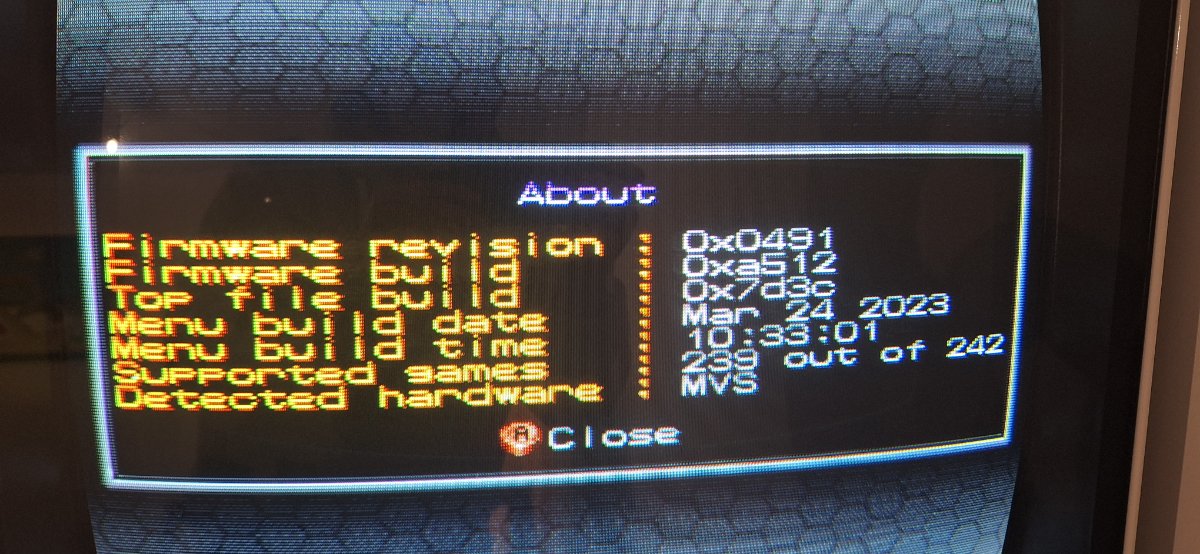

Which version of FW do you have? The one that came from factory or did you upgrade something?
here it is, I have not updated anything, I thought that since it is the latest batch the firmware was already updated.
