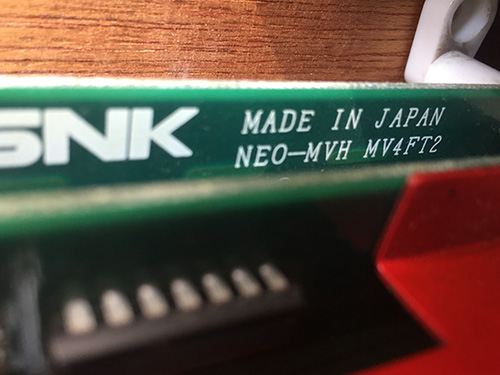

Big red 4 slot.
Thanks for info. Please let me know the exact model of your 4 slot.
NEO-MVH MV4FT2
