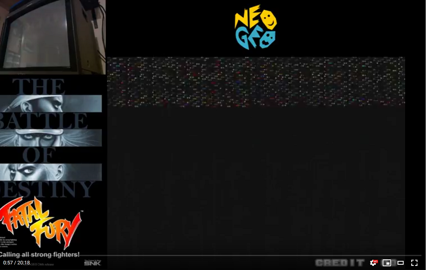

I was making a video to show the weird minor glitching I get after the latest menu update and somehow I triggered this weird debug. This is on an MV-1FS, 5.0V. I have all the latest menu, top and firmware and have cut the trace to fix the noise issues. I get random black bars and flickering towards the top of the screen occasionally too.

The main purpose of the video was to show you this thing that happens after the latest update, happens in lots of games when transitioning between menus:
You are not clearing NVRAM, properly. As the message on the screen says PRESS B to clear NVRAM and you'll get a window confirming that it all went OK.

Cheers. I went through and retested all last night and made a new video.
-Tweaked my voltage up a to 5.08 (seemed to have dropped below 5 again)
-Replaced my motherboard battery
-Cleared NVRAM properly
Fixed most of the stuff. New video:

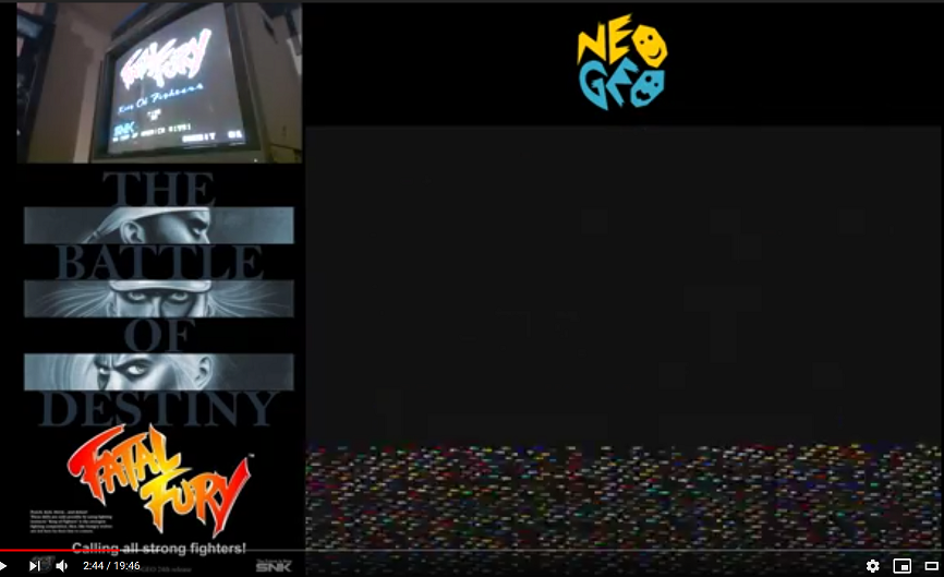

Still with the weird flash of static - this is new since the menu update.
Also check out the little glitch that happens on the menu from
Maybe ignore me for now... Got an original Fatal Fury cart and it's doing the static now. I have no idea why :(
