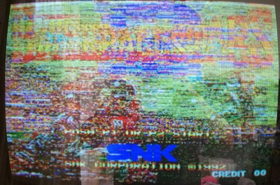

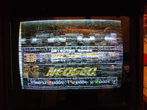

The cart seems to have a glitch that screws up the graphics that extends to the games. I've posted a thread about it here https://www.arcade-projects.com/forums/index.php?threads/choppy-glitchy-screen-problem.11221/
Can you be more specific?
Which motherboard are you using?
Which Firmware and which Menu versions are you using?
Does it happen with all games or just some?
:D
AS seen on the thread, the graphics tends to screw up. It applies to all games as well as the menu.
As for the motherboard, I use a MV4FT.
The firmware and menu are all recent. I even tried to use the previous one but it didn't work.
I'm trying to replace the battery of my system to see if it changes something which would take a couple of days because I'm still waiting for it to arrive. I was planning to use the menu-25022018 version to see if it would work(based on here Darksoft Neo Multi Help thread) but I don't know what firmware to use.
