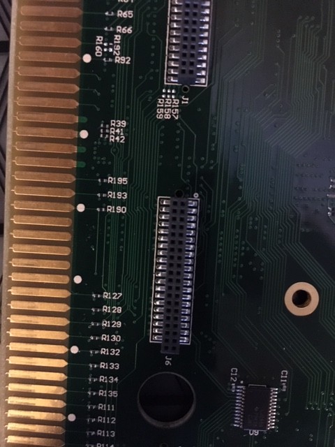

In my case the R193 track is not severed. I think I’ll leave it alone and just remember to lower the voltage when I use the cart with a MV1FS.

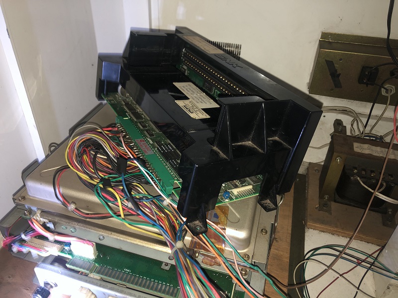

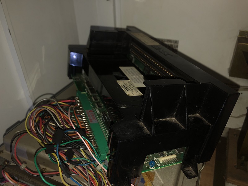

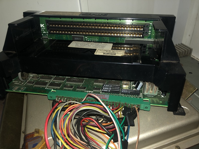

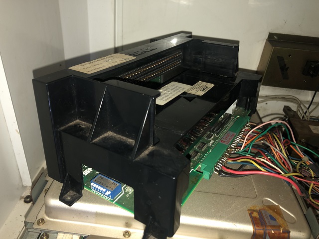

Dont push it that high. 5.1V should be enough. Can you send some pictures of the MV1B motherboard from both sides? Which BIOS do you have? Is the microSD slot working well in your opinion? Take it back to another mobo to be 100% sure that it's still working please.
Its the regular bios. The micro Sd is working well from what i notice. I tested it in my 2 slots and its fine.
What’s the voltage reading showing on the MV1B?
4.97V. I will try 5.1V.
No go. I tried as high as 5.2V and nothing. It freezes in "checking games".
This is how you fry your games.
