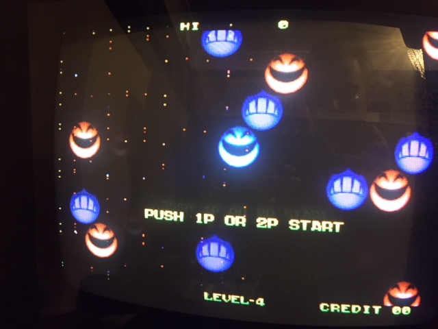

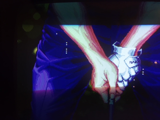

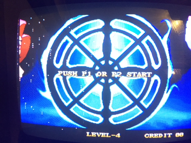

OK, so having properly updated the menu I have unbricked my system and now up and running again :thumbsup:
I am seeing the corrupt pixels issue though, on the menu and in games...
