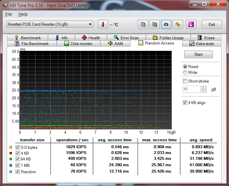

However SD cards have some interesting features. If you have http://www.hdtune.com/ run a speed test on your card. I remember some transcend cards slowing down on certain boundaries.
That could also be an issue. Slow microSD could make a DMA miss and produce those white pixels. However I'm surprised they are always in the SAME place. We'll see the. @waiwainl please run that test and let us know the output.
