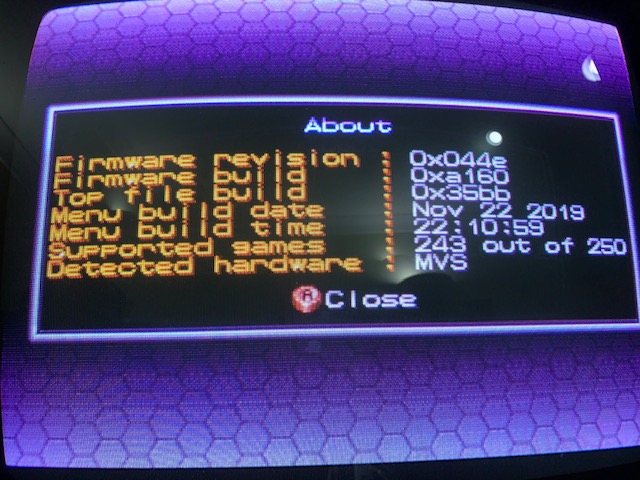

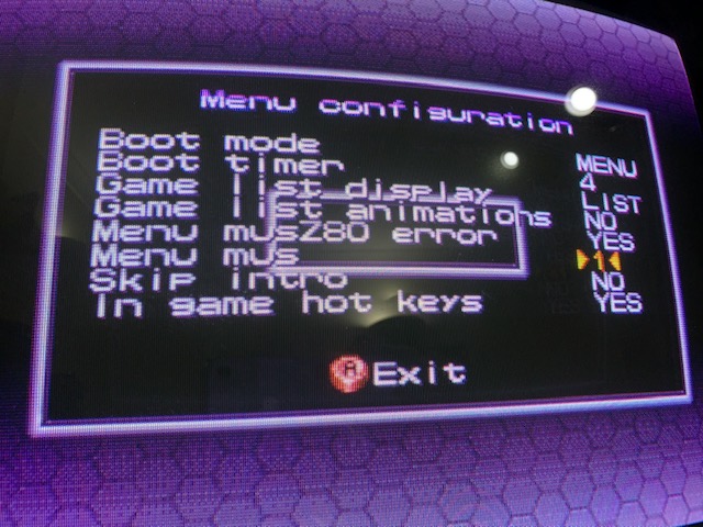

I haven't updated my MVS multi in a while, but i've put on the latest fw and menu and now i'm not getting any sound. Also not getting any sound in the menu and if I go to select music it flashes up 'Z80 error'. However i've tested with a regular cart and sound is working fine with that.
I will admit I accidentally flashed the AES fw on X/ but have since flashed it with the correct MVS fw.
I'm using an MVS 2 slot. Any ideas?
I will admit I accidentally flashed the AES fw on but have since flashed it with the correct MVS fw.
Did you reflash again both files TOP and flash.img and the corresponding menu as well? I think you forgot the menu.
Yes i reflashed the flash.img, then the top file then the menu. All disappeared from the update folder so I assume worked ok.
The AES version had a cpld file however and there wasn't one of those in the MVS fw.
Try this CPLD and see if it helps. If it doesnt, then it's probably a bad contact between cart and motherboard.
