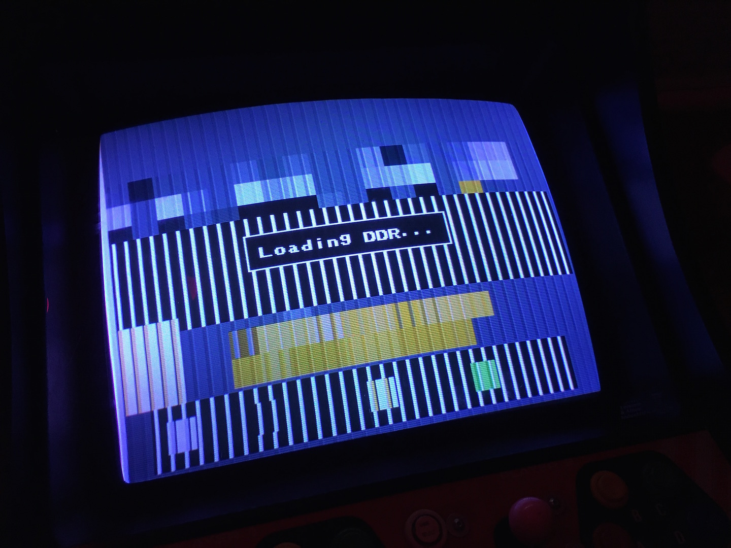

Been spending a lot of time with my Neo Geo Multicart and have the following issue with the current Firmware. I'm using a FZ motherboard. 5v Checks out fine. I've tried two different Neo Geo FZ motherboards (one with battery, one without) as well as multiple SD cards with the same issues. The trace has been fixed/cut on my motherboard. This issue didn't happen with the last firmware I was using from about a year or so ago.
If I load KOF '98 in Slot 1, there three things that can randomly happen:
1. Little white lines/dots appear throughout the splash screen sequence and player select screen (most common)
2. Sprites are missing from the game / splash screen (sometimes)
3. The game loads ok (probably once every three cycles)
At first I thought it was a dirty cart slot and spent time reseating it and also the SD card, but power cycling causes any of the above to occur. I've cleared the NVRAM from the main menu as well as the Neo Geo menu. I'm using a standard BIOS and the latest Roll Up Pack from archive.org.
Other slots / games seem fine thus far. I need to load KOF '98 into other slots and cycle and see if it's just Slot 1.
Thanks in advance for any advice.
that looks very weird. Please tell me which exact FW you use and try with other slots please.

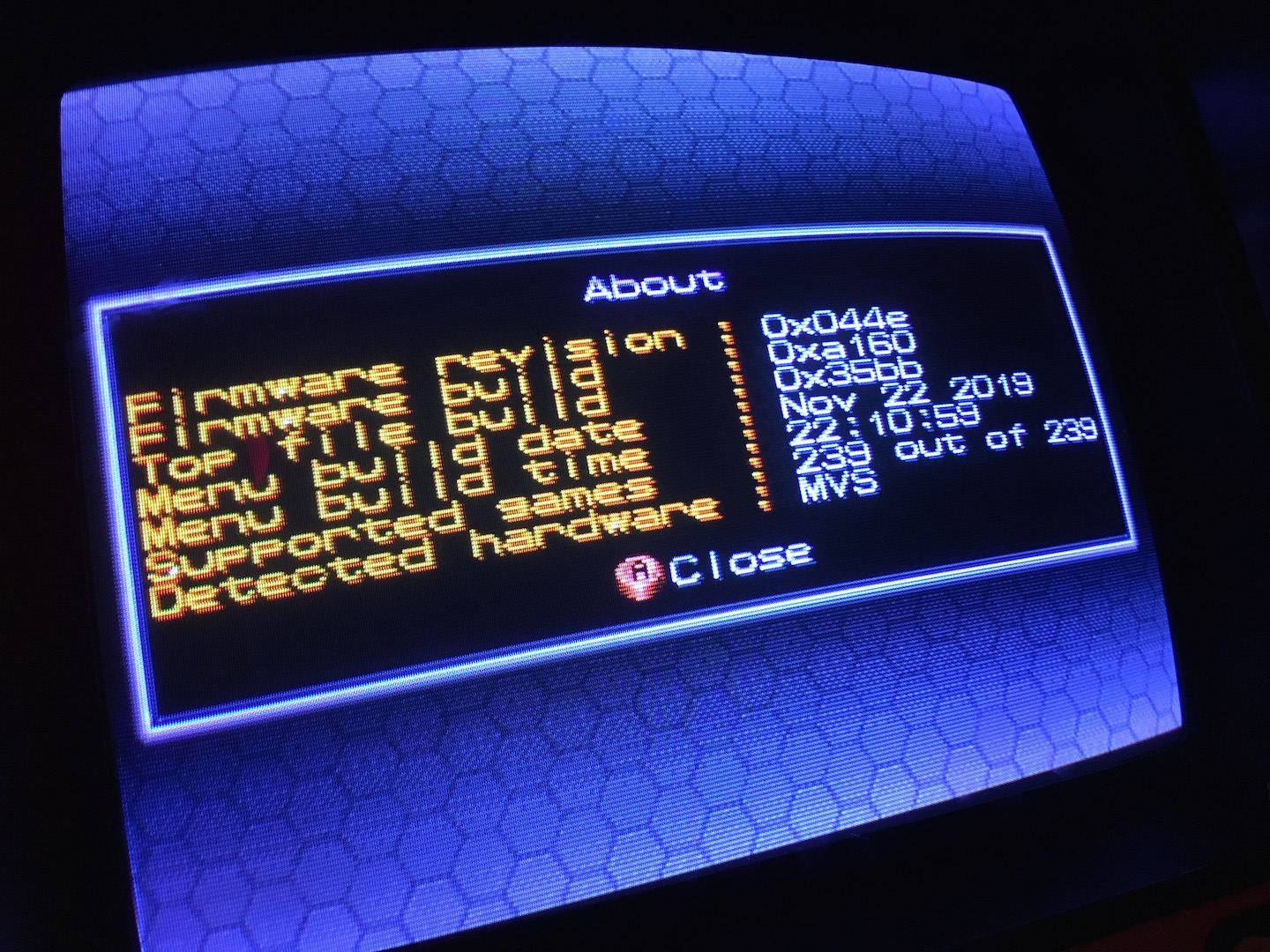

Hey @Darksoft,
Here is the version of the Firmware I am using (I believe it's the latest):
I get this screen occasionally when loading the DDR (maybe once every 8-10 times):

Also, this behaviour happens in all 3 slots. Power cycling or hot switching between slots generally fixes it up.
Let me know if you have any leads on a fix or more diagnosis :)
