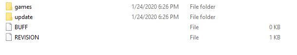

So I got it to work the first time I did the steps with a 4GB Micro SD card but the same thing as last time. I press C to look at the menu and the menu never comes up. It's like each memory card can only be used once and then it won't work again. Right now I keep getting stuck on "Initializing filesystem...". It won't go past that screen. Any idea why the menu won't show when I hit the C button?
@rivlez When it gets stuck on the "checking games" screen try holding up+start for a few seconds to see if it will get you to menu.
This unfortunately did nothing for me.
