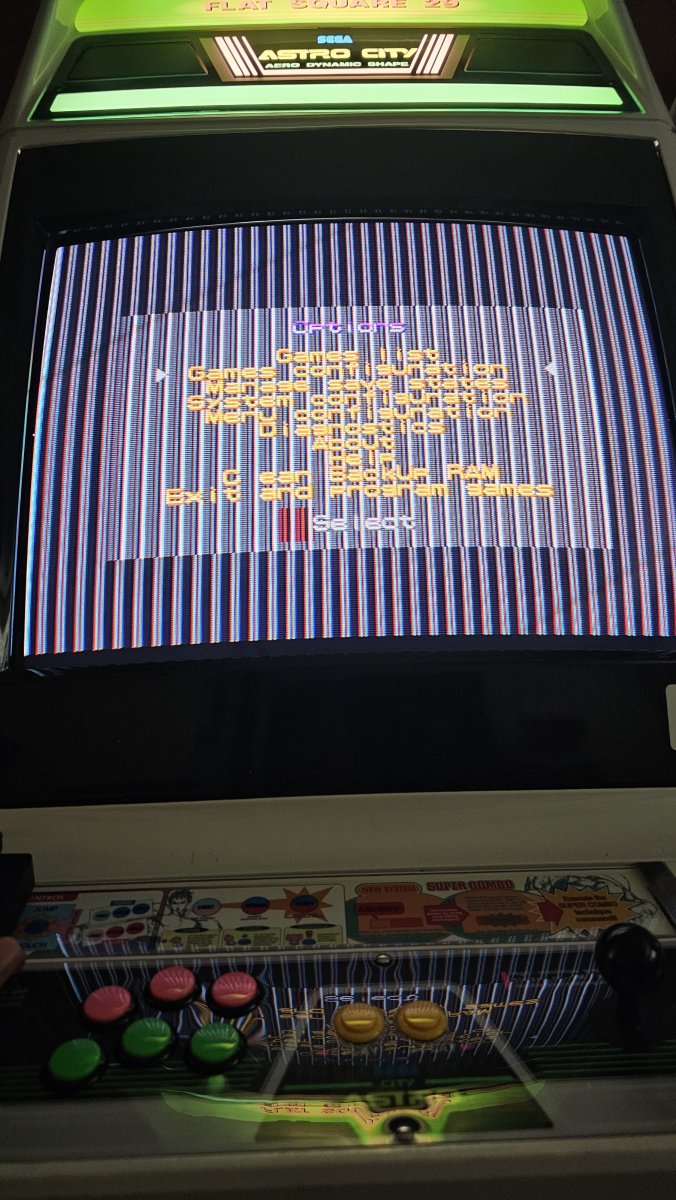

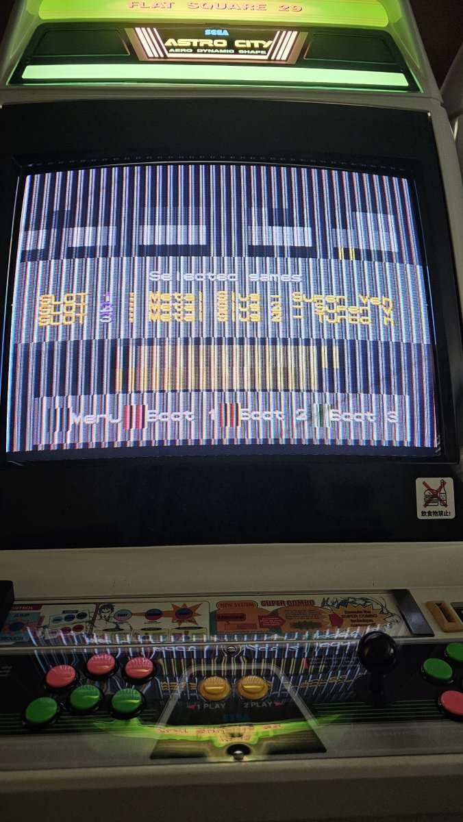

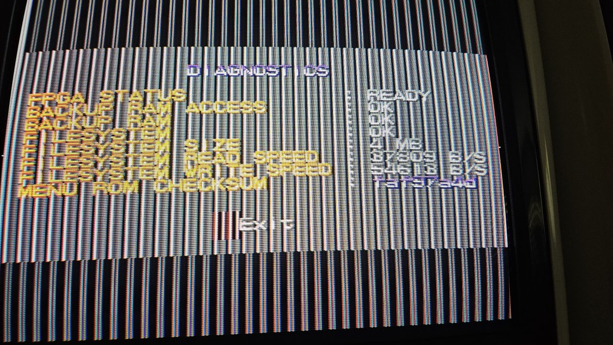

I have an issue with a Darksoft MVS Multi Unit. It has graphical issues shown in the picture. I have tried the following:
1.) Verified proper voltage levels
2.) Tried a different MVS Motherboard (MV1FZ)
3.) Tried a different known working SD Card from a different Darksoft MVS Multi
4.) Tried different arcade cabinets
At this point it's looking like an issue with the multi itself. Any help or suggestions on how to continue to diagnose or resolve this issue would be appreciated.

I did update the firmware and menu and the symptoms remain the same. To add to symptoms, the games also have missing graphics and sprites. The jail bars you see in the menu disappear when a game loads but the game has missing graphics and sprites.
@Anselmo
What MVS board(s) are you using? There's a known solvable issue with MV1FS. Dropping the voltage or cutting a pcb trace solves it.
Paging @Darksoft . I hope a part on his cart hasn’t gone bad.
I suspect it could be one or more bad level shifters, similar to how the cps2 multi can have level shifter failures?

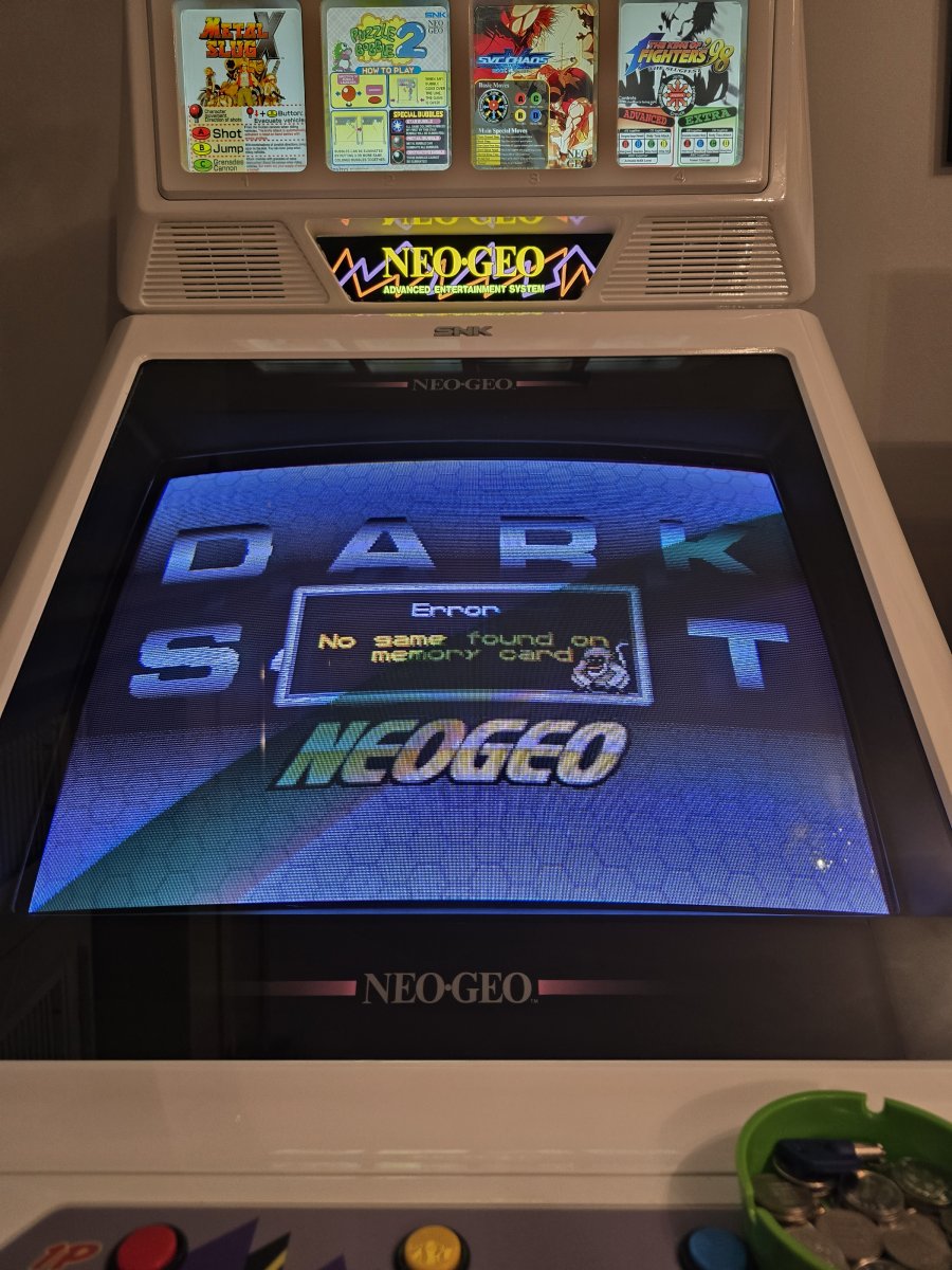

I recently got a second hand Multi MVS and I'm getting this error when using on a MV1F motherboard using Unibios 4.0:
Every 5 to 10 attempts to boot, I get the "No game found on memory card" monkey error. Rebooting usually fixes it.
I'm aware of the issues with this particular board. I've dropped the voltage to 4.7V. It seemed to help a bit, but still got the issue. I opened the cart and the trace to fix the issues with MV1F was already cut. I checked continuity and there was none. I've replaced the CR 2032 battery by a new one, as the old was pretty much dead, it seemed to fix other issues I was experiencing (constant loses of configuration, graphic glitches on the menu time to time...) but the monkey error keeps happening. I've also tried clearing backup ram from both the Multi menu, and the MVS bios.
When using a MV1F board (factory bios) I never get this error.
Any ideas?
Thanks.

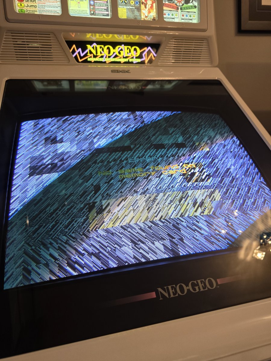

Getting a "mvs file system not ready error" in my 4 slot. Then the screen goes all scarmbled and sounds like an old tv with no signal. Tried my single slot aswell. Any ideas?
Im using a 16gb SDHC fat32.
All slots work fine with carts I have.
Thanks
