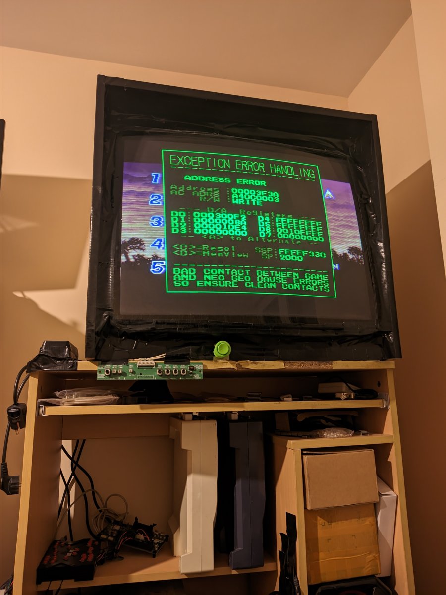

Tested with Shock Troopers original unit. In one of my MVS motherboards, the game didn't sound on attract mode and when entering the points screen, it threw exception.
Cleaning the backup ram on MVS test mode did the work. It seems this game is a little sensitive to backup ram info.

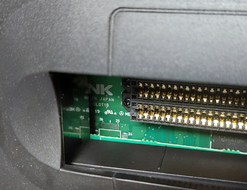

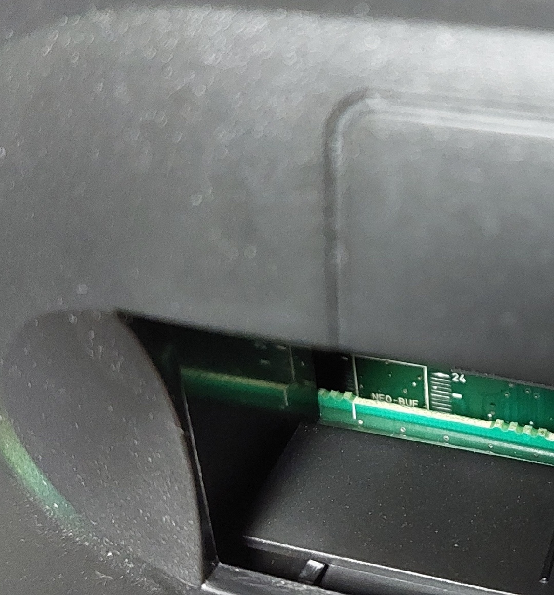

As you mentioned, when I checked the board, I saw that the neo-buf chip was empty around the cart insertion area, as shown in the picture.
I looked it up on YouTube and saw that there are a lot of neo-buf chip parts in the board. Do I need to fill all the parts with neo-buf chips?

I am only aware of the 1 you referenced that is missing.
