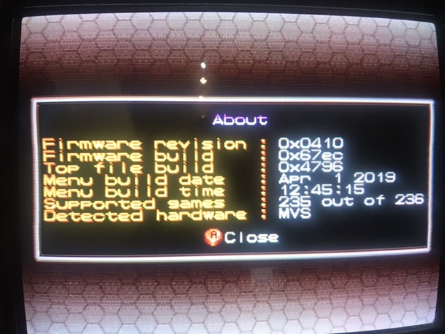

@INGUES what does your section ABOUT in the menu shows? As @SVM stated, please let us know if it works after deleting the BUFF file.

This is for MVS. Here's what the About menu shows:
Firmware revision: 0x044e
Firmware build: 0xa160
Top file build: 0x35bb
Menu build date: Nov 22 2019
Menu build time: 22 : 10 : 59
Supported games: 238 out of 239
Detected Hardware: MVS
I went ahead and deleted the BUFF file and then re-assigned the games to different slots and rebooted. The issue appears to have gone away by doing that and I can see normal graphics in MS3 and Blazing Star. The About menu has the same values as before I deleted the BUFF file.
I think it's resolved but let me know if there's anything else that I need to do or if something looks off in the About details.
