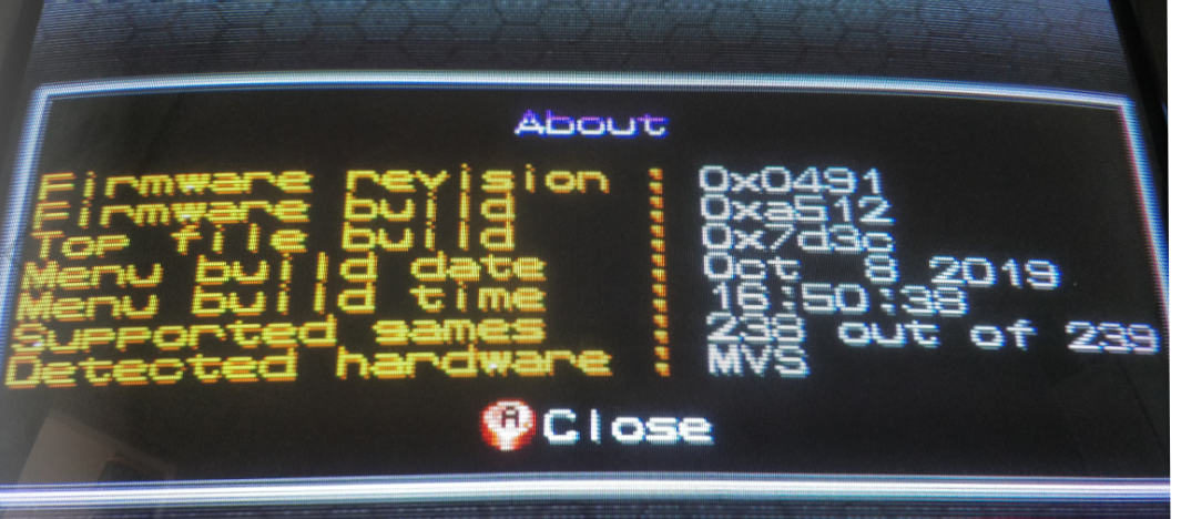

@jassin000 I tried to roll back to R1102, and I got it to boot games but no sound for some reason. I tried again to install the new firmware but still ended up with the Crosshatch screen whenever I try to load a game.
I'm using a MV-1FZ with unibios3.3 and NeobiosmastaVMC.
@mathewbeall, did you load the firmware files in three steps? I installed flash.img ---> erase memory --> install top --> erase memory --> install cpld.
