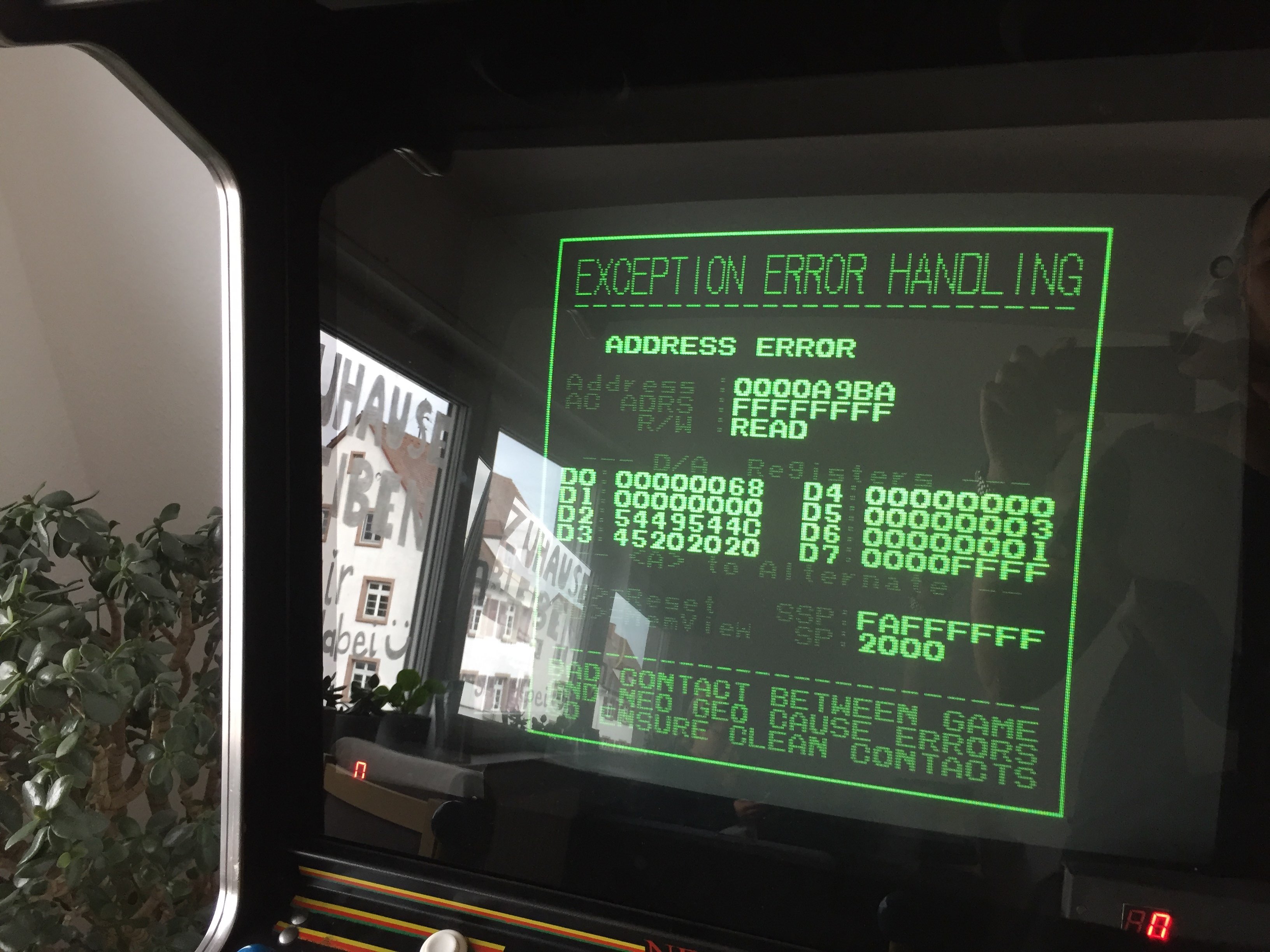

I tried the last firmware and World Heroes still crash at the ending credit with both stock bios (reboot) and unibios4 (exception error handling)

I cant reproduce that here, but I'll have a look again.

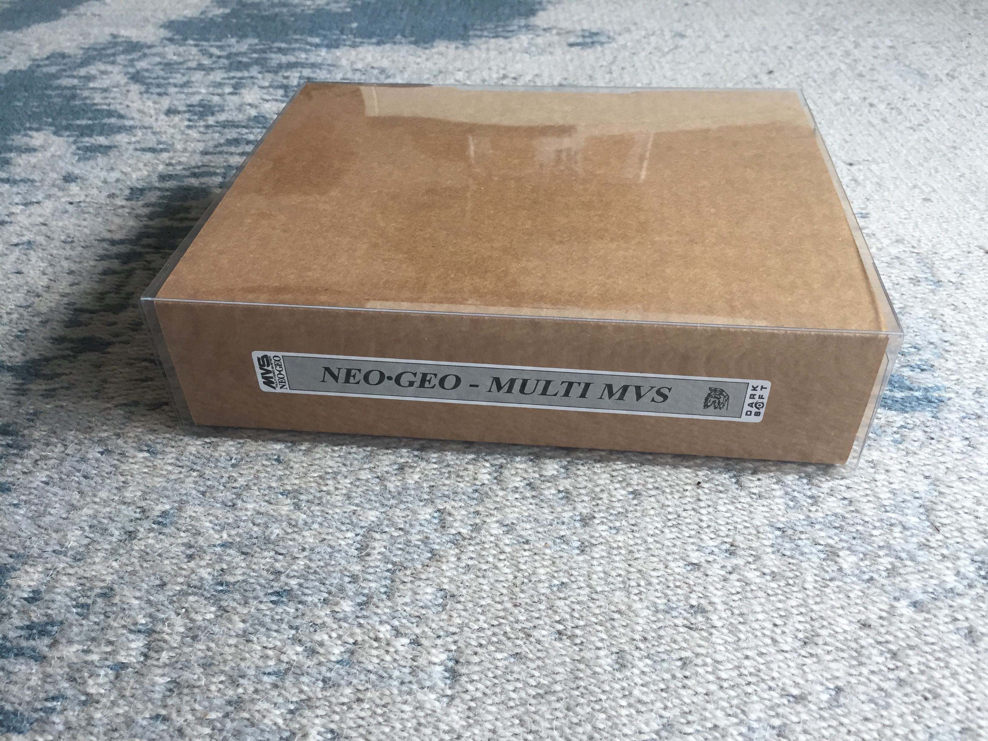

Today arrived my MVS Multi cartridge, oh boy that was very very fast and the packaging was really nice:
Thank you very much @CPZ - SAVEYOURGAMES :-)

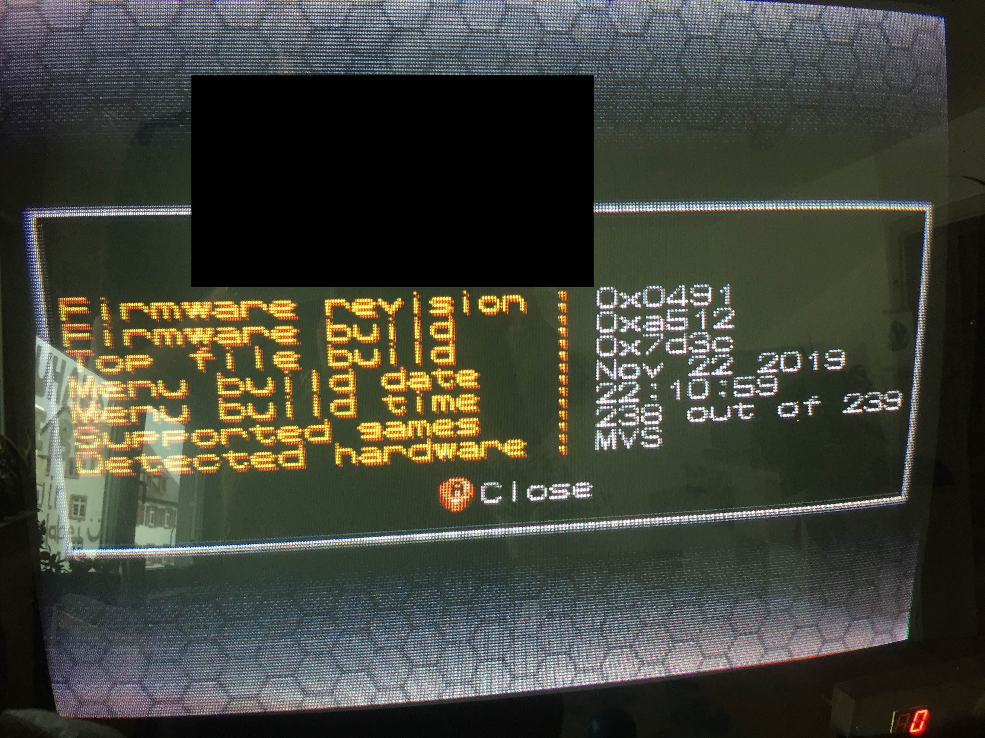

I installed the new firmware, which was quite easy and added some games.
IMG_8801.jpg*
I removed my face with a black box^^

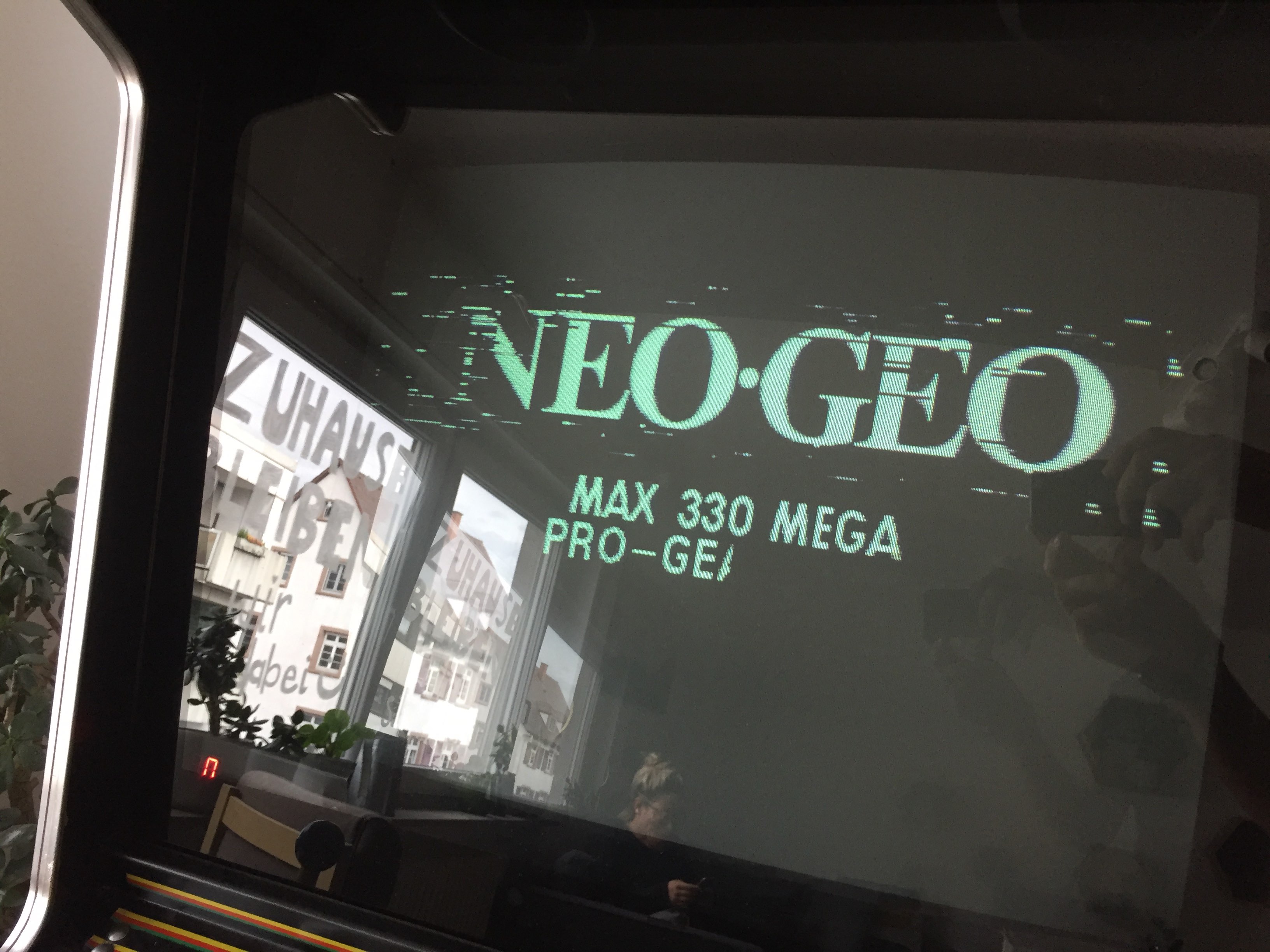

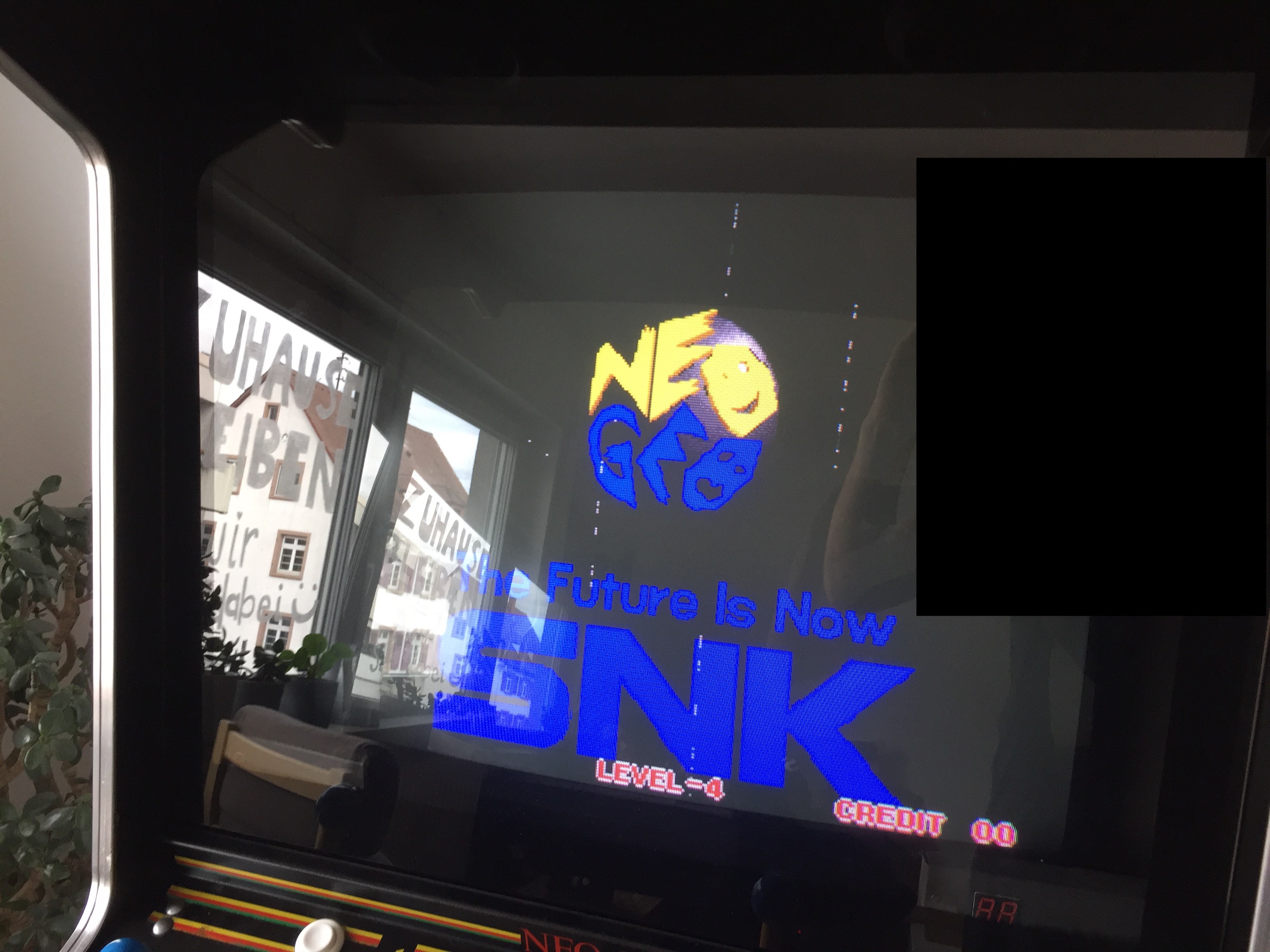

When starting my 4 slot board while my KoF 94 cart is in any other slot (yes any other physical slot) the system starts like this:
The KoF 94 looks like this:
Normally KoF 94 works perfect. When I replace KoF with SockTroopers no physical games have sound.
When I load the game V-Liner, the hole system restarts.
And two times I got this:
Also I have to soft restart the system to get into the MVS Multi menu. Starting worked perfect with the old firmware, but the in-game sound level was not constant. The graphical issues where the same. I also tested the Multi cart in any slot and I also checked the voltage: 4,95V
When the MVS Multi is the only cart it starts at the first try! Are other carts are not supported when the Muli cartridge is inserted? I tested some games and it worked quite well with my 4 slot board.

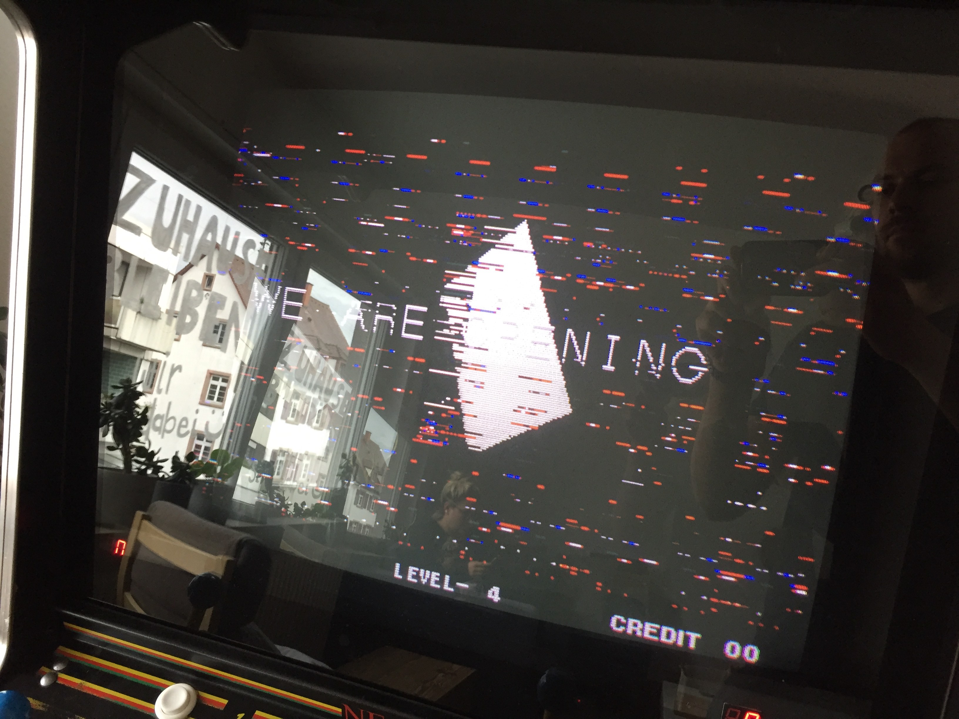

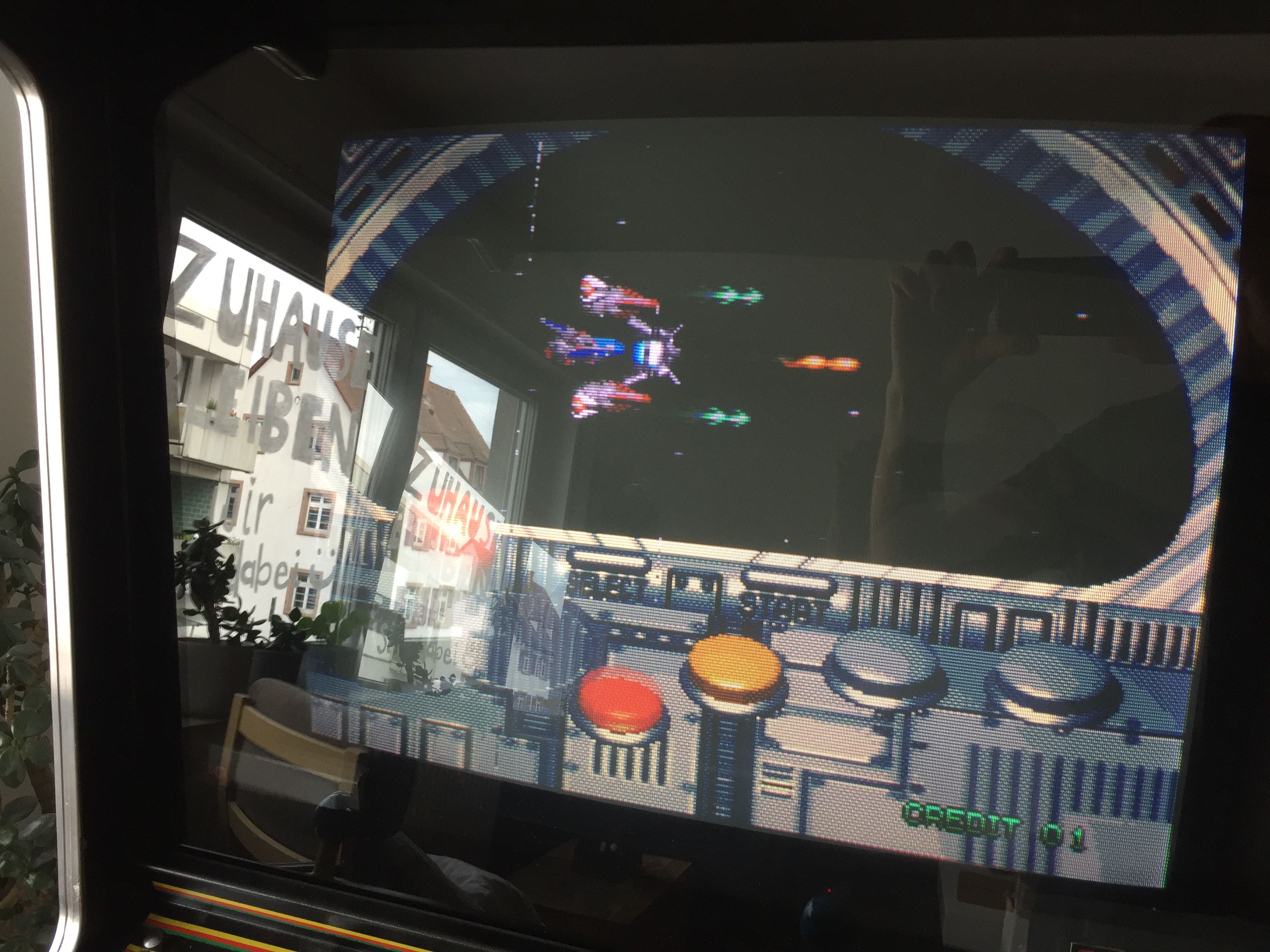

I also testet it with my 6 slot board. No problem while starting or with the KoF 94 cartridge but I get some graphical white artifacts:

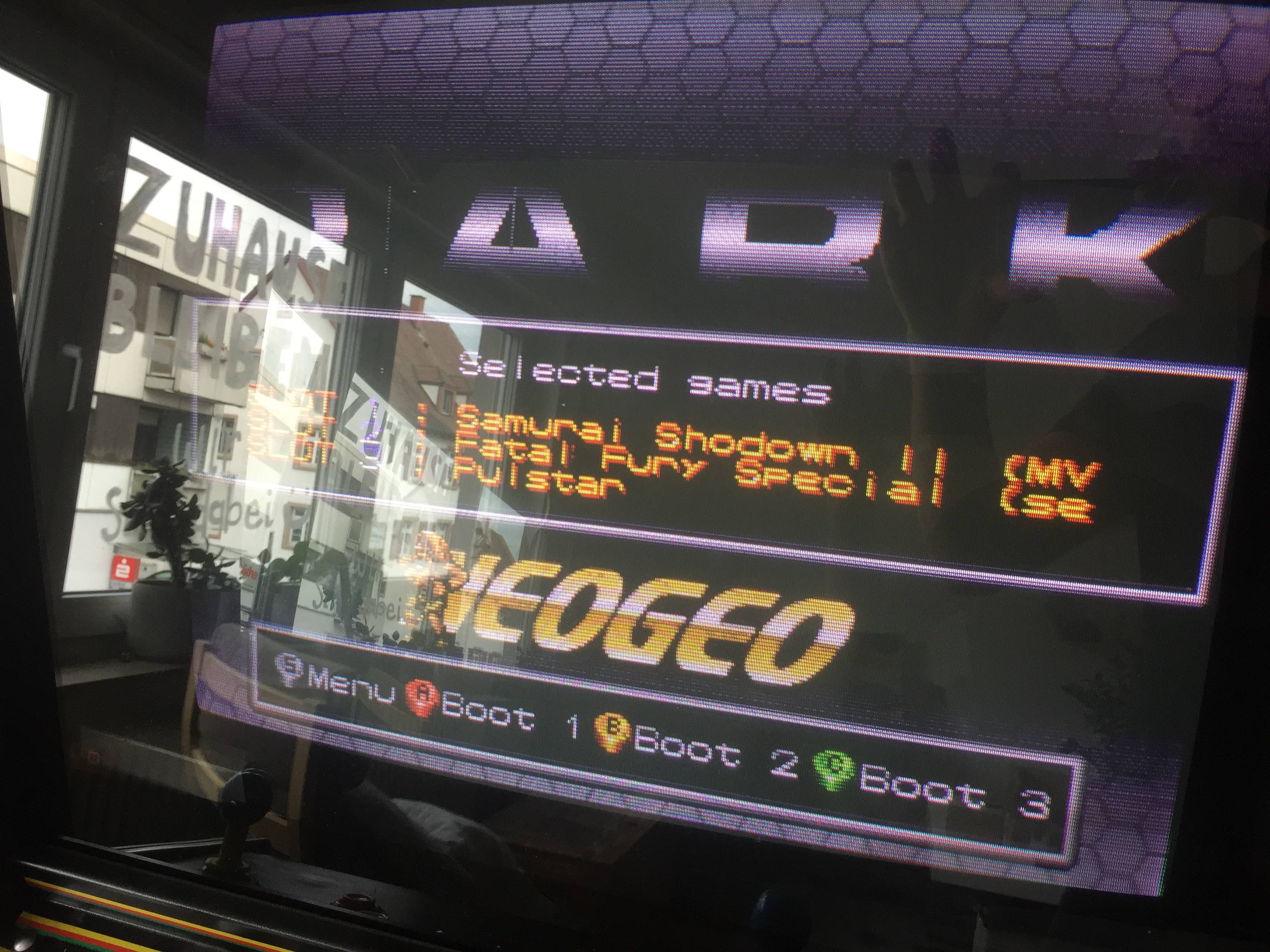

Menu
Samurai Showdown II
Pullstar

It works like this on my 4 slot with an UniBios 4.0 after I did a soft reset. But the first time it doesn't show up.
It loads and plays games fine inside my 4 slot MVS cabinet!
In the meantime I tested roundabout 20 cartridges in combination with the Multi even with and without UniBios. Here are my results:
4 slot MVS board with an UniBios 4.0:
  1. Multi cartridge does not show up at the first start
  2. Multi cartridge works fine when it is the only cart
  3. Sometimes the menu sound gets enabled even when I turned it off
  4. KoF 94 cartridge has corrupted graphics
  5. When Metal Slug X or Metal Slug 5 cartridge is in any other slot: the console freezes while starting the Multi cartridge
  6. Games can be played via Multi cartridge perfectly (after a soft restart and no KoF, MS X or MS 5 in any slot)
4 slot MVS board with normal Bios:
  1. Multi cartridge starts at the first try (alone or with other cartridges)
  2. No issues with KoF 94 (I did not test MS X and MS 5, sorry!)

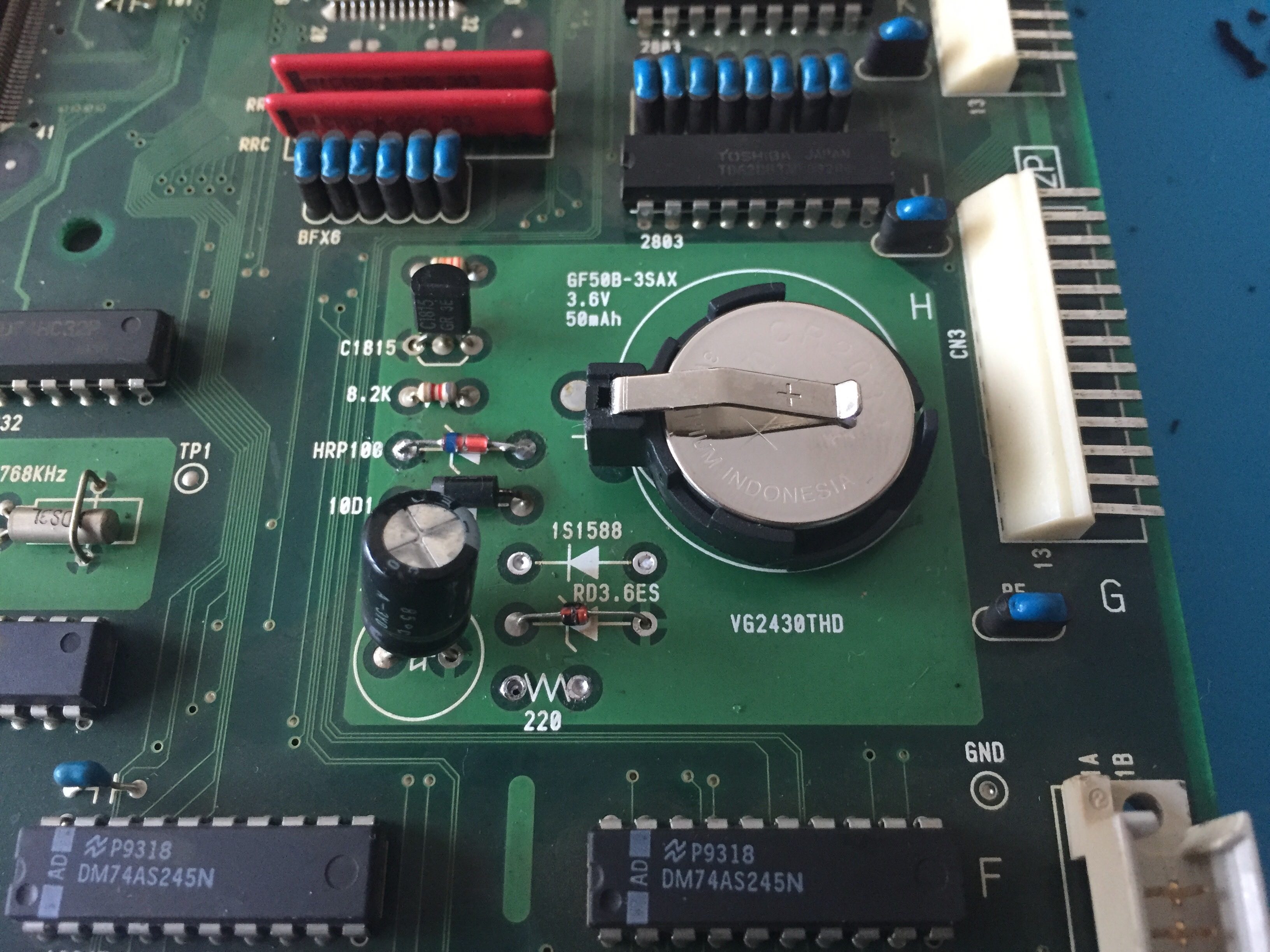

The onboard batterie works fine as far as I know. The time is correct and I can't remember when I set it up the last time.
6 slot MVS board with an UniBios 4.0 and currently no batterie installed:
  3. Loaded games have white artifacts (see first post)
6 slot MVS board with normal Bios and currently no batterie installed:
Issue summary:
  1. Sometimes the menu sound gets enabled even when I turned it off
  2. 4 slot board with UniBios: Multi cartridge starts not at the first try: after that it works fine!
  3. 6 slot board: Multi cartridge displays white artifacts in Multi menu and every game
  4. Some MVS cartridge does not work together with the Multi. I would say thats okay. Some of my cartridges are also a bit picky and don't like one or two other cartridges :-D
If you could help me with these issues it would be really really kind of you!!
Please check with a voltage meter, it may remember the time, but the contents could be corrupted.
I measured the voltage. It is 3V. Is this enough or should I replace it? Is there a reason that you store the menu config on the MVS board and not on the SD cart?

I replaced the battery of my 4 slot board with a battery holder and a brand new CR2032 from JNX I had laying around. I have an MV4FS slot board and followed the JNX tutorial. I looks like it works now, I tried it multiple times. I will keep an eye on it. The only strange thing, the menu counter is always 0...

In regards to your graphical issues be sure you're using the first slot with the other slots unoccupied first and be sure you clear your nvram when flashing games

I also tried your suggestion for my 6 slot board. No better results... I hope @Darksoft has any idea :-)
I have no better ideas for your 6 slot. Probably UNIBIOS is introducing a lot of delays and interruptions which are too much for the 6 slots.
I would avoid UNIBIOS 4.0 for now. Try 3.3 which should be OK.
