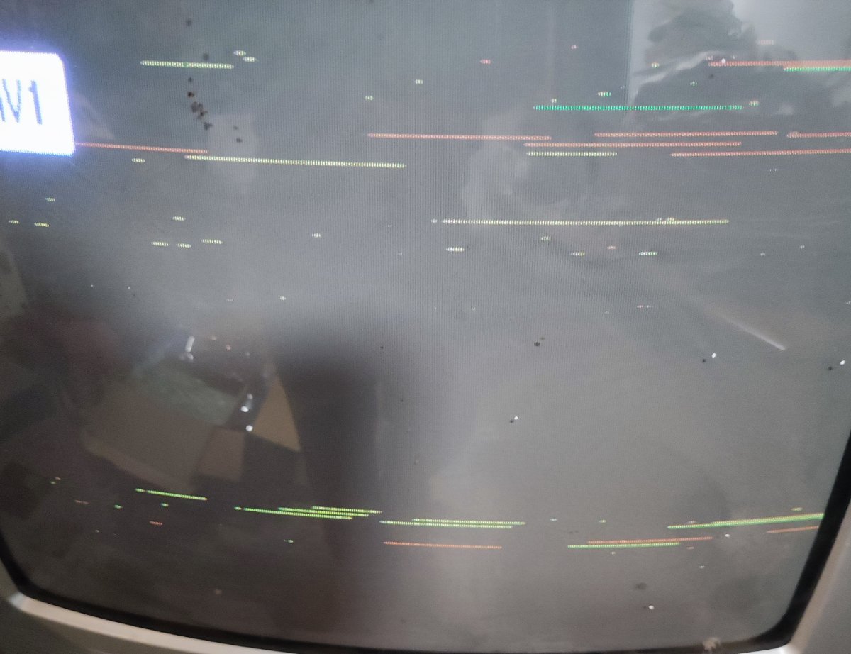

After power-on, the board displays a garbage/scrambled image (I’m attaching a picture). After a short time, the screen goes completely black.

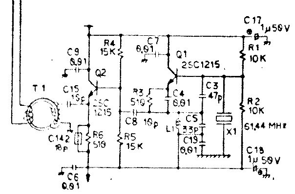

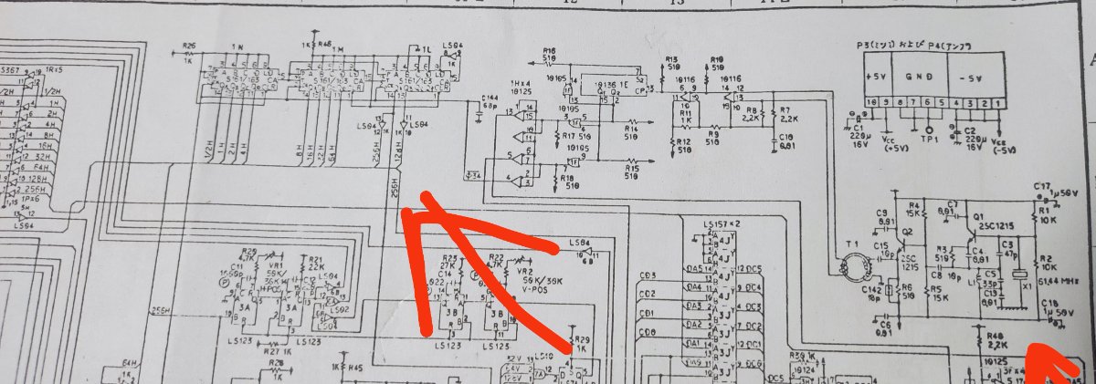

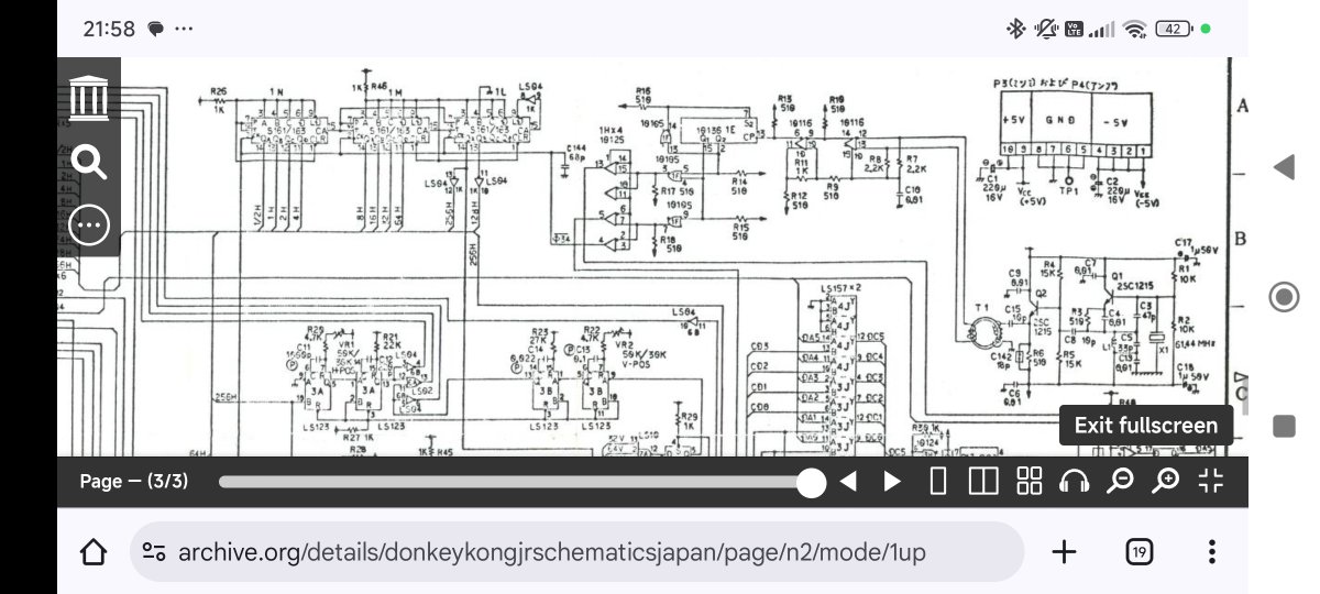

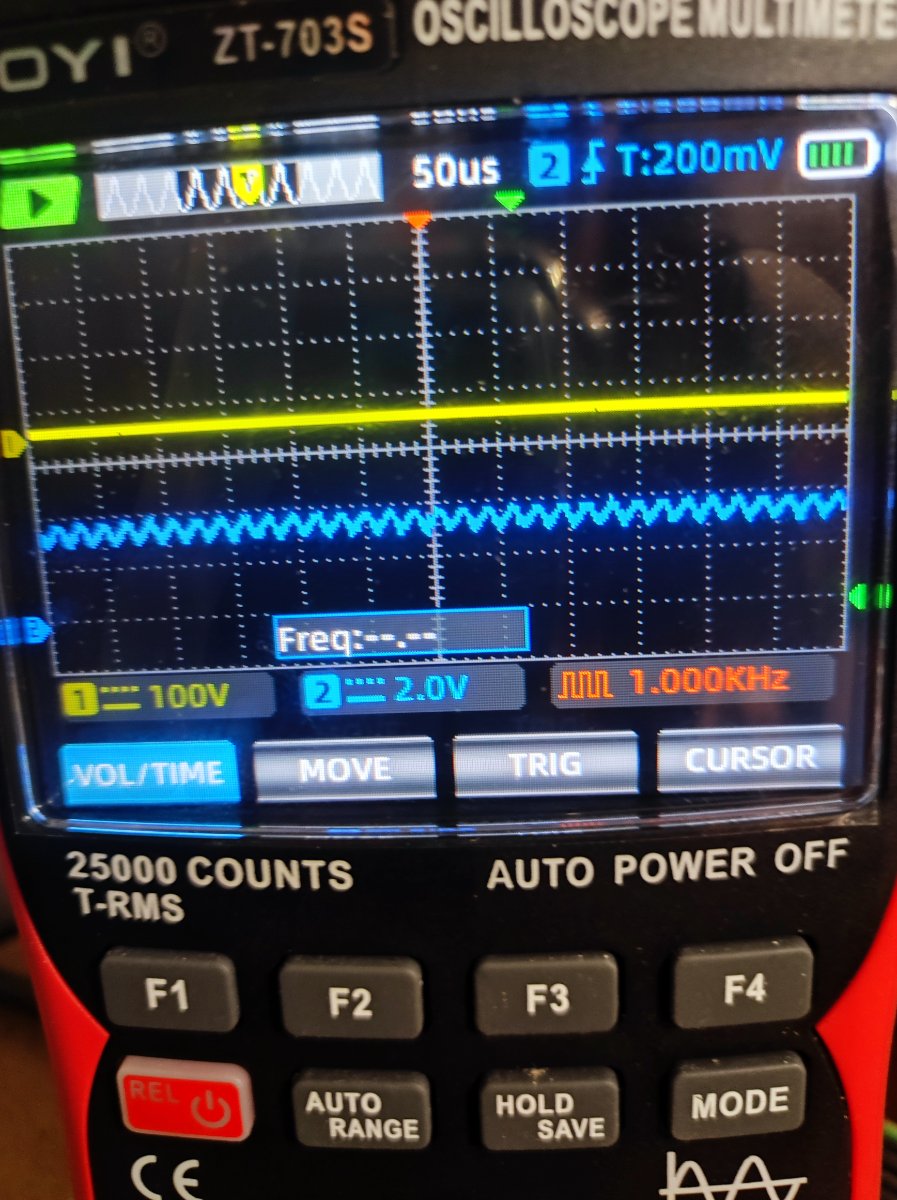

I located this section in the schematic, but I’m having trouble understanding this part of the circuit. I can see that there should be a clock signal on pin 2 of the 74LS163 IC, but I’m also seeing a strange signal there (I will attach a picture).
I’m not sure where would be the best starting point for further troubleshooting.

Do you actually see any activity like that screen that you showed is changing or do you hear any sounds if you insert a coin?

The picture and the inputs are completely dead, since the clock signal is not correct.

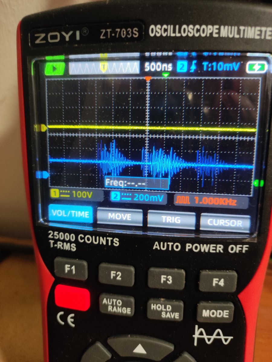

Z80pin6
The clock signal does not even reach pin 2 of the 74LS163.

then you should go backwards from that 74LS163 till the Crystal and see what is failing. I doubt it's a cap or resistor unless it's clearly damaged and rather a transistor or that 10136
There is signal on the transistors, but there is no signal at the T1 coil. There is also no signal on pins 12 and 13 of the 10116.

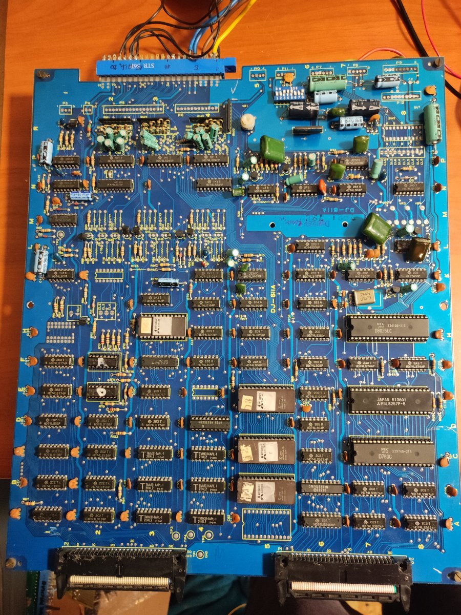

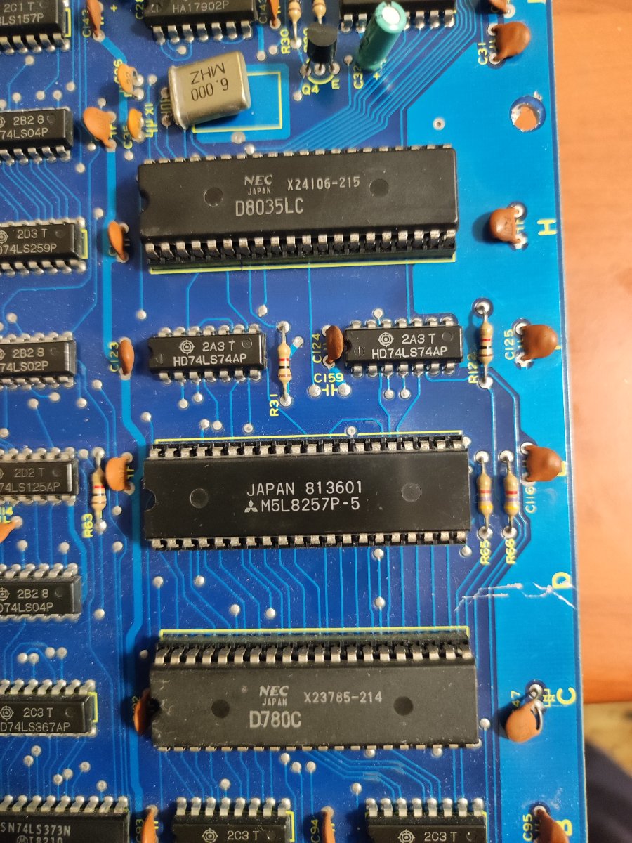

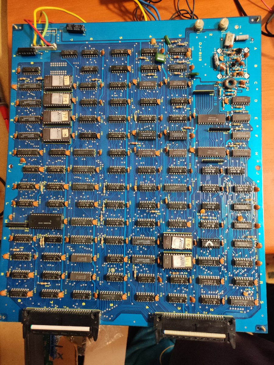

Please post photos of the PCB.

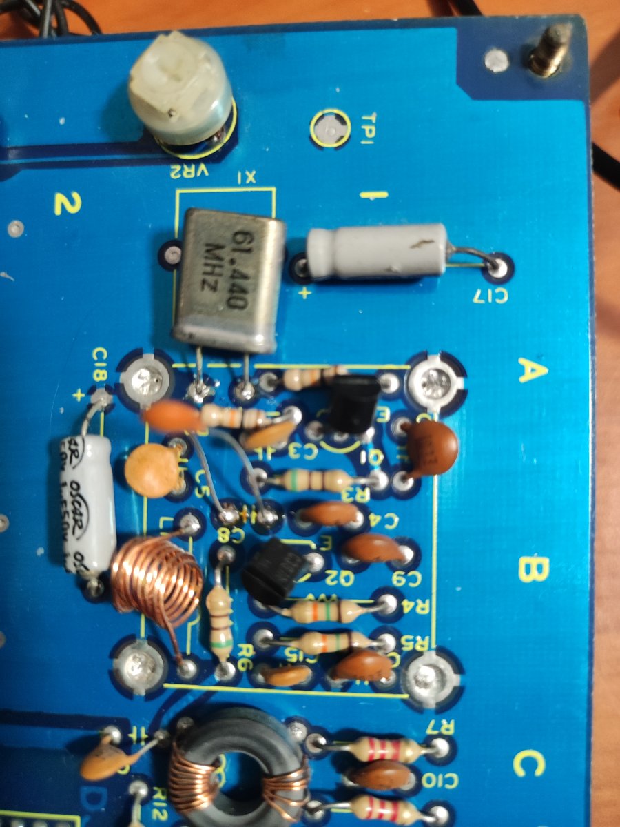

Hello. Thank you for your reply. I got a bit confused. I thought the 60 MHz crystal was for the CPU. Unfortunately, the PCB is not original. The 6 MHz crystal is on the upper PCB, where the CPU is located. I thought the 6 MHz crystal was for the sound section. There is still a problem on the -5V line. I will measure the voltages shortly after disconnecting the lower PCB.
