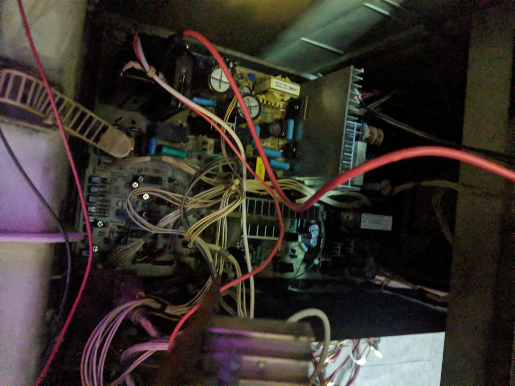

Just chiming in, Grant fixed x2 chassis for me as well both 7534's. One of the flybacks was dead and the other original was working but asked him to remove and replace with the substitute and keep the OG one preserved. This was in 2019 and the chassis are still running perfect, the cabs came from g60hot who was bringing cabs into the UK at the time.

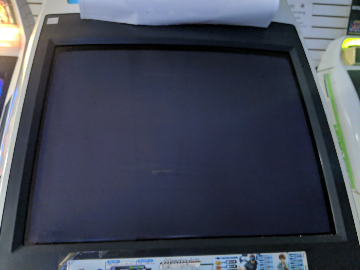

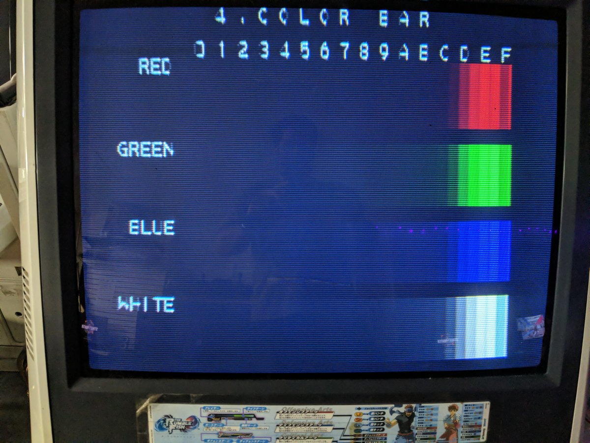

My PB-7534 turns on now but only shows no image.
Tricky times. I’ve experienced weird stuff where a 15Khz game will sync but a 31khz leaves me with a blank screen. This was on a 2931. I’ve also had perfectly good tubes not come on after weeks or months of just sitting there making me think chassis was broken. That was when it was a bit cold and high humidity. I put a hair dryer over the chassis and tube to get it all nice and warm and that got it going. I’m waiting for my 7534 to be repaired by a very experienced repair guy. If he gets it going I’ll do my best to report back to you what was going on.
the board I tried does both, I tried both 15 and 31khz with it to the same result.

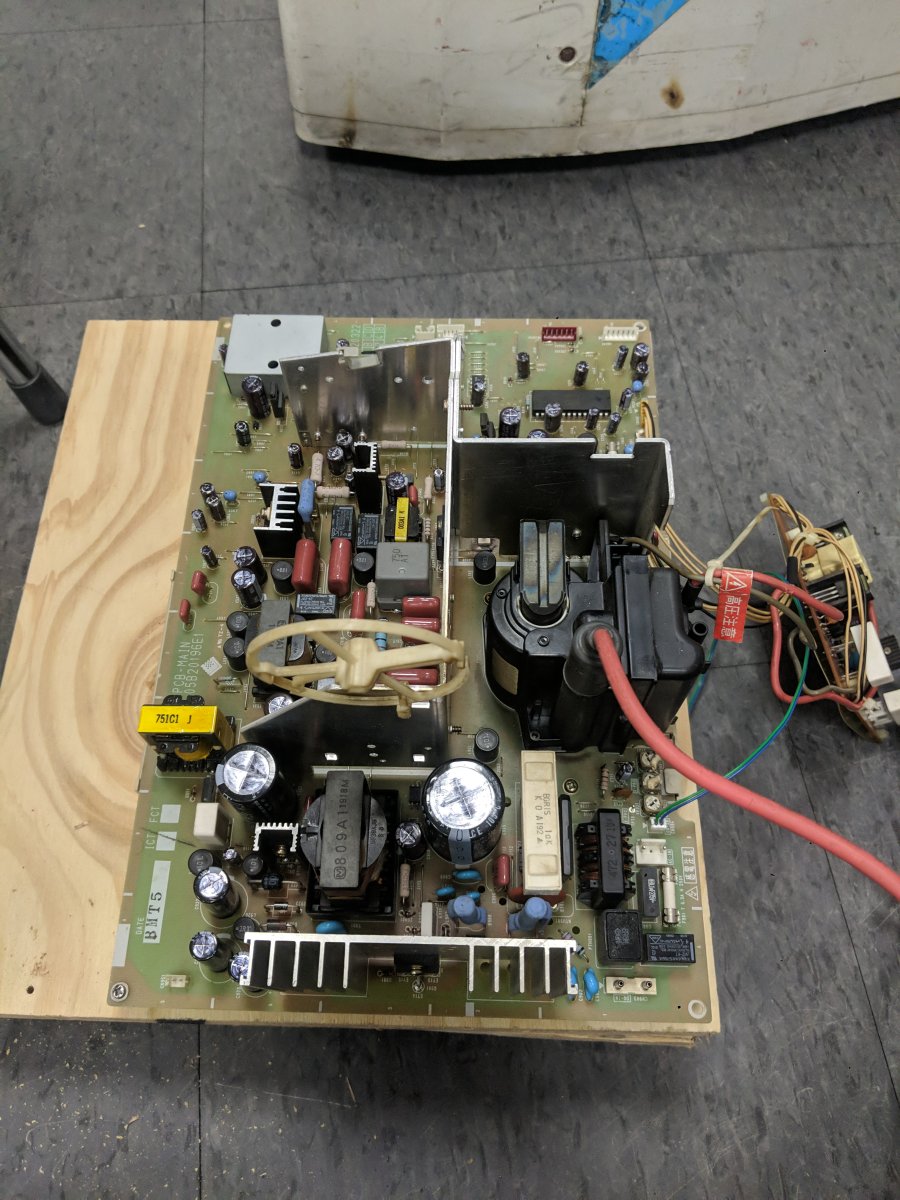

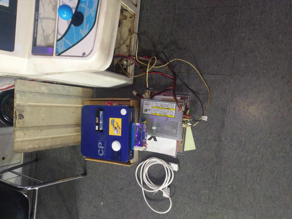

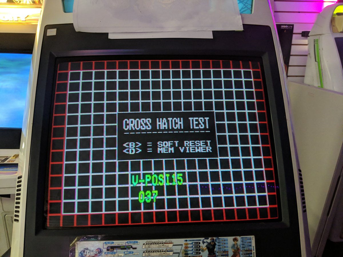

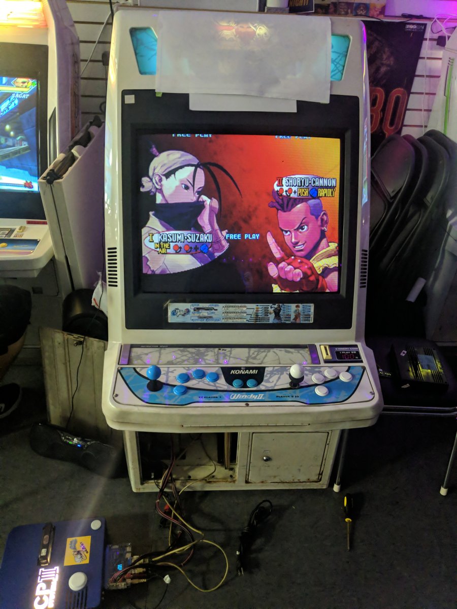

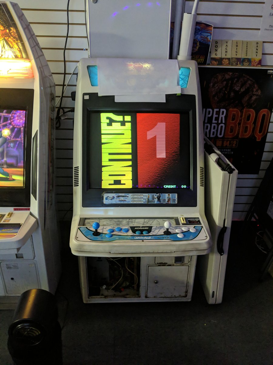

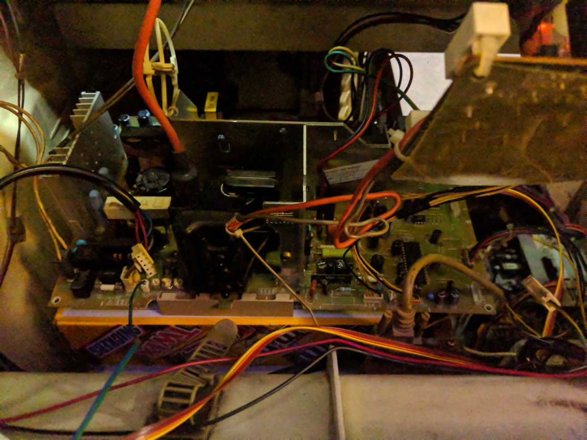

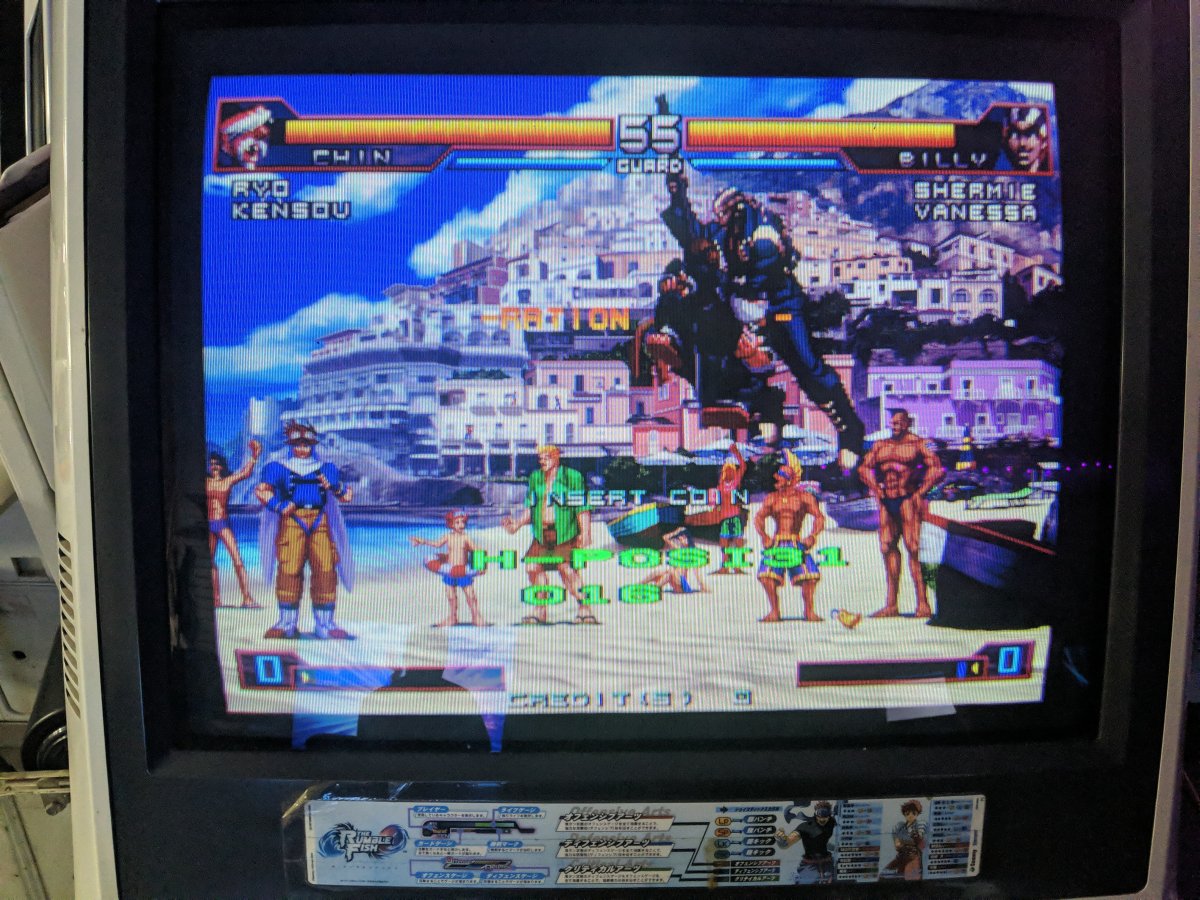

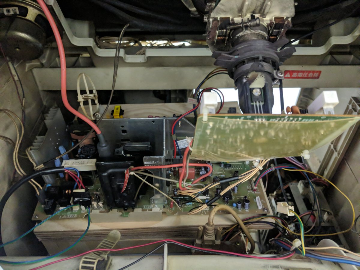

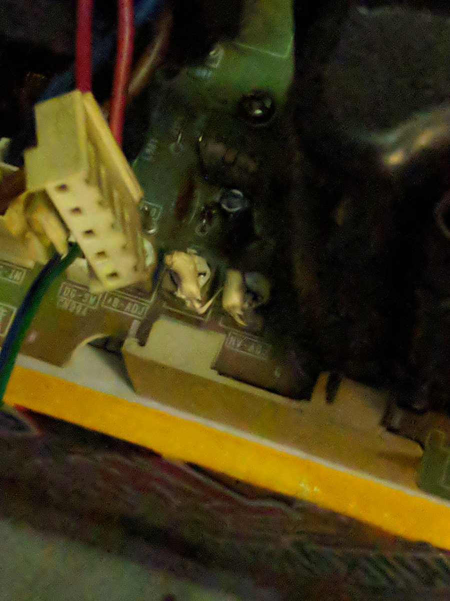

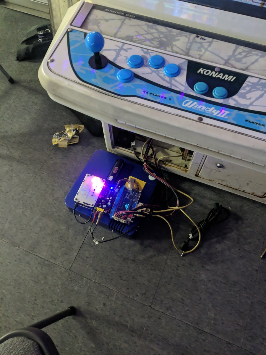

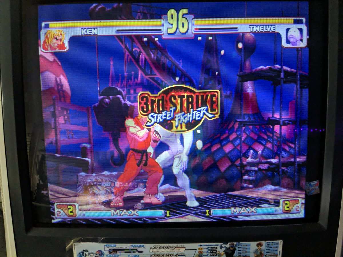

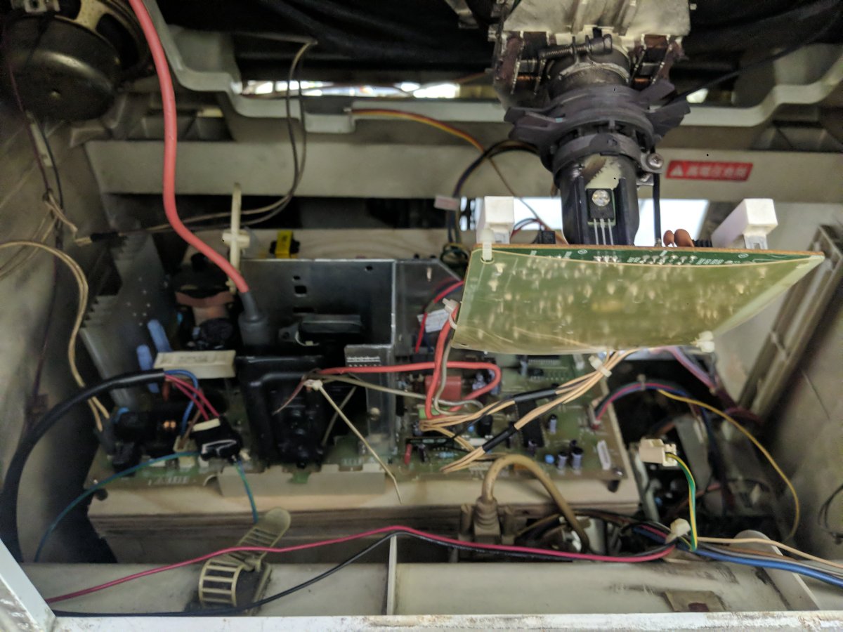

I finally set aside my pb-7534 after doing a bunch of work to it and getting it to turn on. I could not figure out the issue with contrast it was having, neither subcontrast or contrast pots do anything. I got a picture that only shows some of the colors. I decided to set it aside and install a 2933 a friend of mines brought me from Japan last year. I had to rebuild it cause it was labeled junk and had the horizontal yoke connector traces burnt. After a full recap and repair of the horizontal yoke connector traces it seems to be working. I had it raised of a box of M&Ms, I did not want to cut and splice wires. A buddy that works construction will build me a platform this coming week for me to permanently mount the 2933 chassis. I was able to test both 15 and 31khz and both looked great.

On the original pb-7534 I am still curious what could have caused the contrast not to work like that. I might take it home when I have time to look for any broken traces around the area. It's weird that neither the subcontrast pot on the neckboard or the contrast one on the remote board do anything.

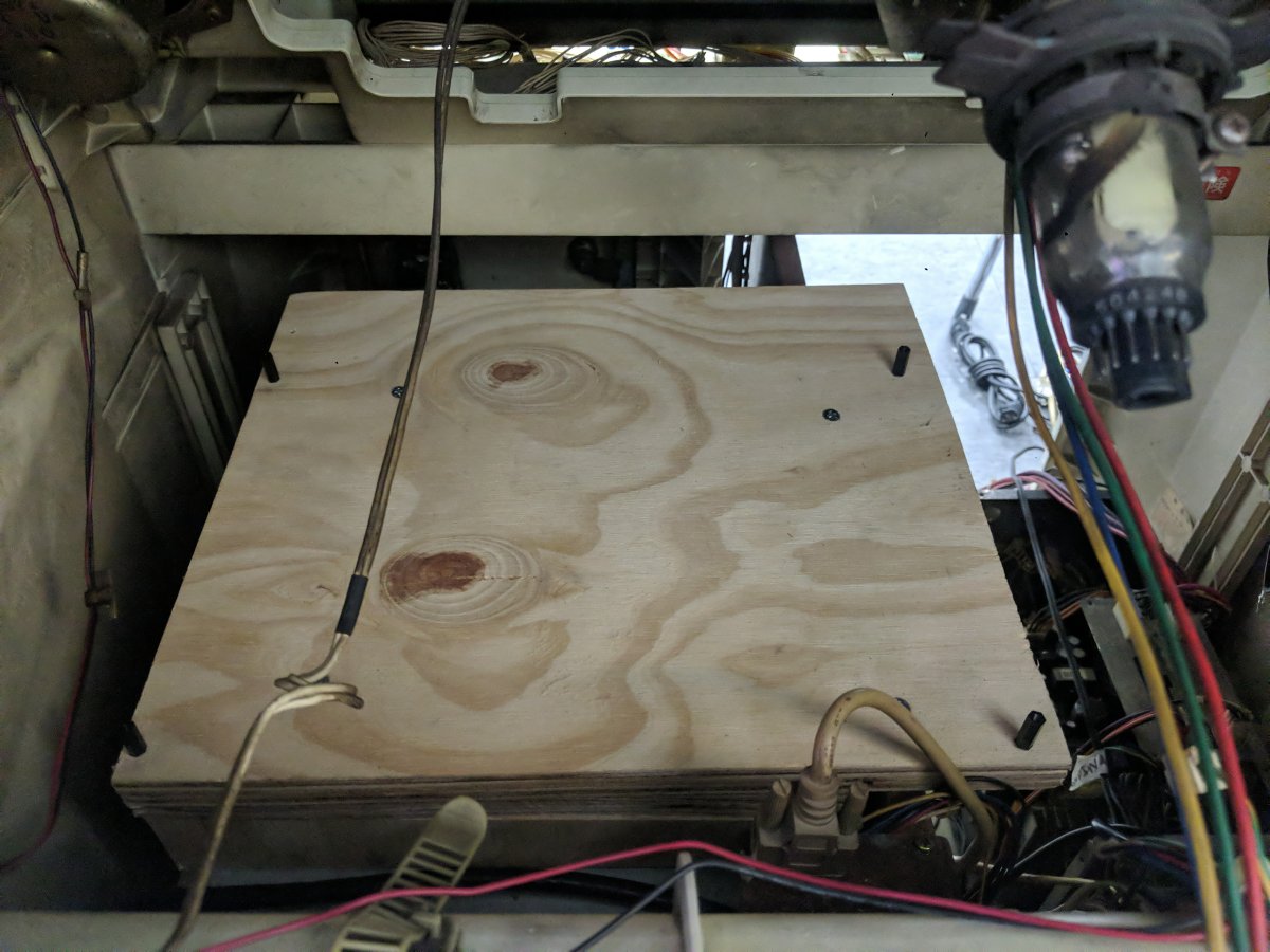

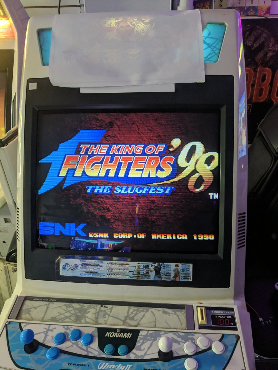

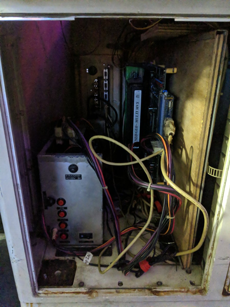

Met one of my homies that works construction Tuesday night, he made me a permanent riser for the MS-2933 out of wood. I used some hex risers to secure the chassis to it.
