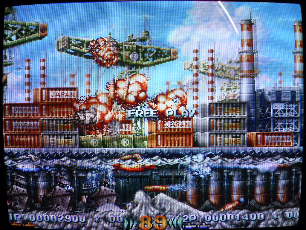

And what do you know, it works. Dialed in the colors and geometry and it looks absolutely stunning. Razor sharp and the colors really pop out. I attached a pic, but naturally it looks way better in real life. Got to love the MS8.

Nice work @nem. Is that using an ms8-26SU?
Madonna's are a little smaller then aero city cabs. MS8-25. I spent a lot of time dialing in mine and yeah it's absolutely stunning. What a beautiful monitor! Nice work @nem

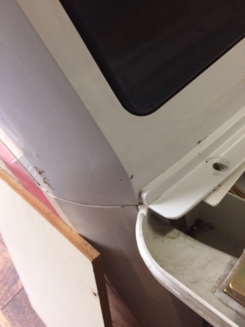

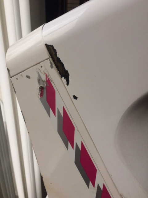

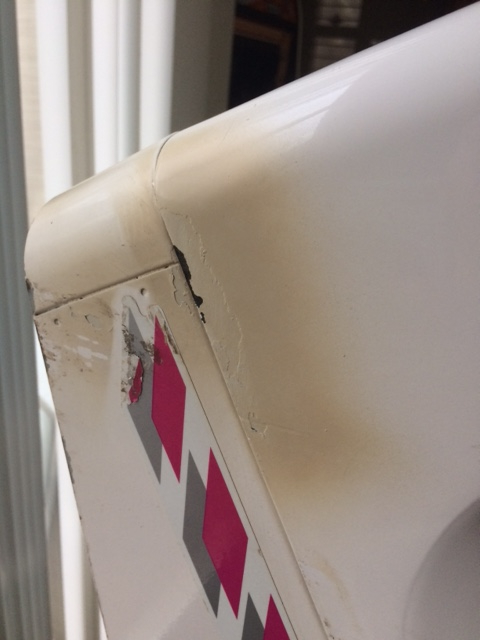

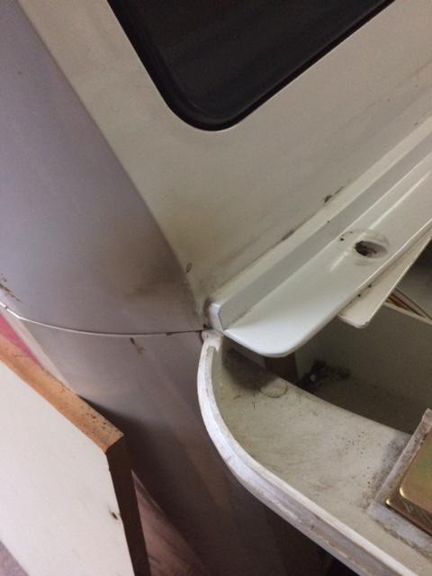

I hit the yellow spots on the Egret II with acetone too. Here are some pics:
Tools of the trade:
  1. The 100% pure acetone sold at Walmart for $2.48 a bottle
  2. Some left over napkins from some fried chicken joint
This stuff is pretty caustic and I have seen it melt plastic. Don't apply directly to the cab. Use some sort of applicator and keep it localized to the area you are attacking. Once off, make sure you remove any residue as it will keep active until it is removed. I used a sponge and dish soap to scrub the spot. Napkins to remove the soap.
