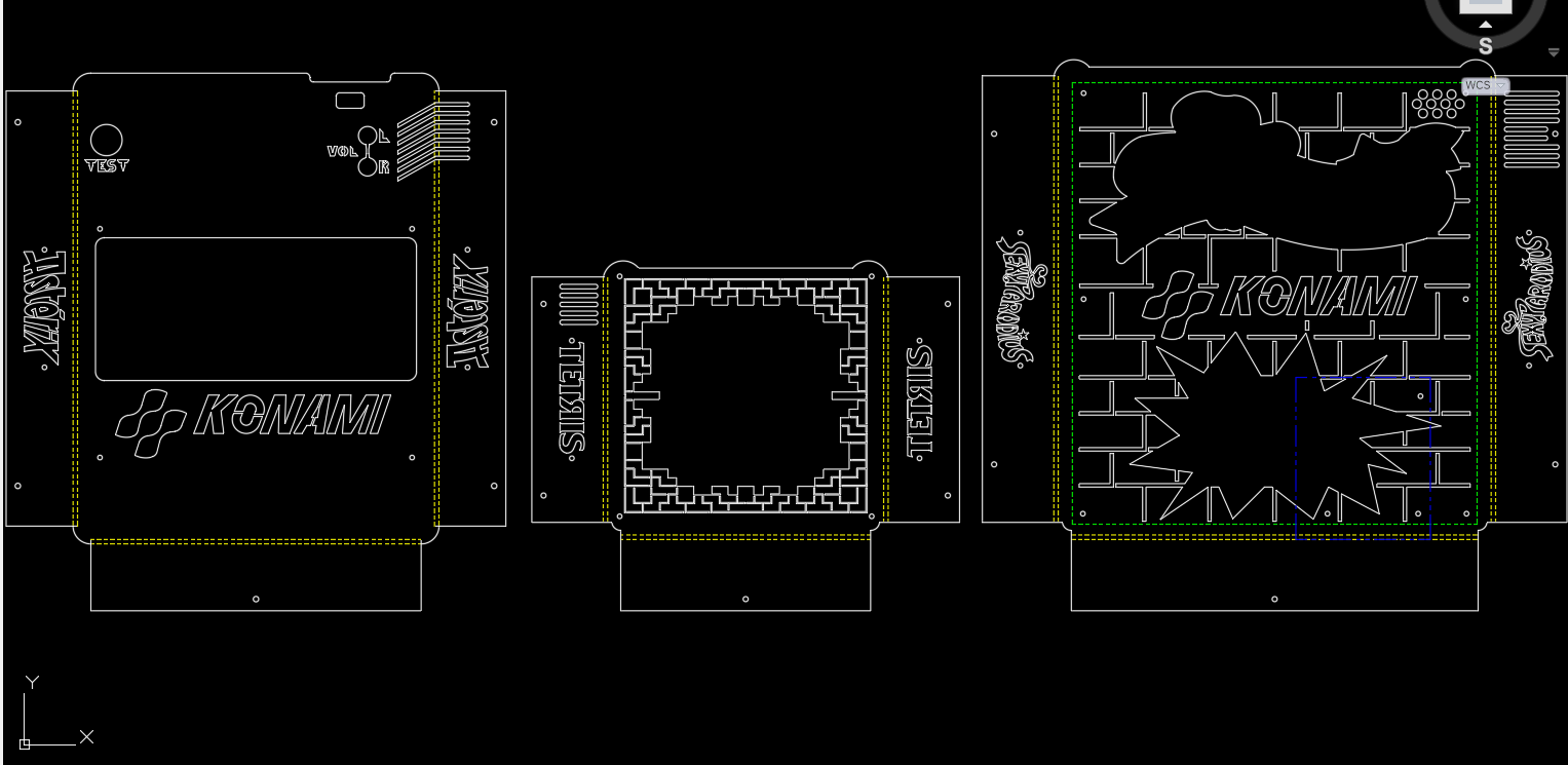

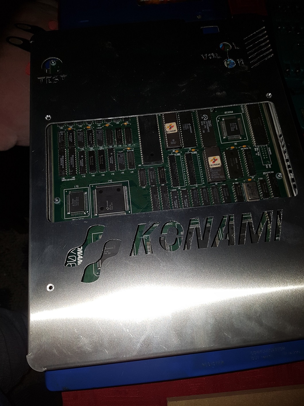

as for new update !
yes, proto is almost finished.
i only need to send it for paint / get my vynil and it's done.
i ran into a couple of small problems that i will take care on the next ones.
-I had to put washers to cover up the holes i messed up :P . It works for the proto.. Ill correct the case to have the holes corrected so i can put flush head screw (like my previous .125' case)
-put one of the astérix engraving (left side of the case) to be read correctly (sigh*)
-Change the hole + R on the top part...its a bit off center when you put in the PCB
and i guess that's pretty much it.
Next friday i should have the final look to show.

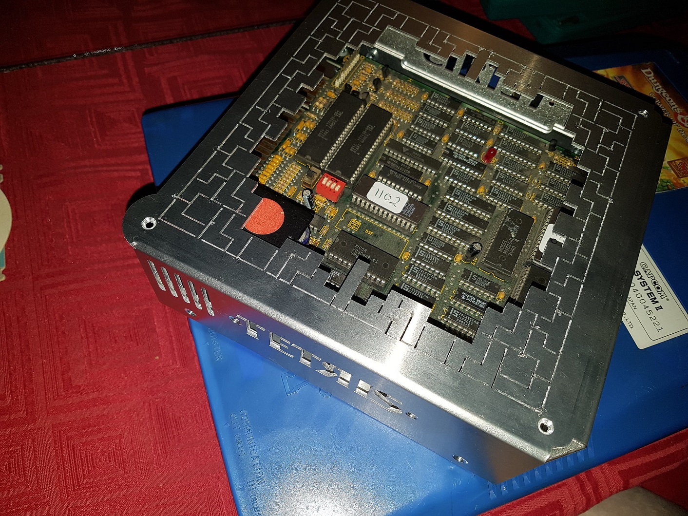

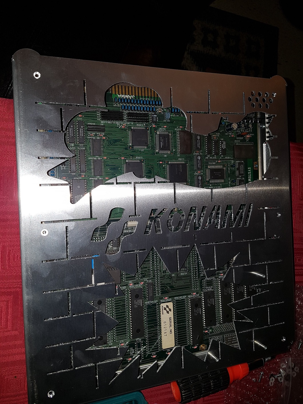

Ok now my new proto are done...only have to
-test if each pcb fits in rightfully.
-make the Vynils stickers
-Get the right screws (i'll have them by the end of the day)
-Paint job !
-Test for 2-3 hours if heat issues. i dont want to send stuff that might break your lovely pcbs
but here's what it looks like !
*i did forgot a square hole to be able to pass the stereo cable, if someone wants such a case in the futur ill make the update**

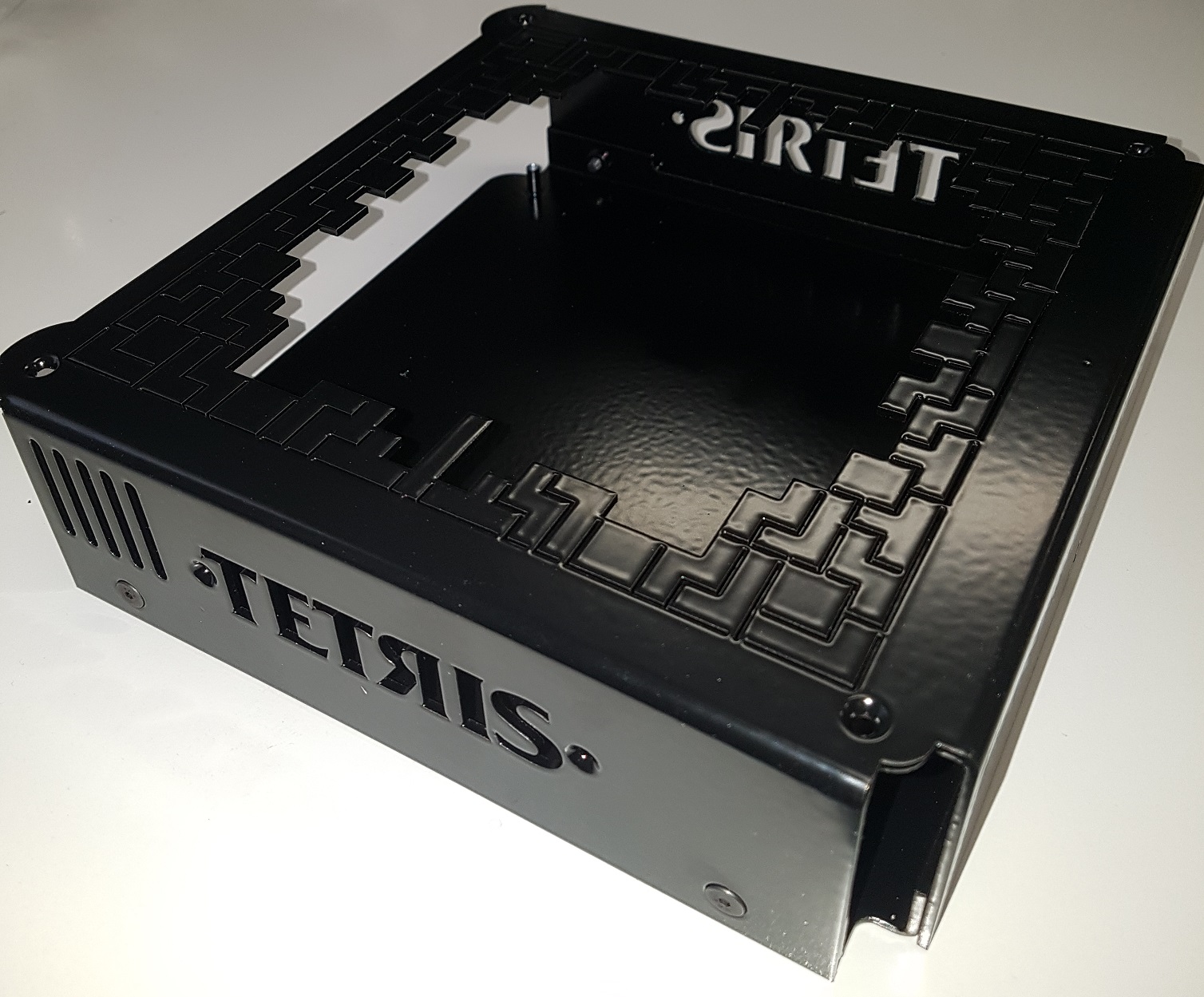

It's almost finish !
i do have some works to do for the pictures...
i trying to correct an old Sexy parodius picture i wanted to use
but have to take care of all the japanese text and stuff.. + no hd of this picture
so i'm working at best i can so it ends up looking great (not all blurry)
anyway...paint is done !

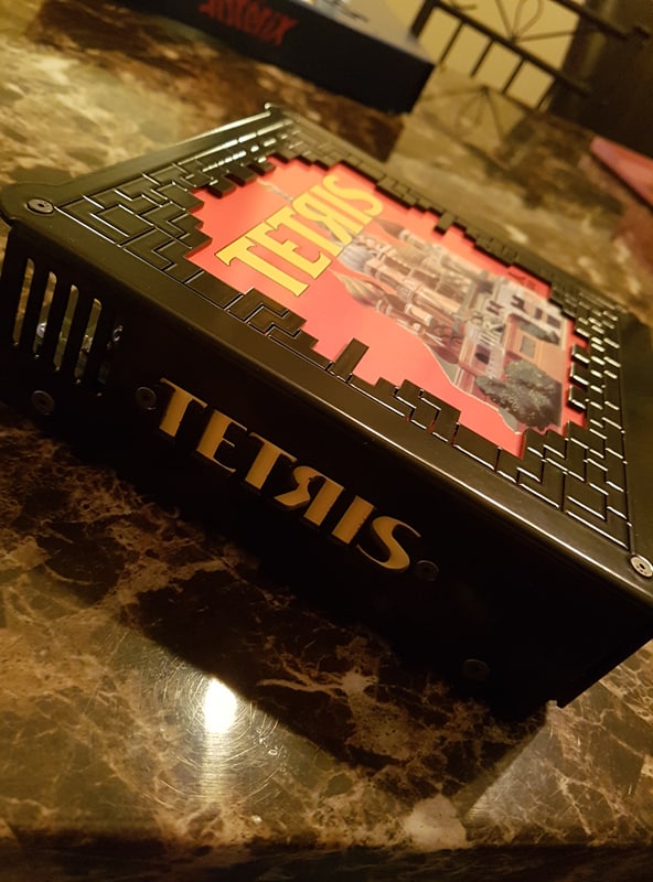

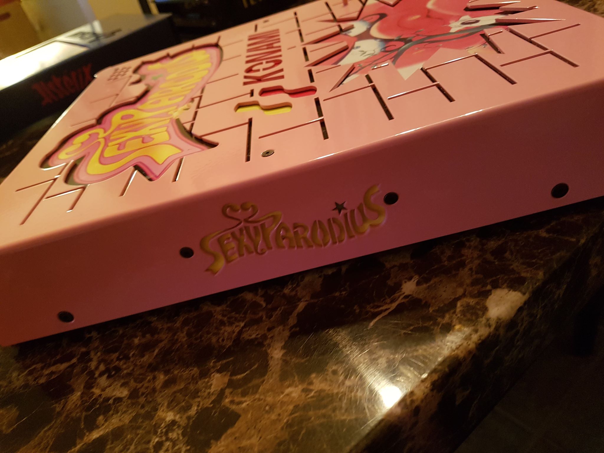

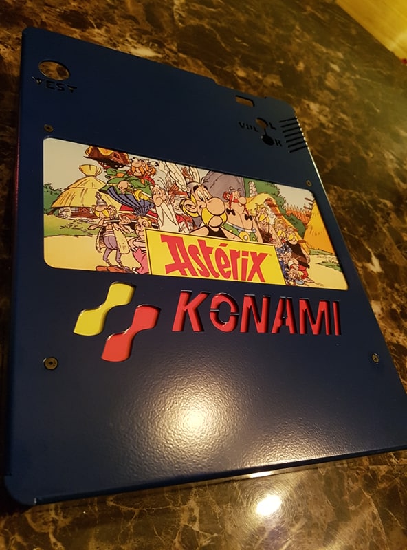

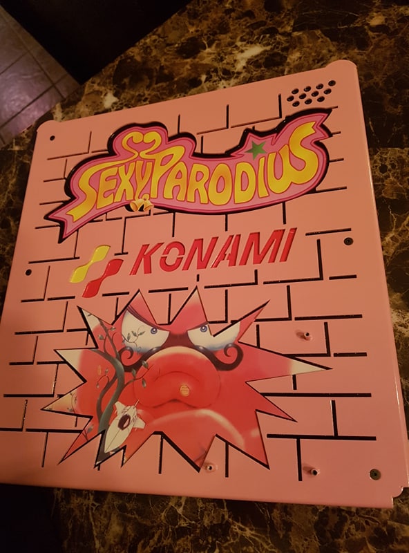

annnnnd here's the finish product for both Tetris And astérix cases.
Sexy parodius is missing a piece....something went wrong with a vinyl so ill update a new picture tomorrow :)
what you think ? the new names on the side really get the case to a better level to my eye :)
can't wait to have them all in cases.
