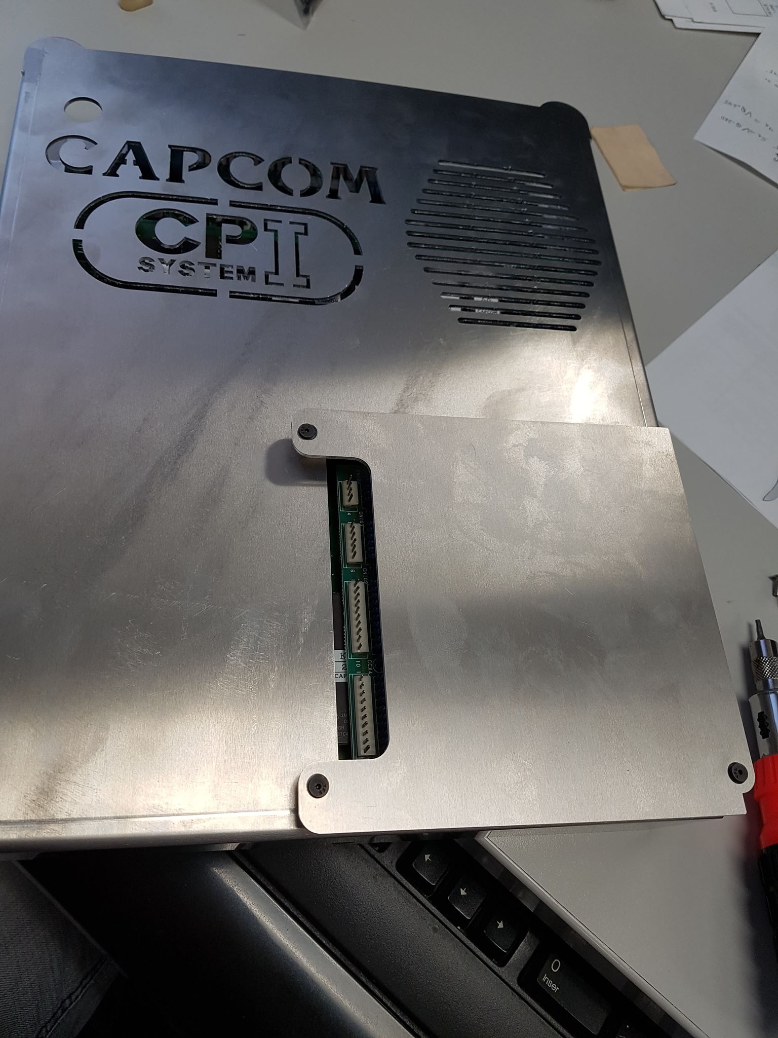

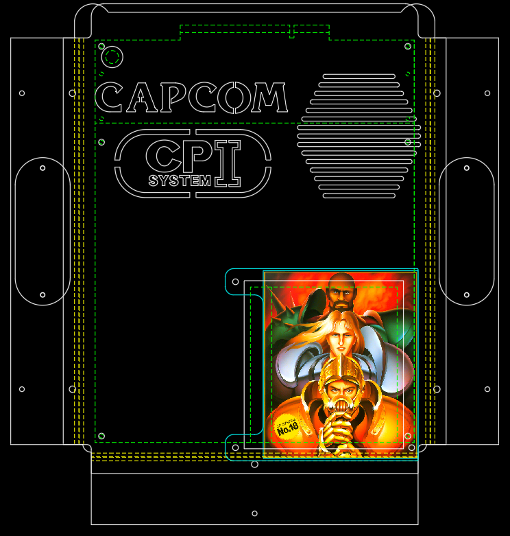

Yes we do have a few different type of B-boards, which is why I think you should steer clear of mounting holes for them.I noticed that some B-Boards are longer some are shorter.

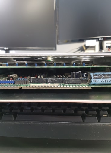

you have a picture of those connectors ?Make mounting holes to accommodate for the different A boards, and have enough height/clearance for the different connectors that can attached to the B or C board, plus DS multi and undamned infinkey setup.
I agree, i'm thinking it would be better like that.Yes we do have a few different type of B-boards, which is why I think you should steer clear of mounting holes for them.If the A-board is mounted completely/securely the B & C will be quite secure I'm sure of it (many many machines mounted only the A-board to plywood vertically inside the cab).I noticed that some B-Boards are longer some are shorter.
Might also aid in switching B & C boards to only have the A mounted, not to mention potentially support the DS multi assuming repo B is no larger than stock B.
Well the multi has integrated the C-board... So that part of the case wouldn't really be needed, assuming the board is the same height as stock B-board.is there any concern about the pending multi fitting? Regardless this is a sexy beast and I am also excited

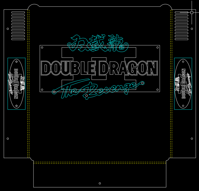

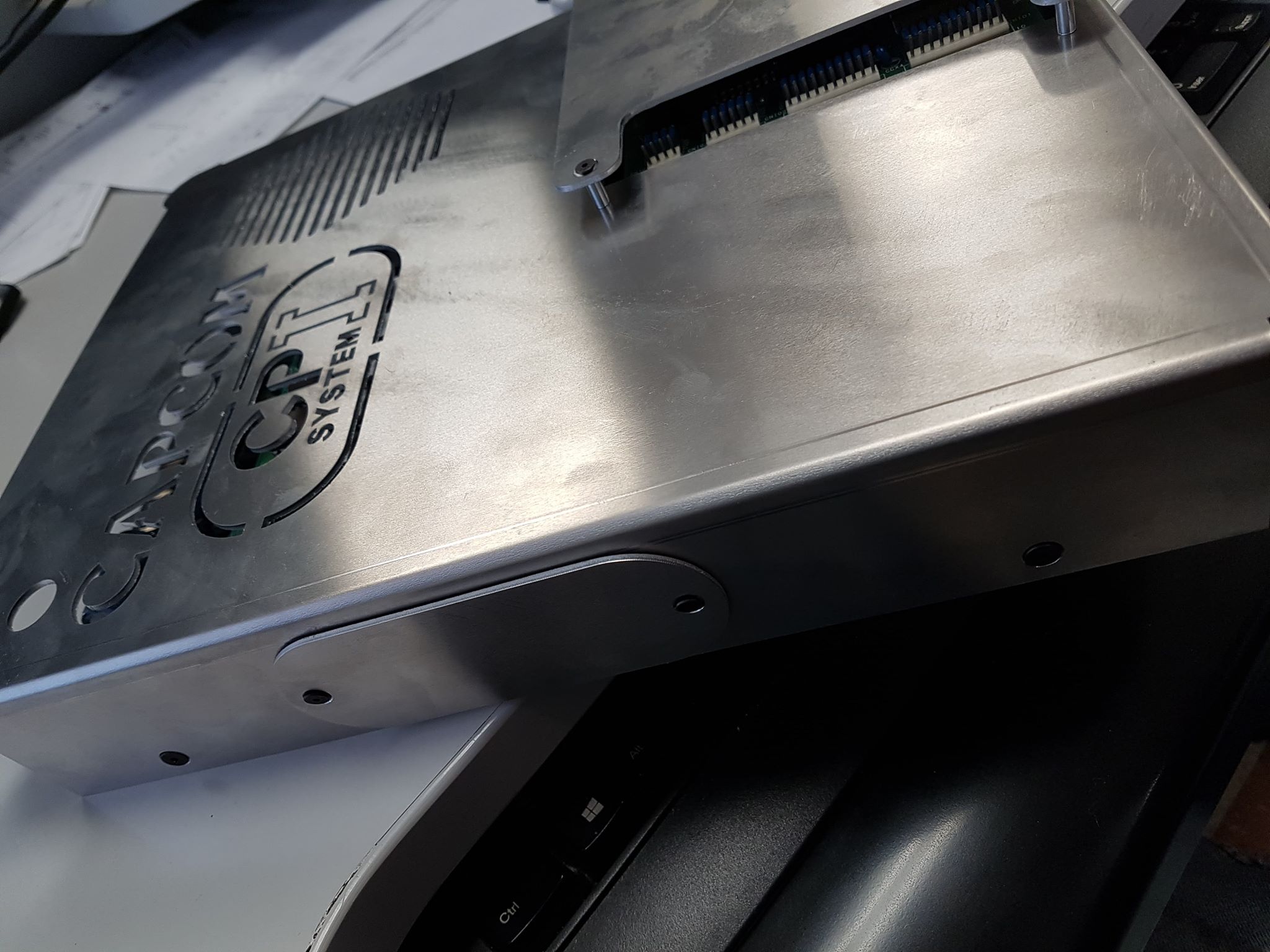

A friend told me the exact same thing hahaI think the label would be better slightly smaller than the plate and with rounded edges.
Sloppy mock-up...
Other than this one minor criticism I'm onboard to order/purchase one.![]()
