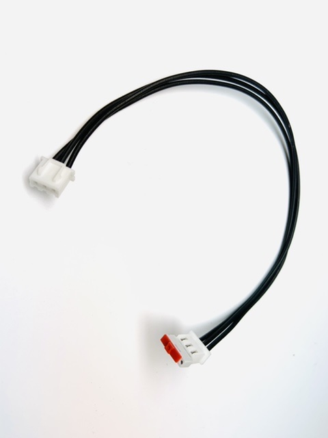

Here is a parts list. This would require no soldering or crimping. Simply plug the pre-crimped wires into the connector housings, matching pins 1 to 1, 2 to 2, 3 to 3. Then plug the switch into the harness and the other end of harness onto JP3 in place of the jumper. You could double-side tape or hot glue the switch to anywhere convenient.

This would make something similar to this:
Just for reference this switch is only really needed if you have the Lions case on your F3 because it blocks access to the jumper. If you don't have the lions case it's mostly unnecessary.
on my F3 LCD holder it's tight but still manageable to get to the jumper. and of course if you have neither it just means you can flip the switch instead of using a jumper
Thanks @twistedsymphony this is 100% correct. It’s simply to allow access for those with cases. This is not adding functionality, just convenience.
