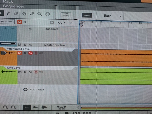

I’ve capture some audio for comparison (Elevator Action track 1CC). You can listen here:
https://m.soundcloud.com/everten2/sets/taito-f3-audio
There are 3 tracks.
  1. Line level
  2. Attenuated level
  3. Line level raised to match attenuated level (this is quality comparison)
I’ve got the levels in a good place now. Someone who knows better can chime in about the resistor values I ended up with and if it’s acceptable. I tested several and this produced best results.
Levels compared:

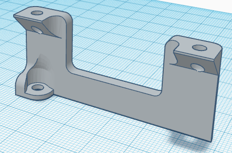

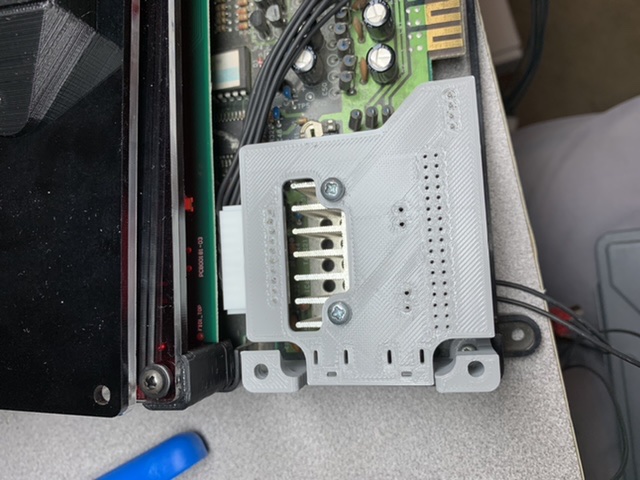

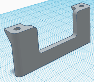

I’m experimenting with cramming the kick harness in ( @djsheep and @BroadwayJose) It would require a custom left riser for anyone with the lions case. I printed one up to test it out, I only have grey filament at the moment. The rca jacks would be on the side like STV board.

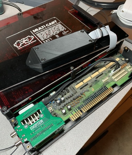

The form factor will likely resemble the picture below. There will be a jumper harness to bring the AA connector to the PCB and out to a CPS2 connector. The harness comes very close to the game board, but I think it will work. There’s really not much room for it to be anywhere else.
Feedback welcome.

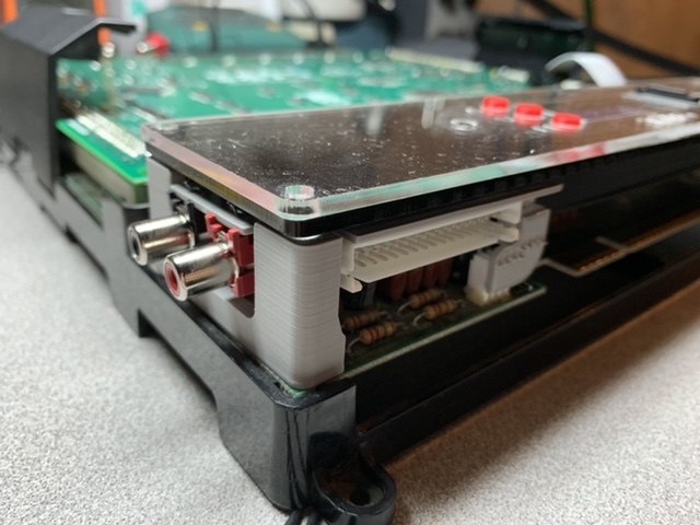

For those with the Lions case, I think I've finalized the custom side bracket needed to fit the PCB. I will provide the STL file to print yourself. If you can't print yourself I'll offer it as an option.
I'll most likely need to use that print option for the Lions3 case.

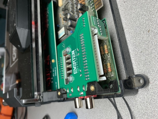

Didn’t have time to test yet, but some boards arrived. The fit is good. See pics above.
