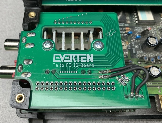

I received the board from @everten. Here are my initial thoughts:
  • The install is pretty easy. It took me two tries to get the mounting/grounding screws all the way into the heatsink.
  • The little audio connector PCB is adorable and lines up perfectly.
  • The kick harness cable is pretty stiff. It fits for sure. But I think a higher gauge wire would work better.
  • The audio output just works. 100% plug and play.

Thanks @the Goat
Threading the screws is a little challenging. I'm exploring alternate options. Worst case it will remain as-is, but I can include 2 x sacrificial screws. You can also tap the thread if you have the tools.
The wire I use is high temp rated and abrasion resistant. I prefer it over cheap wire and like that it is a little stiff and will hold its shape. Unfortunately 22 gauge is the highest from this particular company. I'm open to other options if people have some good wire recommendations.
I've received some other feedback on possible ways to improve the audio circuit which I'm exploring.
The wire struck me as a bit stiff also, but I'd personally prefer that for something that should be living on the PCB and shouldn't be moving.
are you crimping this yourself or are you buying pre-crimped leads?
My complaint about the wire stiffness is quite minor. And it is a non-issue once it is installed.
I guess I was beaten to the punch a bit on this review. I spent a little more time with the mod hoping I'd find some nice nugget of extra perspective, but I really don't have much else to add. Great fit. Easy install. I had no issues with the sacrificial screw, and it fits great on the amp. I also noted that the harness wires were stiff, but that doesn't actually harm anything.
How's the sound? The sound is great! Clean and loud; had zero issues making it sound good in my blast city. Kicks, uh, worked.

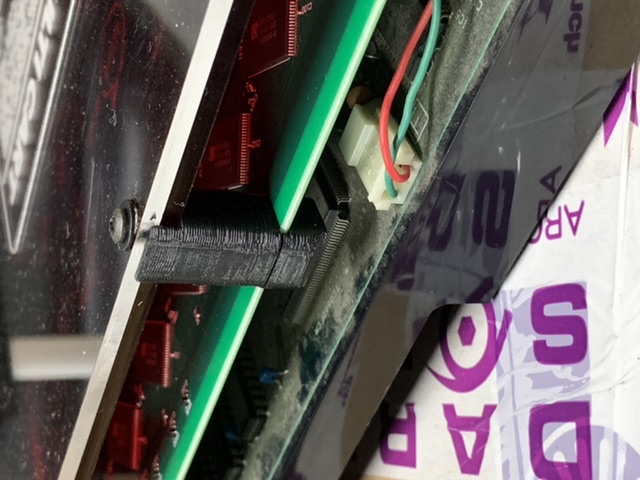

My mod does use the lions3 gear, and I'm very happy with it all right now. Only thing I think would be better is running the reset wire into an unused pin on a connector, but I wasn't feeling up to it this time 'round.
@ekorz - also, I think your Lions case might be installed wrong? I'm pretty sure those black 3D printed tabs go under the board not on top of the acrylic.
I messed up the second half of the F3 case install too. His UMK3 and PGM were obvious enough, and IIRC the F3 motherboard/selector case came with instructions, but the board case was just confusing enough to throw me at first.
