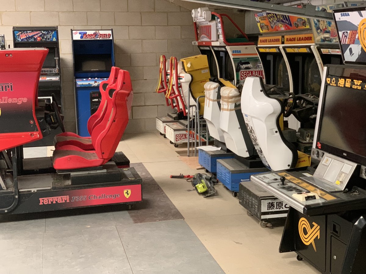

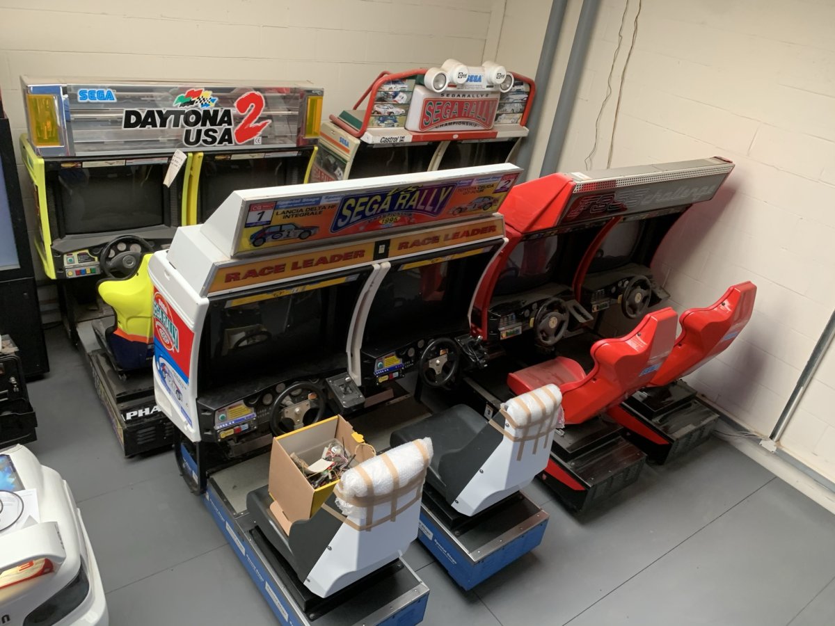

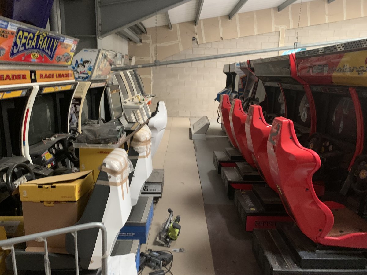

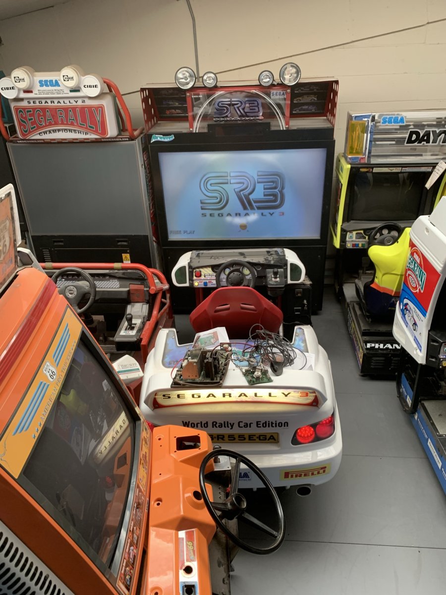

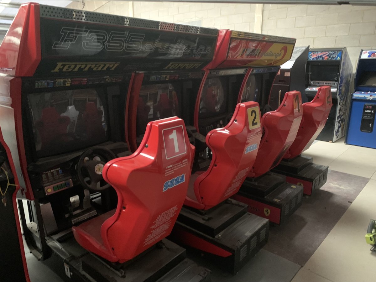

And just to share…. My racing cabs
With like minded people.
I’ve just grabbed photos from my library it is same cabs moving about!! Not 20 of the same thing🤪
