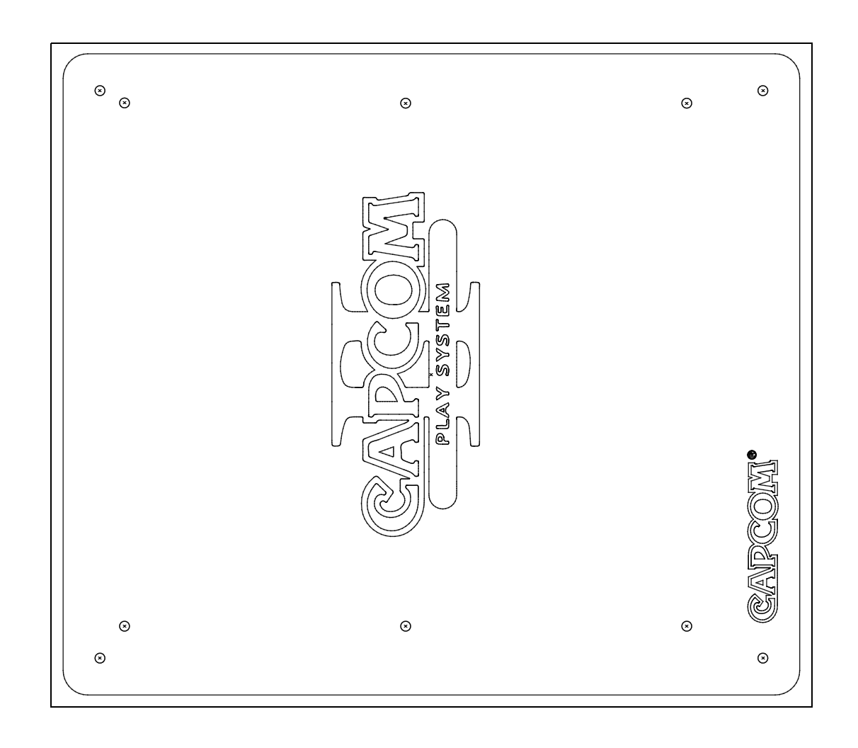

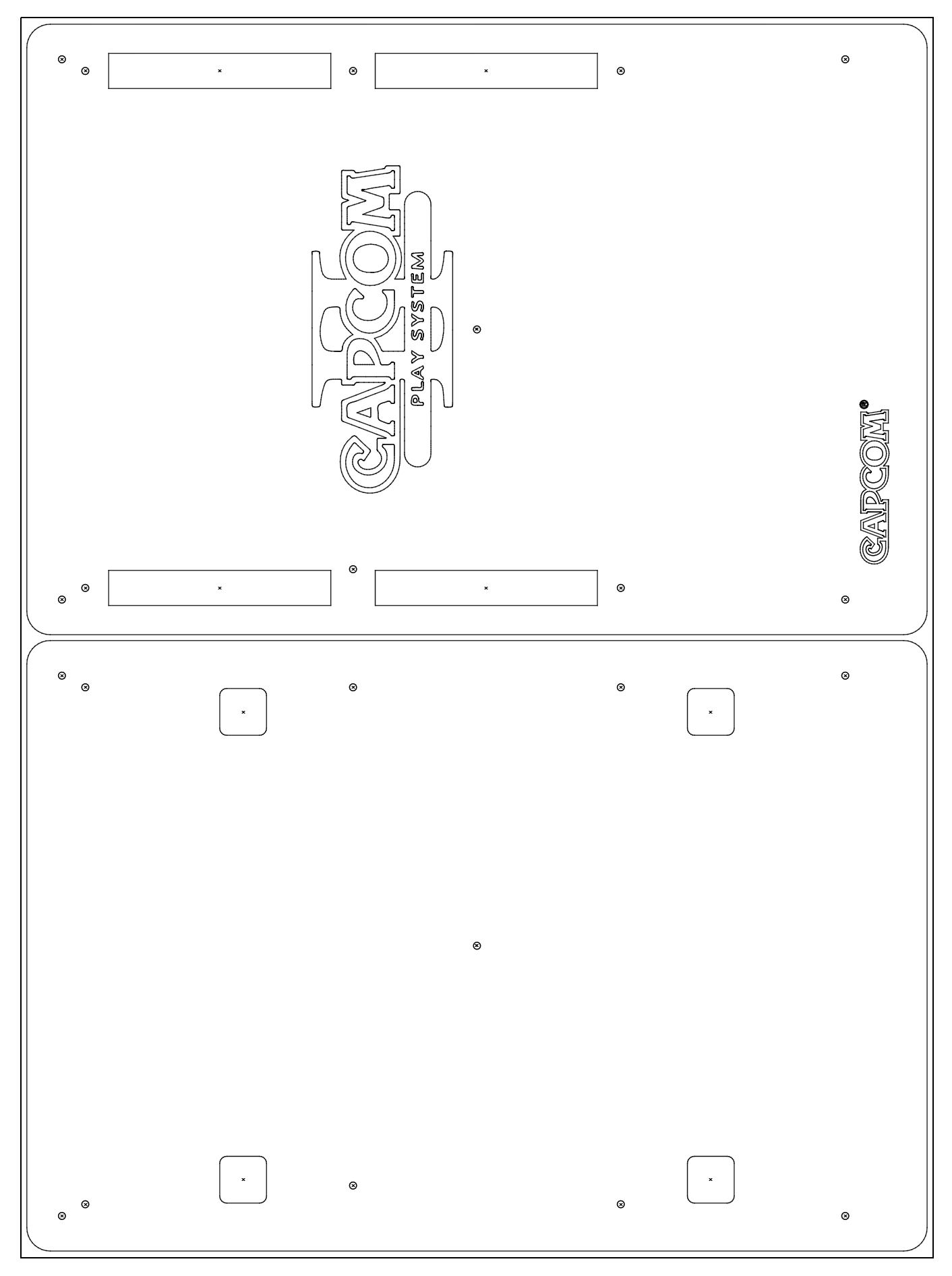

@Yami I just added a CPS2 design of 3 pieces: 2 for the A board, and 1 for the B (game) board. Let me know what you think. I attach the pictures here, you can find the files on https://github.com/emilianoarlettaz/arcade-pcb-case/tree/master/boards/capcom_cps_2

<p>
It’s the USA version, it’s okay though you don’t have to go crazy trying to figure it out for my sake if it’s a pain since our boards are different. When you create these, how do you figure out how to place the holes? Pick a size for the acrylic and the measure in?

@GamingDoyle don't worry, just post pictures of the board when have some time. I have other games with USA version and many share the same B board, so it can be done.

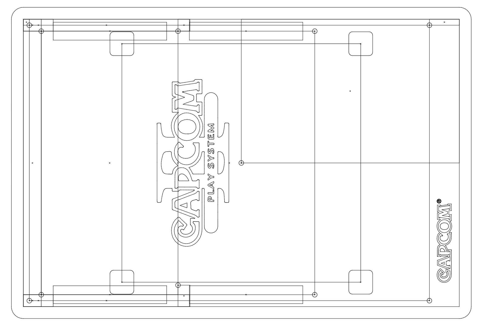

Regarding the process, I start measuring the board outline and trace a rectangle to work from that. Then I create several auxiliar rectangles to position the holes. After all is in place, I just delete all auxiliar rectangles and left the holes and stuff. See the attached image for the CPS2

So the entire SFII board (the A board on the bottom of the stack) is 24cm x 30cm (not including the jamma connector)
If I measure the distance from the center of the holes on the edges its 23cm x 29cm

@Telpherion Just a quick question : what's the purpose of these 4 square holes in every bottom plate ?
I was thinking in some kind of hang on the boards inside the cabinet, and being able to exchange quickly games with these cases. So inside the cabinet, on one side put 4 clips or something like that, so you can just hang the board there and connect the jamma harness. They are all the same size in all boards and are centered.
