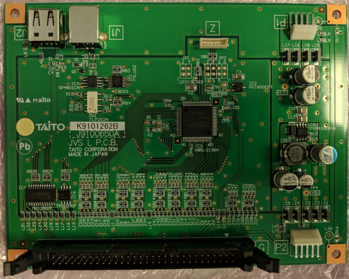

That IO is unknown to me (it looks like a more compact version of the USB IO).
USB IO first appearing with the SF5 control panels/for location tests in Japan.
The Z connector however has been included on a few different IO PCBs.
Notice it at the top of this JVS (version 2) "L PCB" IO below.

The Gamepad Joint PCB is not an IO
Technically speaking ANYHTING that takes raw inputs and encodes them into a compressed/digital signal IS an INPUT OUTPUT board.
I do understand what you are saying.
No you are correct but I don’t want to confuse people it’s almost like a secondary IO. And requires power from a primary cabinet IO. You are right.
