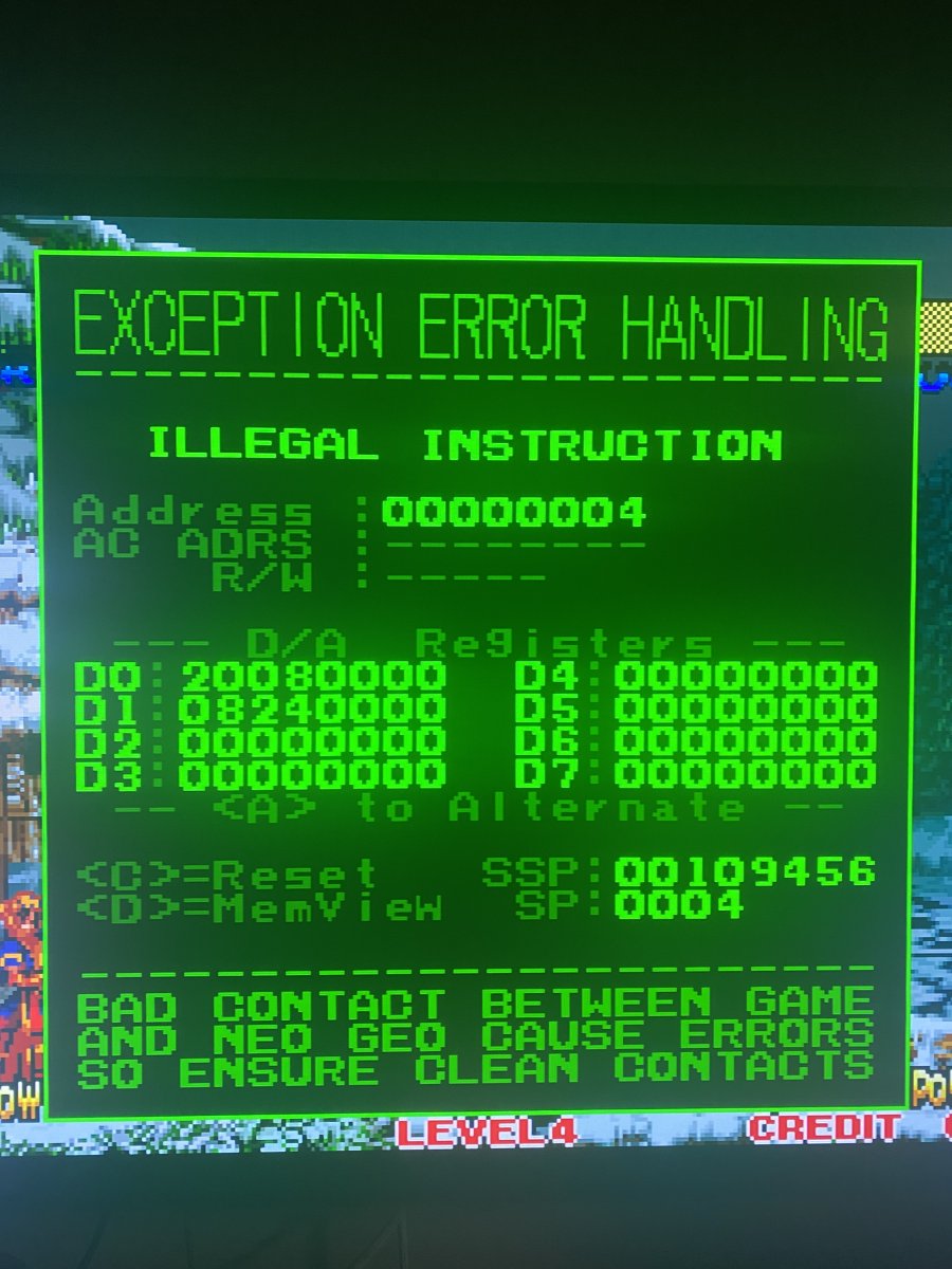

I finally had a chance to try out SamSho 3 and World Heroes 2 on my AES cart. I’m using UniBIOS 4.0 and the latest firmware & menu.
SamSho 3 does indeed crash for me as well-it usually happens after about 3 matches. Screenshot of the crash & debug info is below if that’s helpful @Darksoft .
World Heroes 2 wouldn’t crash for me-I played it for over 30 minutes without issues. I rebooted the console, flashed the game to a different slot, and played for another 15 minutes without problems.
However, I did discover that if I went into the UniBIOS and did a CRC check on this game then the console would go into a infinite crash and reboot loop.
