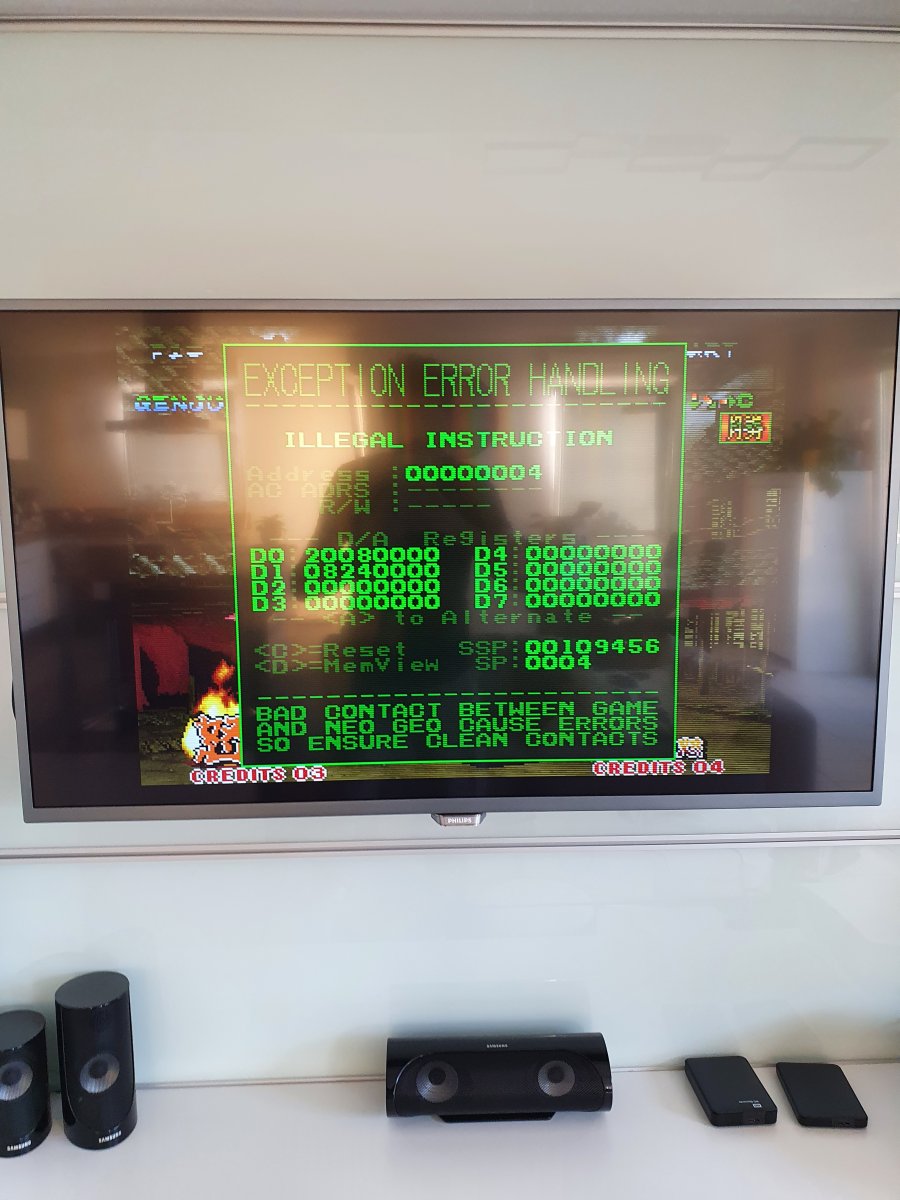

I tried out SamShow III, and experienced the reboot after two matches. Original bios and latest firmware/menu.
I tried samurai showdown III AES or MVS rom.
I have some random freeze too. I use the latest firmware and menu and MV-1FZ motherboard and unibios 3.3.
I roll back to previous firmware/Top/CPLD and no random freeze appears on samurai showdown 3. But still the same sounds issues on KOF 2003.
