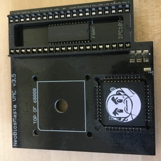

I found the culprit:
I should've pulled this out of the motherboard earlier, but the reset issue that I was getting with Burning Fight is from the NeoBiosMasta VMC.
Big thanks to all of you guys for the help with troubleshooting!
Great news! Glad to hear that it finally works for you. Enjoy!
