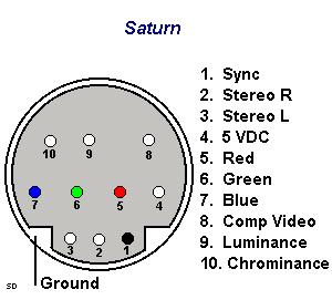

From what I understand, the Saturn outputs RGB naturally. Maybe something in the GBS is messing with the RGB signal? I might try building a cable that'll get RGB+G+S straight from the A/V port of the Saturn.
Here's the pinout of the Saturn A/V port.
I have my Saturn hooked up to my cab via a device called Sync Strike. Really, it just gets the RGB+G+S from the SCART and reroutes it through another output for easy hook-up. It works flawlessly for me, and I can even get the L/R audio signals from it through RCA cables too. You probably don't want another adapter device, but it'd be something to look into.

Saturn's have C-sync available in addition to C-video.
However most guides will instruct you to use/connect C-video...
Notice how this pinout guide says pin #8 is connected to SCART pin #20?
This is WRONG/BULLSHIT use pin #1!
If you are using C-video I HIGHLY suspect the GBS is not processing it correctly.
Switch over to C-sync and see if this corrects the issue.
You could also potentially use a sync stripper device like the LM1881 on the C-video before passing to GBS.
I don't know for a fact this will fix the darkness issue, but I feel its worth a shot/easy to try (and I fucking hate C-video, always use C-sync if given the option).
