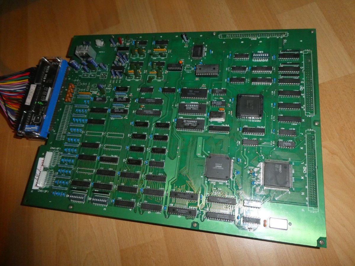

S system11 Enthusiast Joined Jul 15, 2021 Messages 103 Reaction score 154 Location UK Jan 17, 2022 #8 Got a photo of the top?
Uroko Sakanabito Grand Master Joined Jun 3, 2021 Messages 547 Reaction score 958 Location Germany Jan 17, 2022 #9 Sure, here you go Caps look fine /Edit Game did run fine for almost two hours now. Last edited: Jan 18, 2022
S system11 Enthusiast Joined Jul 15, 2021 Messages 103 Reaction score 154 Location UK Jan 18, 2022 #10 It's likely something on the top board. See that chip near a small orange tantalum capacitor near the nanao sound custom? Reseat that. Also check seating of the socketed quad, and look for cracked solder joins on the legs of IC42.
