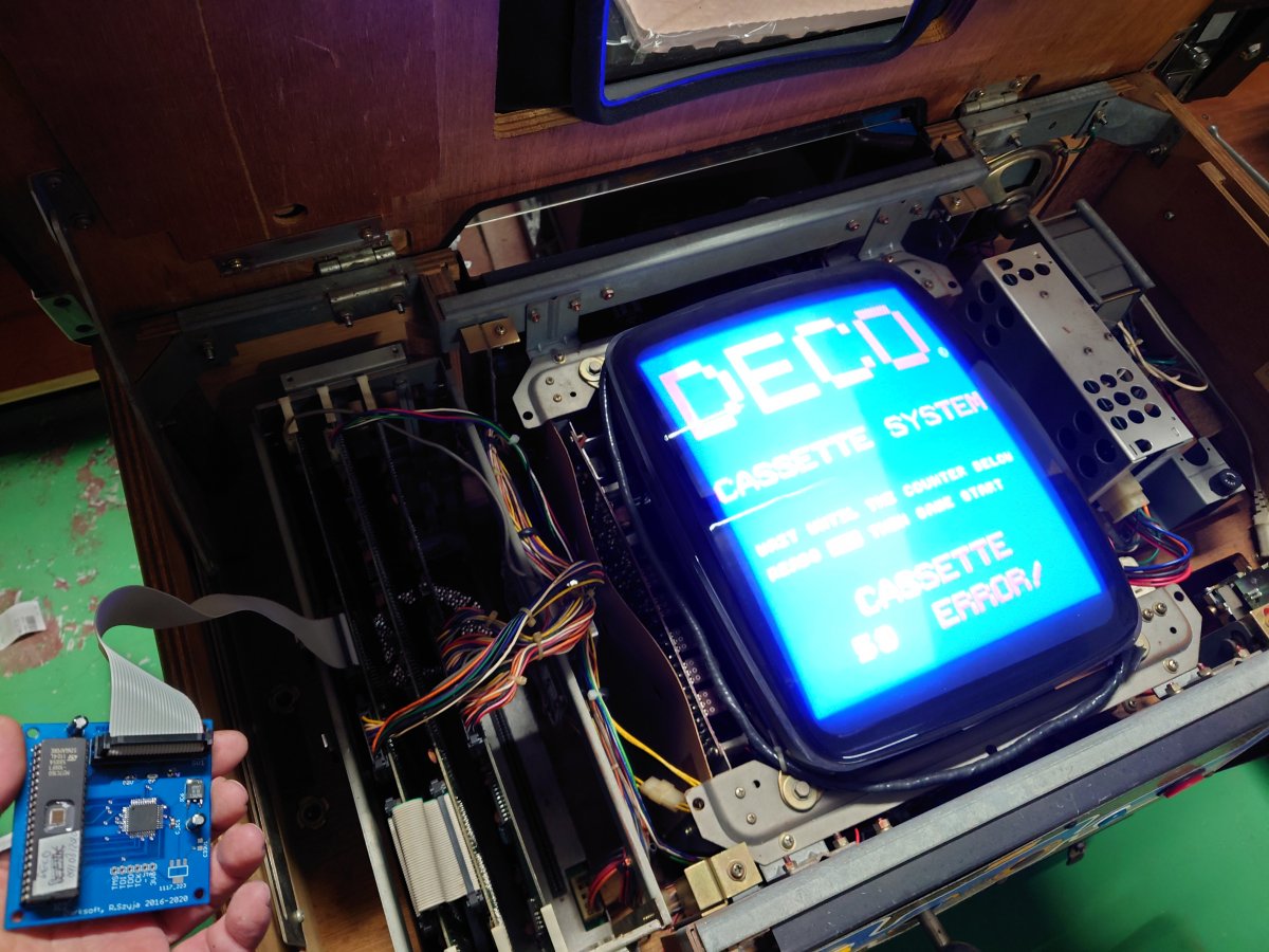

TMF68k
Dec 21, 2018
119
133
JAPAN

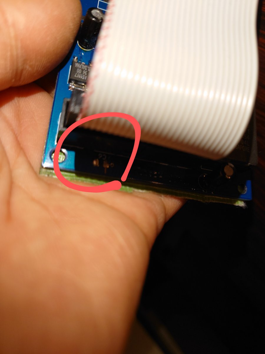

When I started after a long time, several titles did not work.I wonder why?
By the way, was there anything attached here?
Darksoft
Staff member
Immortal
Jun 12, 2015
10,439
14,619
Poland
Yes, there should be 2 capacitors installed. Please check that you have the following also installed:
C6: 1,5nF
C7: 33pF
TMF68k
Dec 21, 2018
119
133
JAPAN
I tried to revive this today, but unfortunately the PCB was broken.It needs to be repaired.
