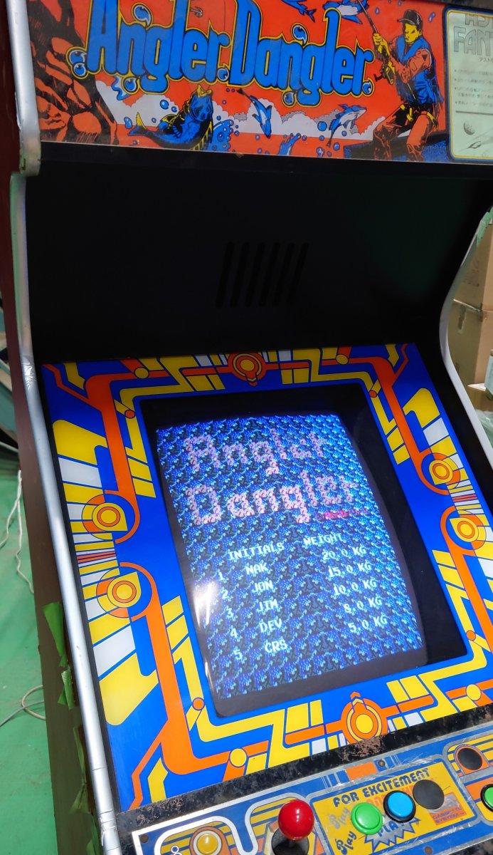

Motherboard failure and CRT failure.What was wrong?
The corrosion was so bad that I sent it to a contractor for repair.What parts on the motherboard?

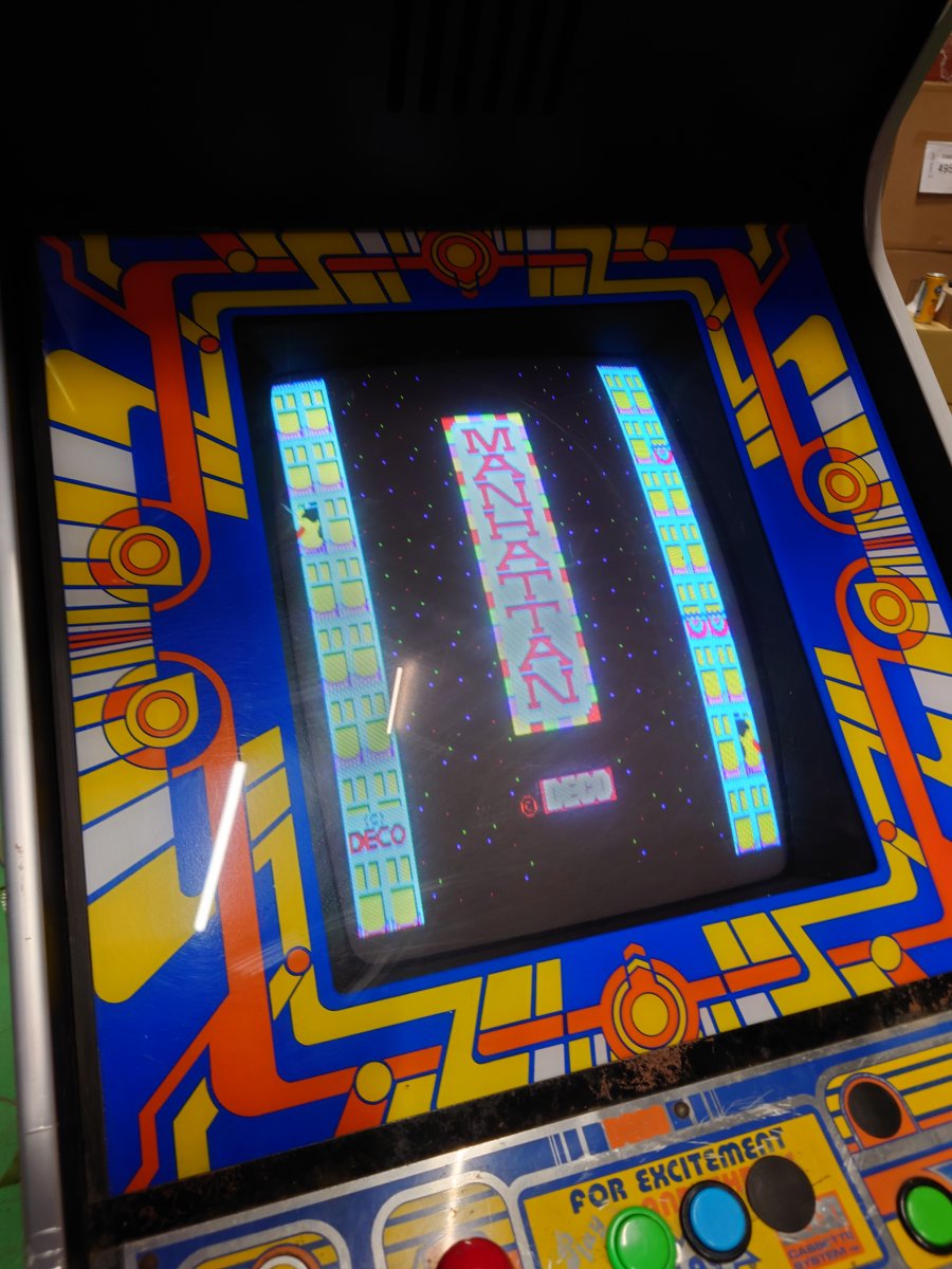

of the left (Designation 0) ROM goes to A11. The /OEs from both (0 and 1) original EPROMs get ANDed and the result goes to the 2732s /OE.Nice! Thanks for letting us know.Works on my machine. It's a PHAT that's so early, it actually has BLACK dip switches.
of the left" that means Pin eighteen, stupid auto-emojis.
