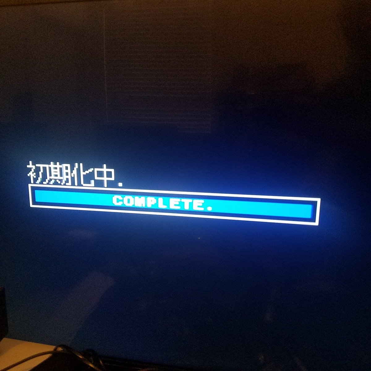

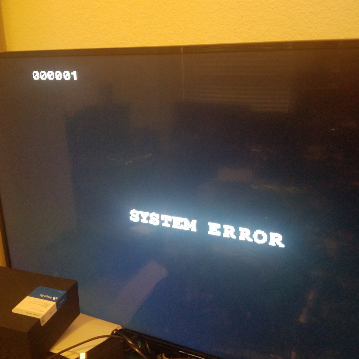

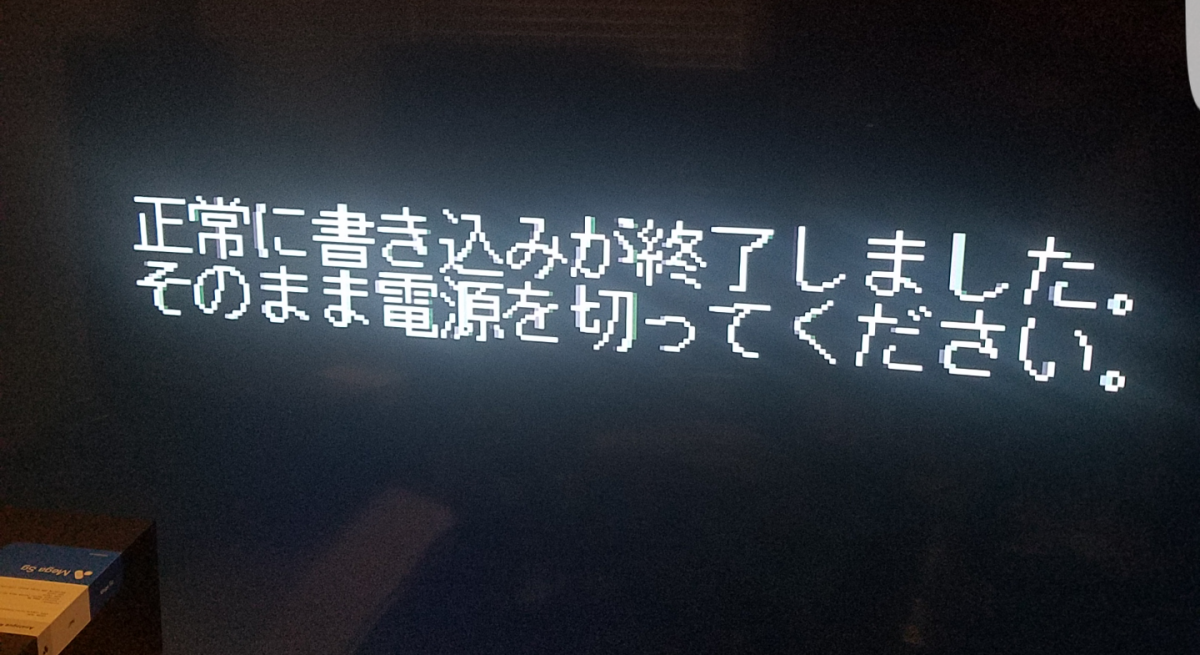

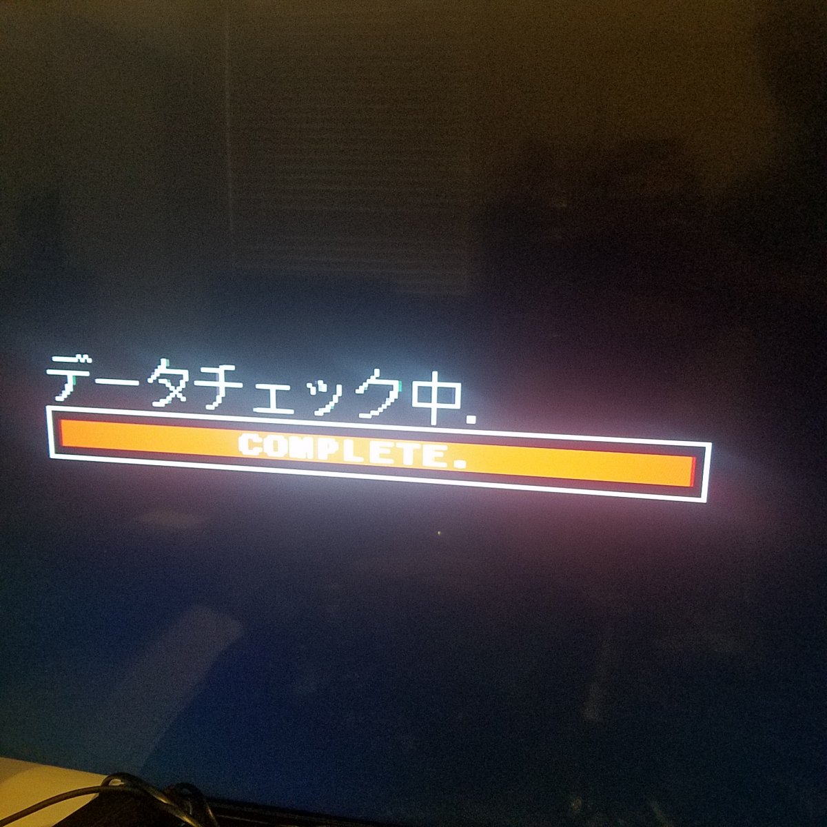

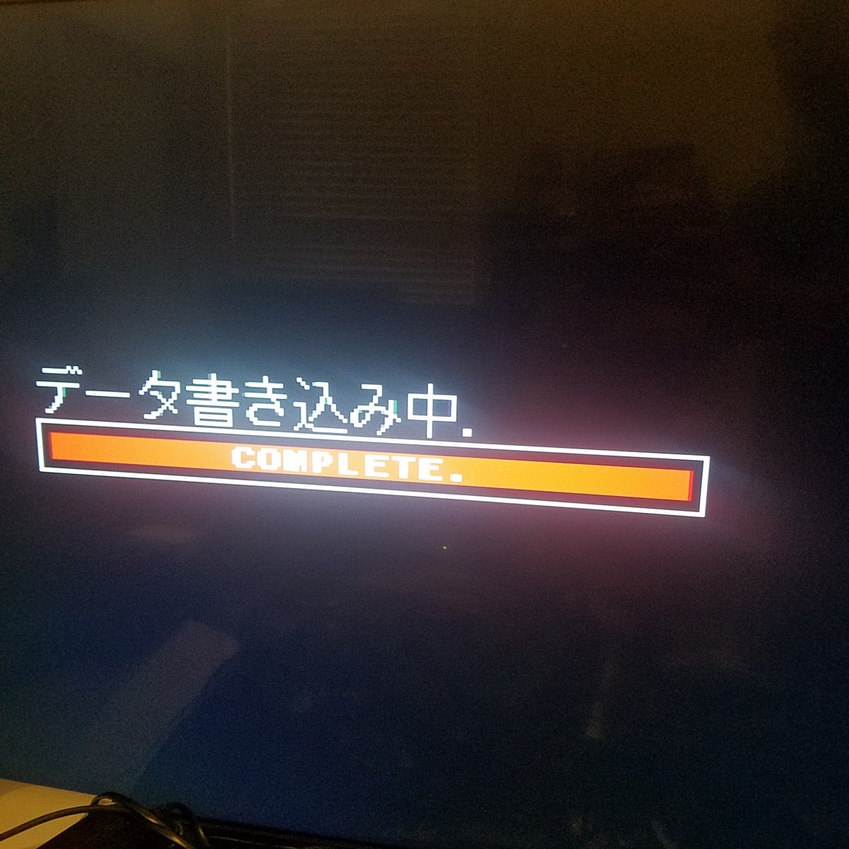

I've tried 3 sets of bios and they seem to flash but it doesn't display the custom splash screen with MB 2011. I don't know what else to do. Did I buy a dud? Am I missing something. This is infuriating. 20210710_130441.jpg20210710_130446.jpg20210710_130449.jpg20210710_131755.png20210710_130526.jpg20210710_130527.jpgcan someone help?

The 00001 error can occur when you’re using a CF card that the G-Net doesn’t like, or the game flashed incorrectly. That’s why it’s always good to have an original game on hand so that you can test the main functions of the board after flashing the Mod BIOS. You could have found this info by searching in threads on here. The system gave you an error code, after all.

Yes, I was aware of the error code and what it could mean. Doesn't explain the splash screen. I should still get a custom splash screen. I did scour the previous posts. I followed the advice and guides. An original game would be nice to test but I don't have one.any ideas?

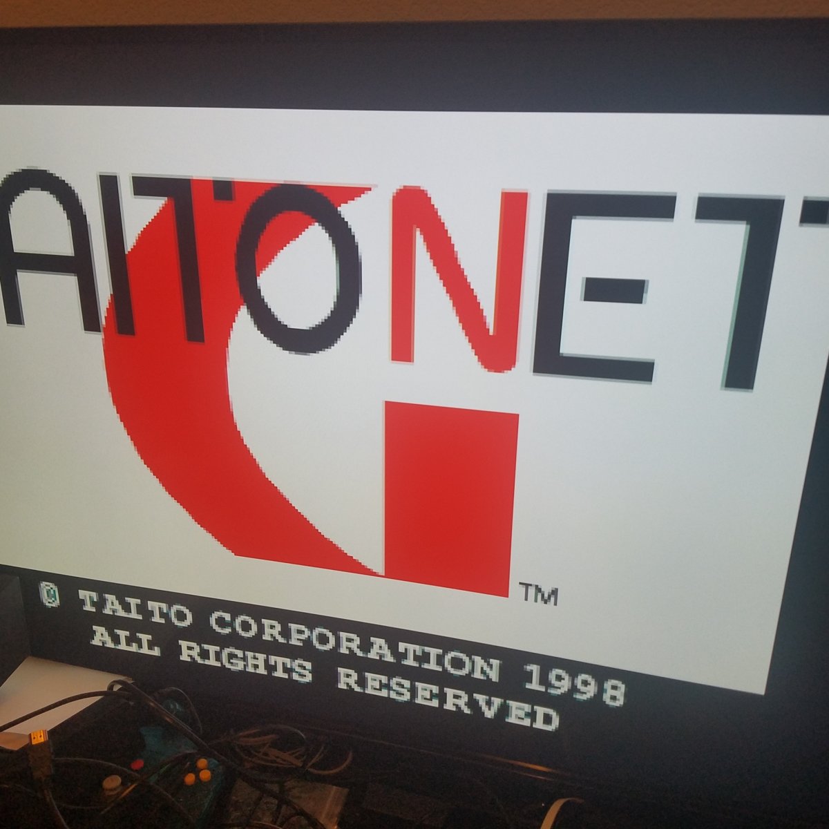

I just tested my flashed G-Net mobo with a known *incompatible* CF card, and it *does not* bring up the Mod Bios 2011 splash screen. It shows the original Taito 1998 splash screen. It’s your CF card. Get others.
