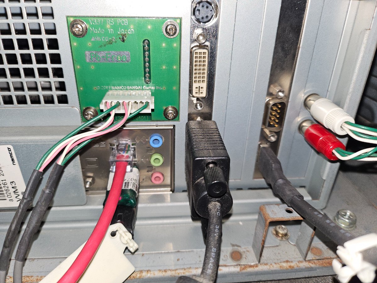

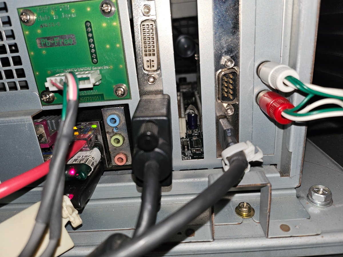

Not sure. Could be not plugged in properly or bad cable?

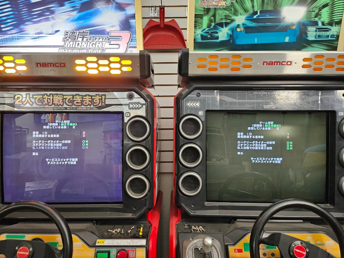

can you share a photo of your settings for each cab, the settings with PCB ID and Machine count.

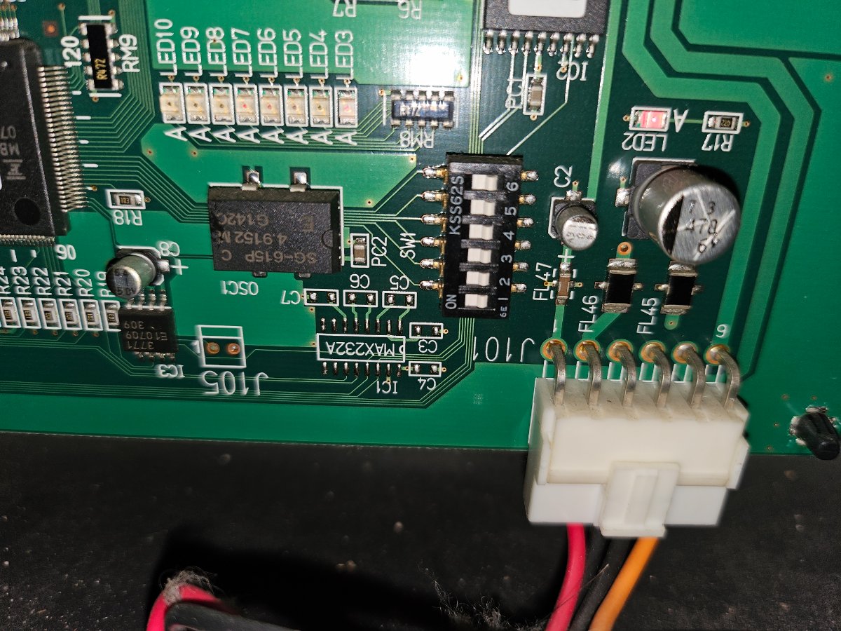

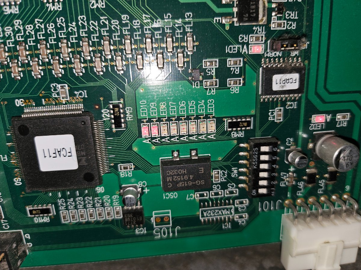

also your current dip switch settings on the physical I/O board.

The IPs are static, and the machines communicate with each other via multicast traffic. You need a hacked image to change the IPs which isn't public yet. (yes I'll get to finishing it eventually very busy atm)
IMO try a switch. Each PC should give you a link light when plugged into the switch. If one of them doesn't, then you know the PC that's having an issue.
